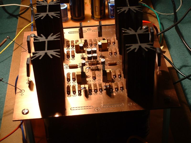

Damping factor is a little more complicated than just tallying up the Source resistors and dividing. The Source adds its own contribution and to get a good idea of that figure, you have to know the device type and how hard they're biased. An ideal device would have a Source impedance of 0 Ohms. If anyone has a box of ideal devices to spare, I'd appreciate it if you'd send them to me. Lacking ideal devices, the real ones have some impedance. I just pulled up the datasheet for the FQA19N20C. The Rdson is listed as .17 Ohms. On one hand, I'm not biasing the devices as hard as Fairchild is, so it'll be higher. On the other hand, their number could be a little optimistic. I probably overstated the case by saying that the Source resistors dominated the output impedance. They're probably more like a third to half. Nelson has told of some way to measure the Zout of an amp using another amp to drive it, but I don't remember the details and I don't have time to hunt it down at the moment.
The reason I don't get all twitterpated about the damping factor is that it's considerably overrated as a number. My old Conrad Johnson Premier One (a tube amp) had a fairly low damping factor, but it simply stomped most solid state amps in the low end. That plus the fact that damping factor is a diminishing returns sort of thing (Is a damping factor of 10000 really 100 times better than a damping factor of 100? I don't think so.) kinda puts it in the category of THD for me. Is it important? Yeah...up to a point...after which your time is better spent working on other problems. Like I said above--5% distortion in a subwoofer? Great time to employ feedback. That much distortion is a serious problem and feedback is the tool for the job. Damping factor of 1? Hmmm...not so good. Damping factor of, say, 20 or 50? Okay, let's take a look at something else and maybe we'll come back to the damping factor thing later if it seems like it needs more attention. If you match your devices well, you can use lower value Source resistors and get a lower Zout that way. Or you can parallel more devices. Or you can bias harder. Or you can add feedback. Or you can just sit back with some Highland Park 18 or a good Bordeaux and listen. I vote for the latter option.

Grey,
The notion that Rds_on has something to do with Zout is a misconception. Mr.Bob Cordell and others have written a few post on how the output impedance of a source/emitter follower is made up (pls read here and here)
Zout = (Rs + 1/gm_Nch) // (Rs + 1/gm_Pch) under class A conditions. When you enter class B one of the terms falls out of the equation (the one that belongs to the FET that goes into cutoff).
The 19N20 is quite like a IRFP240 and will have a gm of about 2..3S at the 1.3A you're running it at. This also is close to Bob's rule of thumb that the FET gm is roughly 1/10th of BJT gm at the same current (a BJT at 1.3A would weigh in at 50S). So your output stage might have about 0.1..0.2 Ohms (which seems to relate nicely to your DF=50@8R value). There is nothing wrong with that, I myself am not the high damping factor camp, of much greater concern is how constant it is (as any dynamic change of Zout IS plain distortion). So the trick is to find a bias current where the Zout is as constant as possible over the widest output current swing. See also the D2S discussion, where the goal is to have true constant gm at least in the most important low level region.
Measuring bulk output impedance is easy, drive the output of the amp (which has no signal applied) with another amp/channel via a bigger resistor, say 100Ohms or so, this practially is a current source with Iout=Vout/100. Measure the AC voltage at the DUT, say 10mV with 10V drive (=100mA), so Zout is 10mV/100mA=0.1Ohm. You can further drive the DUT amp with DC to have a standing output current underlying and can then get small signal Zout at varying output current and will probably find that Zout is lower at larger output currents, because gm increases greatly with current.
A counterchecking test is to drive to different loads and the obtain the Zout from the voltage and resistor ratios:
Say you have V1 with R1 and V2 with R2,
then set ratios v=V1:V2 and r=R1:R2,
and get
Rout = R1 * (1/v - 1) / (1 - r/v)
This one has less precision especially when the r/v ratio is close to unity. You must load the amp quite differently but not to lightly to get stable results.

KSTR said:Grey,
...So your output stage might have about 0.1..0.2 Ohms (which seems to relate nicely to your DF=50@8R value).
One of the things that's particularly murky about building your own class A amp is how big a power transformer to buy. Folks who are new to DIY get panicky when they hit this particular question and I'm completely sympathetic. I was a little perplexed when I first faced the question, myself.
Once upon a time, a new member asked how big a transformer to buy for an Aleph 2 (100W/ch class A monoblock). I replied, "Oh, that's easy. For Alephs, you just buy a transformer that's rated for six times the output wattage of the amp. For an Aleph 2, that would be 600VA." Whereupon, someone indignantly posted that I was wrong--the actual answer was...and he proceeded to burn incense, draw pentagrams on the floor, and pray to the audio gods to hear his humble plea for an answer...he then performed nine hundred and ninety-nine intricate calculations, followed by the sacrifice of a newborn lamb under a crescent moon. Then with great satisfaction, he pronounced the answer to be...(no, not 42)...579.
Ahem.
I submit that for all practical purposes 579=600, particularly in a world where transformer manufacturers tend to offer transformers in multiples of 50 or 100VA.
You've gone to a lot of trouble to come up with pretty much the same number you'd have gotten if you simply added the Rdson to the value of the Source resistors, then divided by the number of devices. I dunno about you, but for a simple-minded Southern boy, my way seems easier. I've got limited time, and anything that quickly gives me a reasonable answer is the method of choice. If I've only got an hour a week (a fairly reasonable average), spending it calculating isn't anywhere near as productive as spending it soldering. I want something I can listen to--not a piece of paper with three dozen scrawled calculations. My hearing is pretty good, but not good enough that I can hold a sheet of paper to my ear and hear music. Not even if it's a musical score. Maybe I should just turn up the volume...
Granted, the difference between .1 and .2 Ohms at the output is a factor of two and it might, arguably, make a difference whether the damping factor is 30 or 60 to some people. By now fifty people have probably simulated this circuit and if you ask any ten of them, you'll get twelve answers. If it's going to turn into a bother, I'll try to measure it directly at some point so we'll know, but it'll probably have to wait until next weekend at the earliest.
Bear in mind that we'll have to set some boundaries on the problem because I use different Source resistors depending on which bias circuit I'm using. For instance, the auto-bias circuit sets Vbe across the Source resistors and tends to require something along the lines of .5 Ohms. Obviously this is going to change things. I've also got some intermediate value parts--right now the amps have .33 Ohms in them, for instance, that I use when I'm changing things around and might smoke something. I regard those .33 Ohm resistors as sacrificial. If they go poof! I won't be bothered because they didn't cost me anything.
Don't thank me, thank John. It's his topology. I'm just borrowing it.
Grey

GRollins said:For instance, the auto-bias circuit sets Vbe across the Source resistors and tends to require something along the lines of .5 Ohms.
I don't recall seeing this in your schematic.
GRollins said:can't easily get here in the US
Half true, <50 nations in less square miles than 50 states leaves more residue.
For an example of the second half, type in Centerpoint Electr. in Cyprus Californi-ey for the 2SK. (CPCares)
(pretty boards, appealing soldering fingerprints)
Nelson,
No, the auto-bias is a separate bias circuit, similar to the one you and I were discussing at some point last fall; a fairly straight-forward variation of John's double Vbe multiplier. The one in the schematic is the one that's on the amps now and also in the picture of the whole amp--it's the small circuit board to the right, between the heatsinks and the main circuitry. I try to make things as modular as possible so I can swap in parts--such as bias circuits--that happen to be of interest to me at the moment. Bias is one such thing.
I'm very interested in automating the bias for the circuit. I've got that one auto-bias circuit up and running and two or three more ideas that I want to try as time permits. I know you've got several bias circuits that you've been thinking about, so to that extent our interests coincide at the moment.
Curiously, the overload behavior of the auto-bias circuit is worse than the bias circuit in the schematic. I haven't had time to sit down and think that one through. It'll be something simple.
Grey
