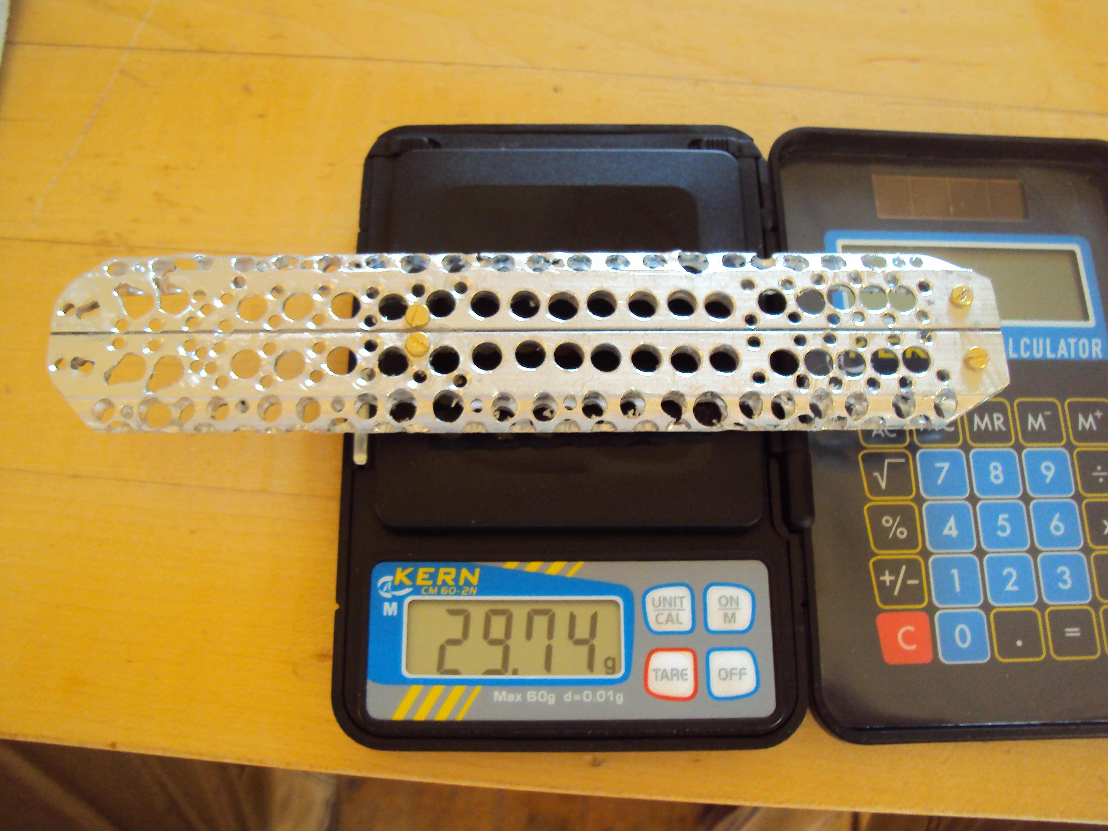

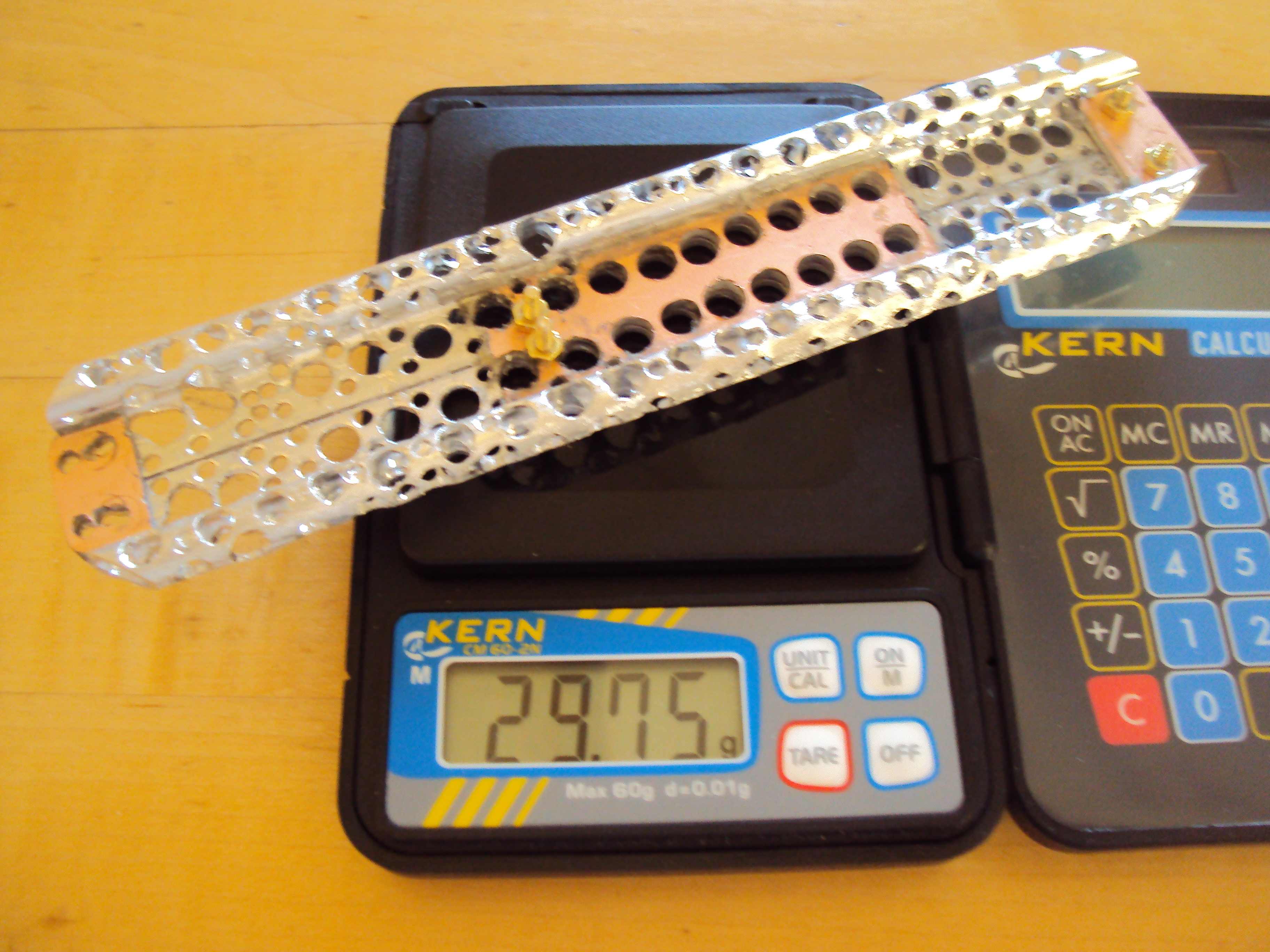

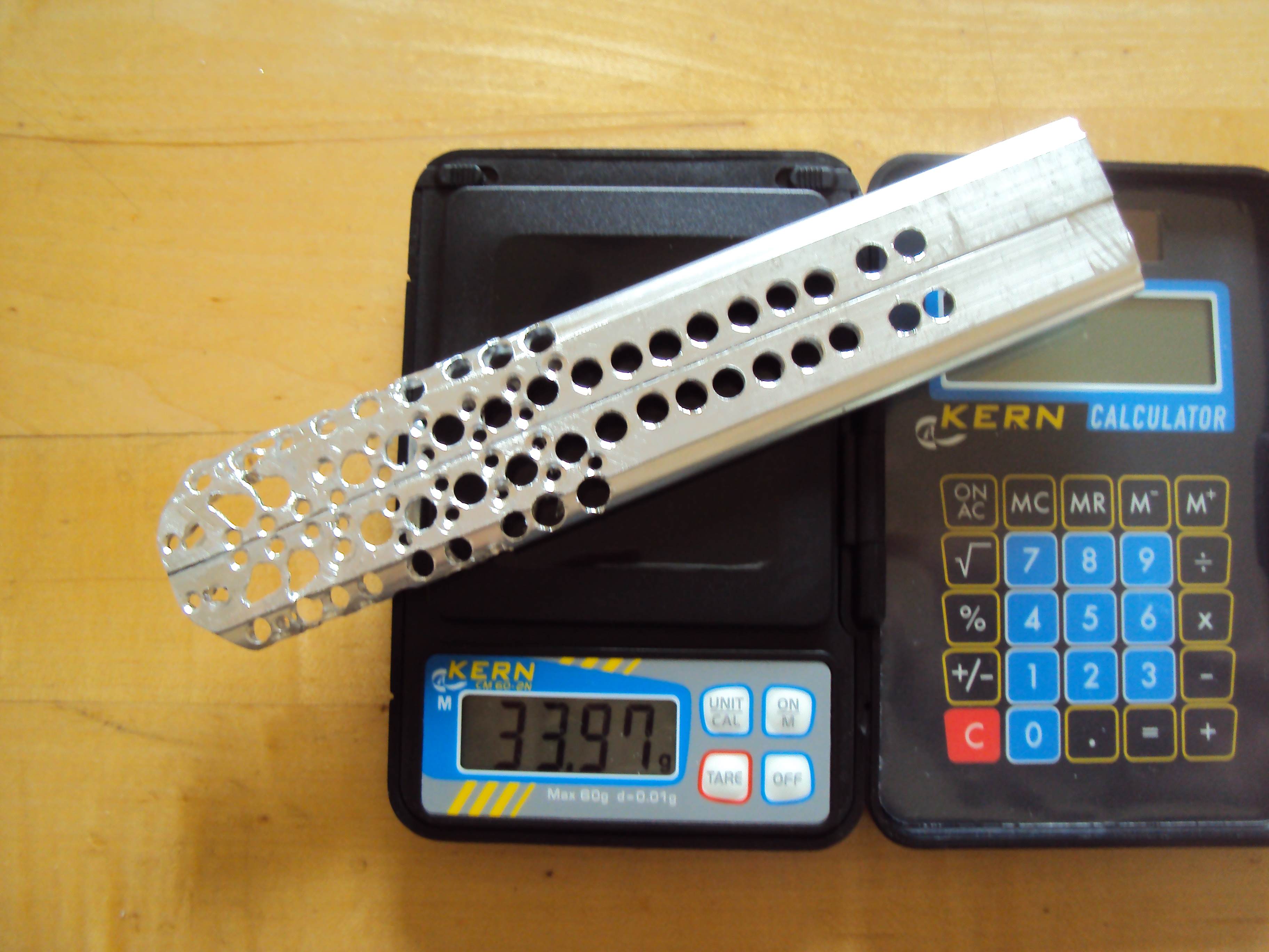

Now it is 34 gr without the screws.
jackinnj,
I'll be interested to see your results of the test of the two different shapes. Intuitively the rectangle should be stiffer, but this is different than a vibration test. I would think that a triangular shape could have the best shape between these two other profiles. Can we assume that these are straight section composites? After you do your testing it would be interesting to see how different the vibration properties would change with a very low density foam material fill in the same shape. I am thinking of a 2lb density urethane foam expanded into the shape. Just some thoughts.
Steven

jackinnj,
Steven
Well, I have to speak with one of my physics/optics guys -- he has one of those vibration proof/auto leveling tables they use in laser physics -- and i can get some help with the equations. I am thinking that any play in the horizontal hinge mechanism will undo any benefit of a stiff arm.
Instead of accelerometers, can probably just use optics.
jackinnj,
I would think a laser interferometer would show you what you want to see. As far as any loose fit in the gymbal bearing that should be at least partially taken out by gravity and the weight of the assembly keeping it sitting in the bottom of the clearance. I just don't see that assembly bouncing up off the pivot point, doesn't seem like you would have the movement to do that at that position.
