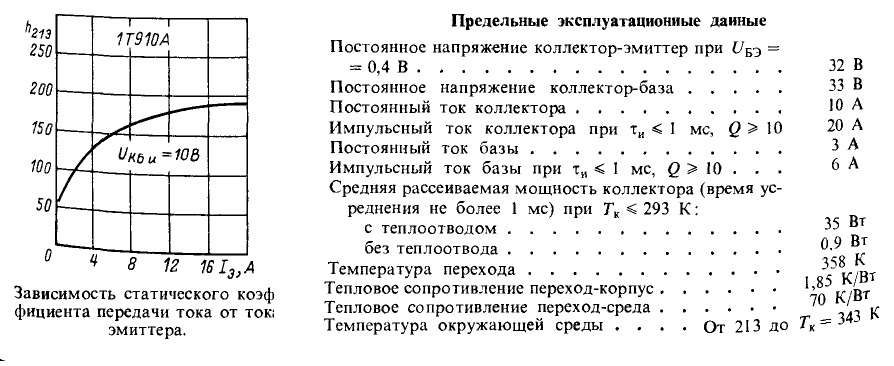

The reason for great curiosity in germanium is the growth of the transmission coefficient with increasing current.
In the working positions of the current, of all cascades.
FWIW: ALL transistors do this, for some range of current.
The hFE gets to a maximum at some current.
At lower current, hFE drops due to recombination, leakage, and other mechanisms.
At higher current, hFE falls because the semiconductor crystal gets "crowded" (high-level injection).
"Where" this happens, relative to "normal working" currents, varies between different devices. Some semi-old devices like original 2N3055 were rated to 15A but hFE was falling fast above 4A, and also below 0.1A. Modern "2N3055" have flatter hFE curves. Germanium were all different.
...Germanium were all different.

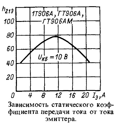

It is so. They were different.
For example, germanium, high frequency GT906AM.
h21e increases to 12 A.
In general, germanium is much less greedy for current. Much closer to the conductors. Unlike silicon "stones".
Also, they are the easiest to open. By voltage. From all devices.

Although is rare to find a BJT with only rising beta well into the "complete die destruction", at least very above the Pc(max) like these 1T910 (rise to "infinity").FWIW: ALL transistors do this, for some range of current.
And good to see a 30MHz fT Ge power device 🙂 fun to play with.
By the way I suppose that it have heavy B-E junction doping and this kills the hFE in low current regime (for a hFE meter standpoint), more or less like SHF devices. Low impedance drive overcomes part of this (the leakage part). In fact I've tested them. Normally the hFE curves upward at low current with normal alloy Ge due to B-C leakage being dominant, until it finally starts to drop.
Soon I will use these 1T910 for making a series of 3 amplifiers experiences: one like the "el-cheapo" with SE input and SE "VAS", both cascoded, with a quasi-complementar output stage***, a open-loop trafo coupled amplifier à la Susan Parker, and a third like the first published in this thread. Experience is everything.
***I've made a lot of these amps and become curious to try with those devices.
Speaking about these plastic cased Ge (I've never seen before power Ge with partial plastic case), I liked very much the 1T905. Very high Early voltage for a Ge device, and the collector curves don't start to prematurely bends vertically after some power level like most Ge devices (this Ge behaviour I suppose to be related to its very low bandgap). Good for higher voltage Ge projects.

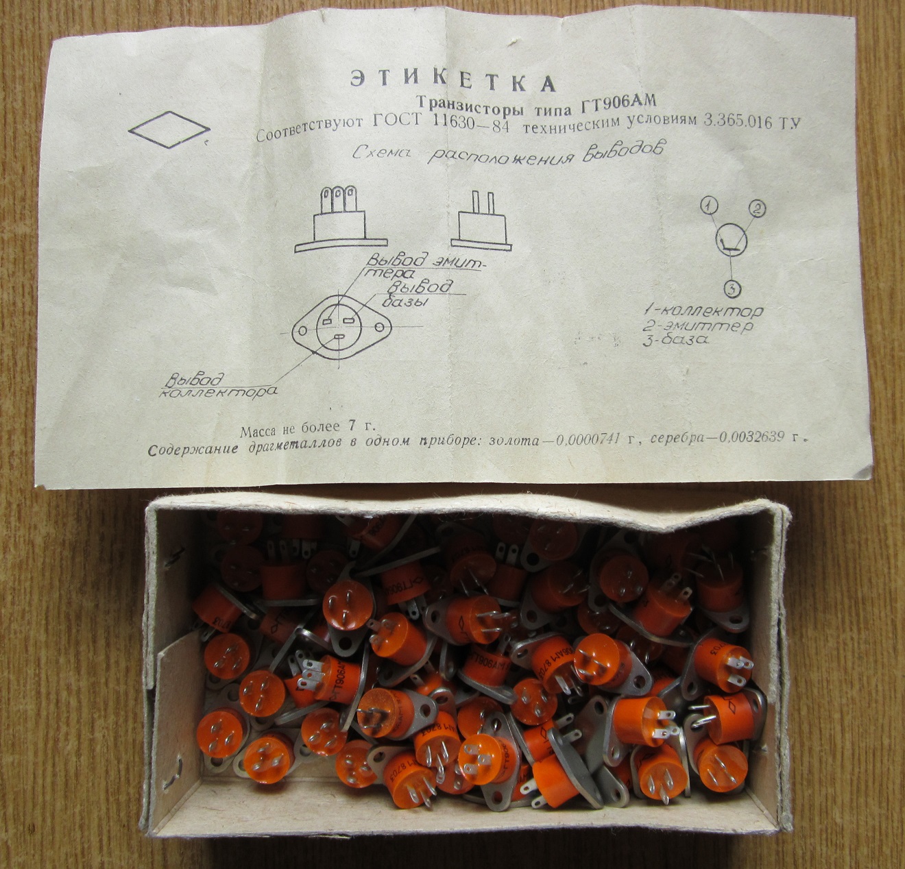

You can find germanium transistors in the post-Soviet space.
Ask in Svjatoslav.😉

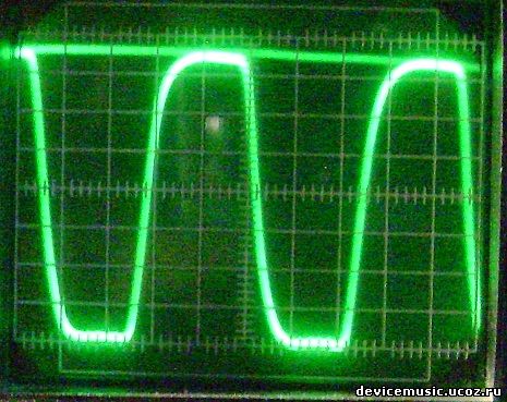

At ГТ320В (VT1,VT3) ГТ321Е (VT12,VT13), ГТ311И (VT5,VT7), 1Т321 (VT8,VT9), ГТ806 (VT10,VT11) Cirklotron D3, the bandwidth of -3 dB reached 1 MHz.
Meander of this variant, the frequency is 400 kHz.
