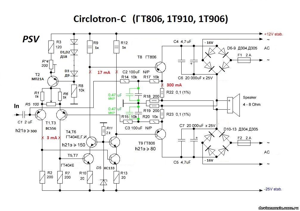

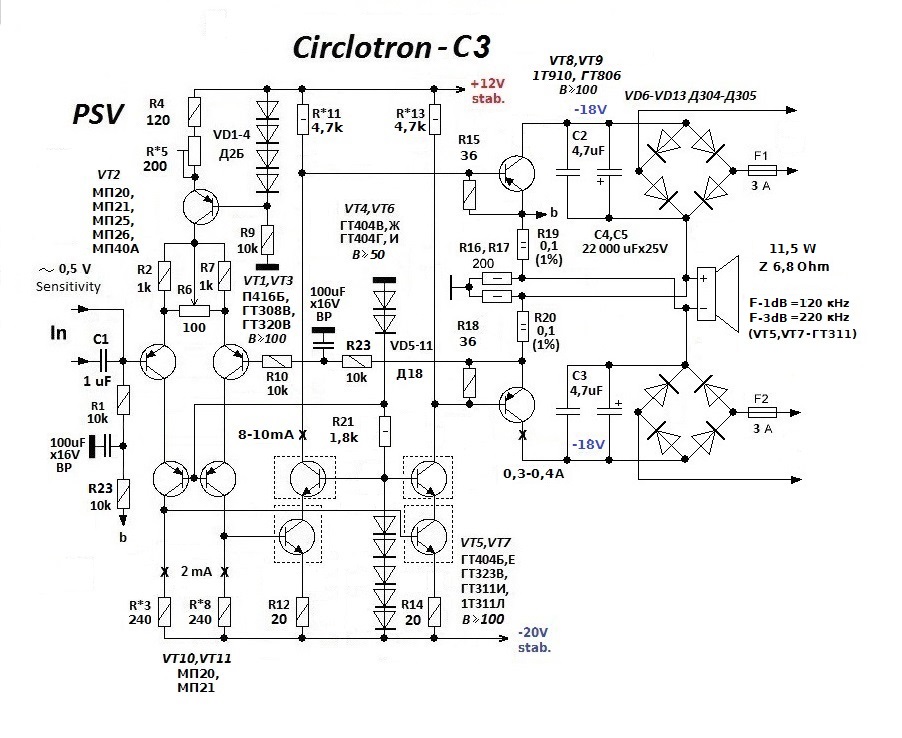

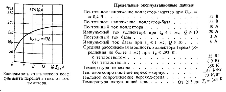

The GT905 is better on the first of Darlington's "two" output.
In the end of "two" - GT906, 1T906, 1T910AD
1?910??, ??????????? ??????????, ??????, ????, ??????????????, ?????????, ???????, ??????????, ???????, ?????????, ?????

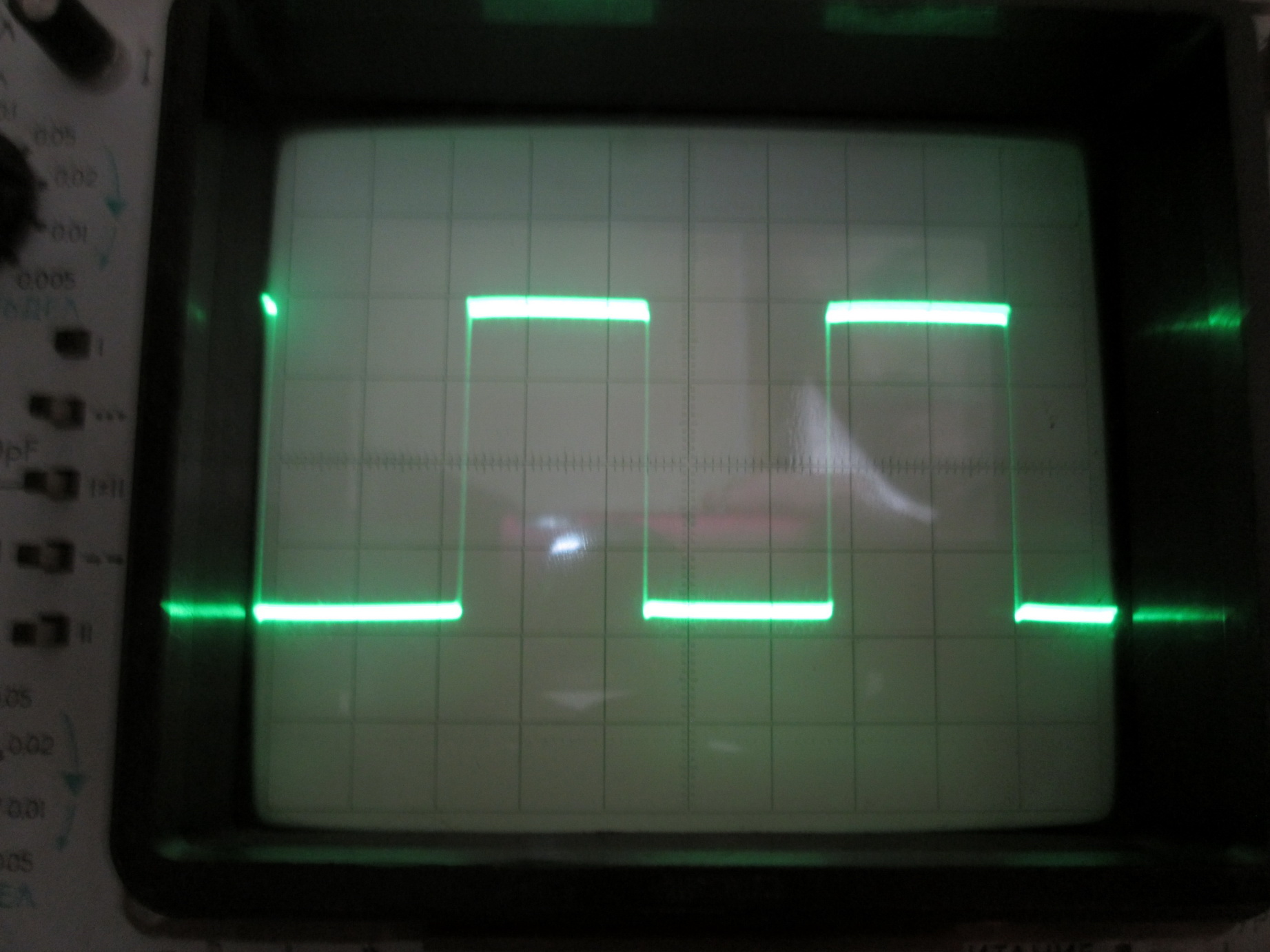

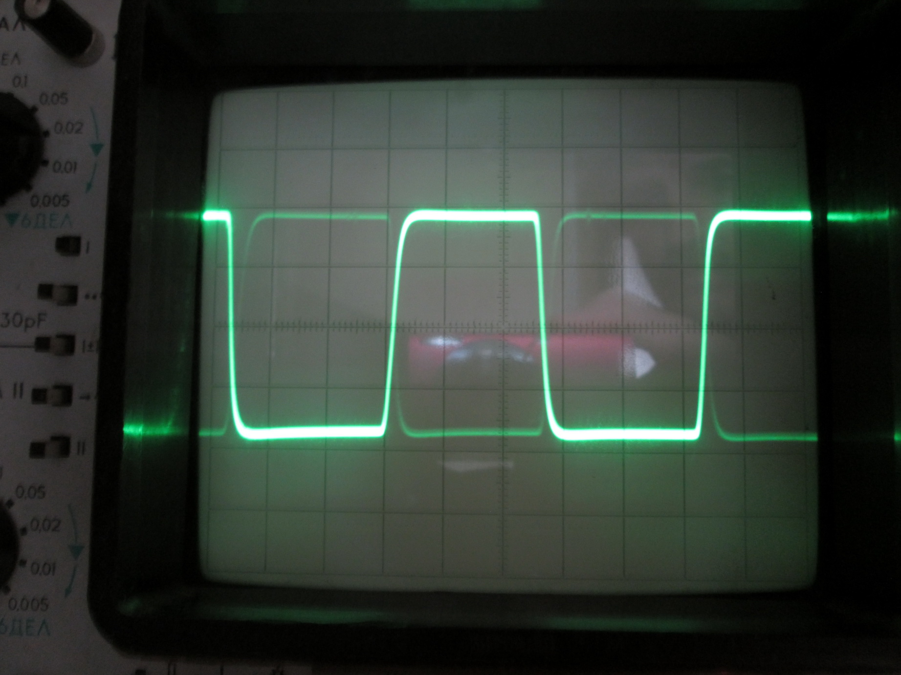

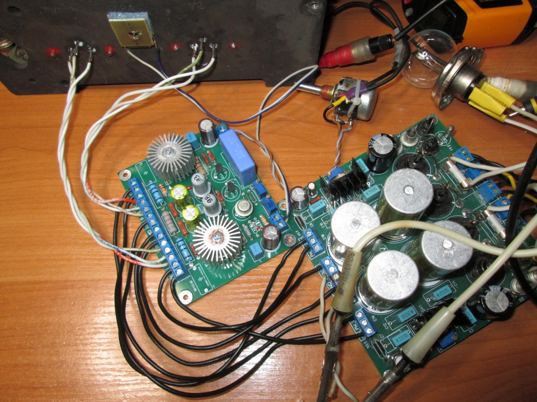

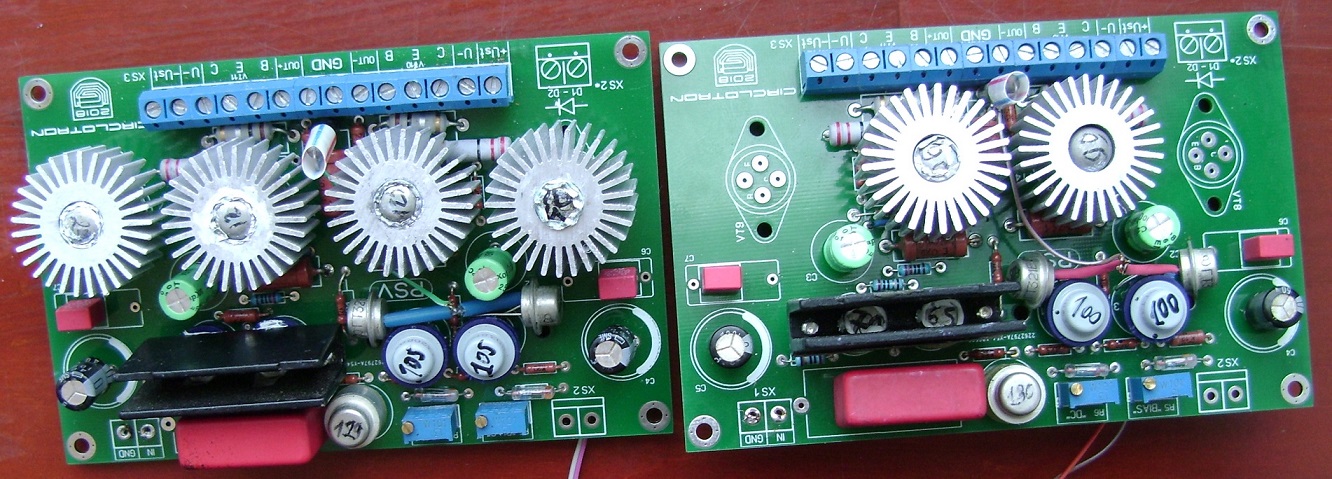

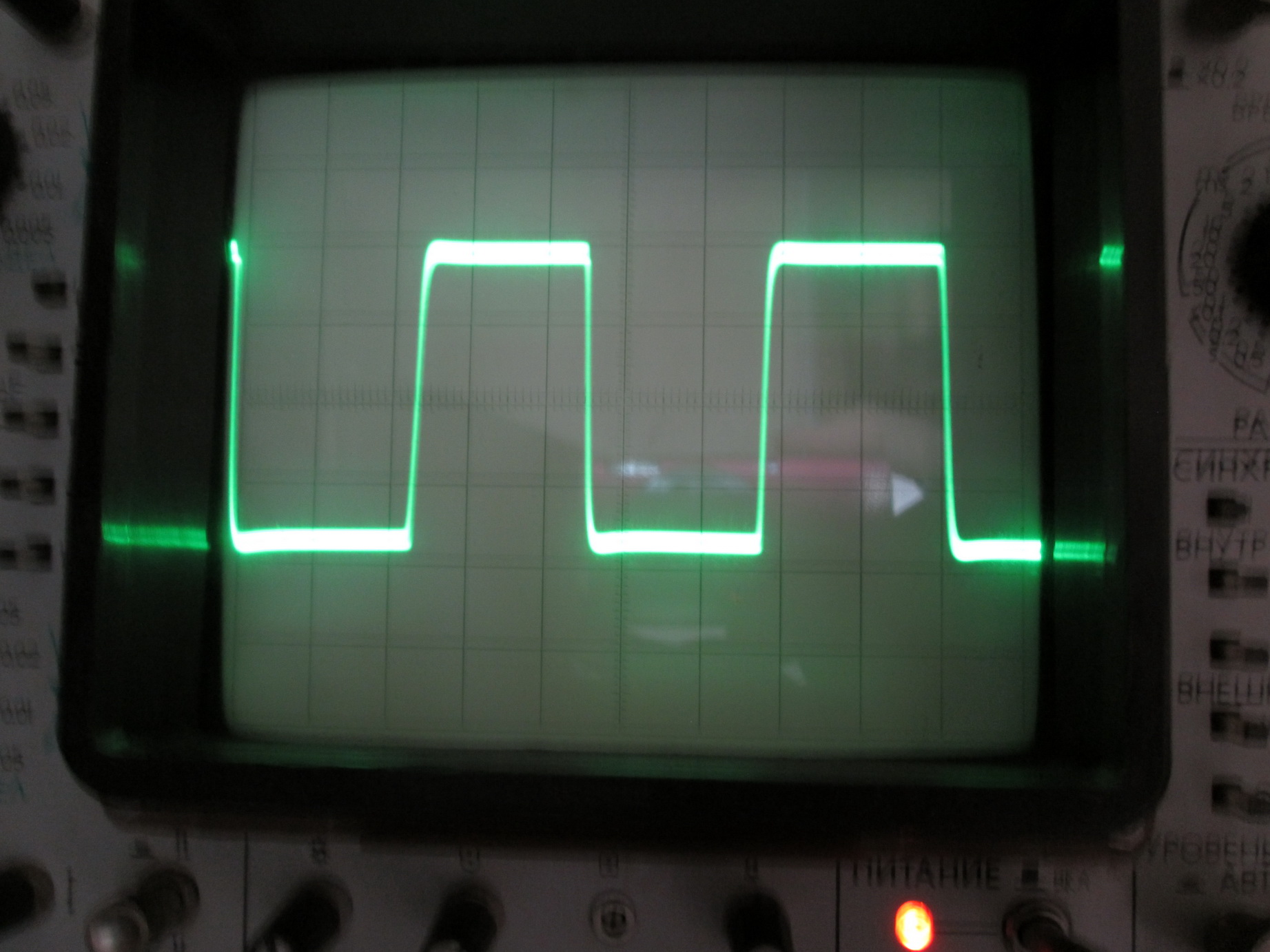

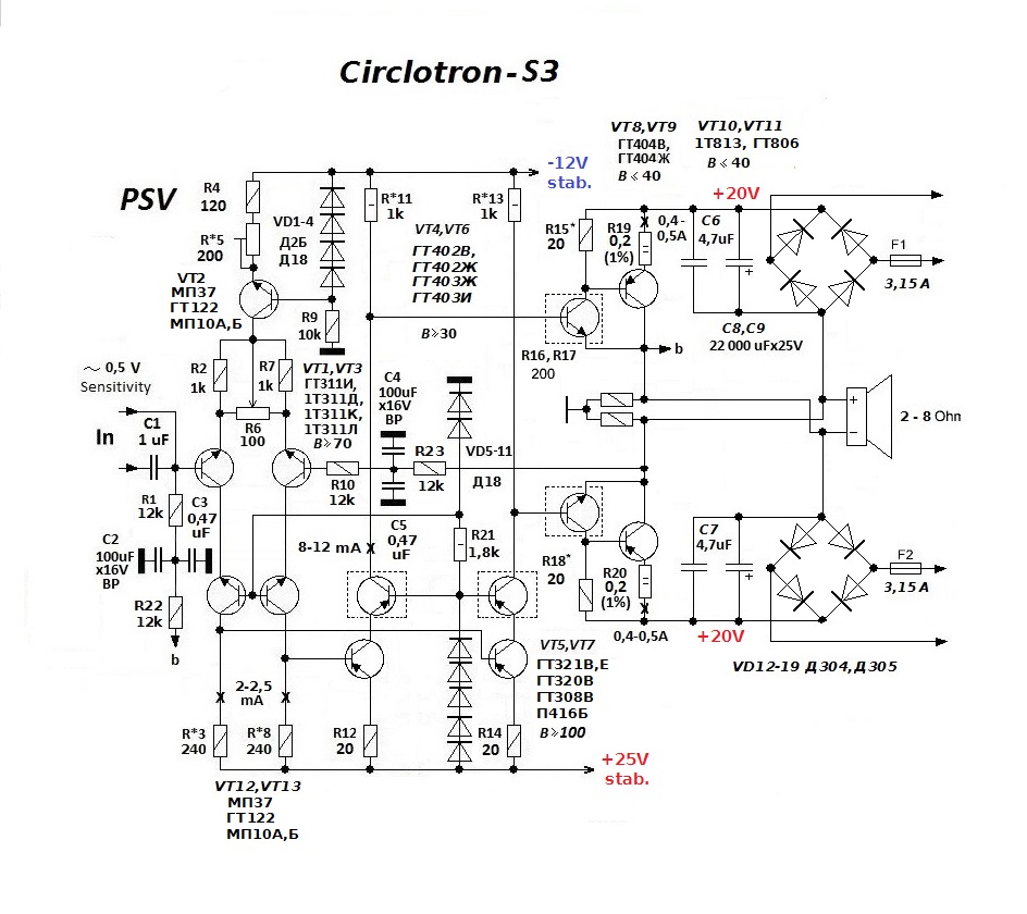

- The Germanium-only circlotrons. Powerful, wideband.
