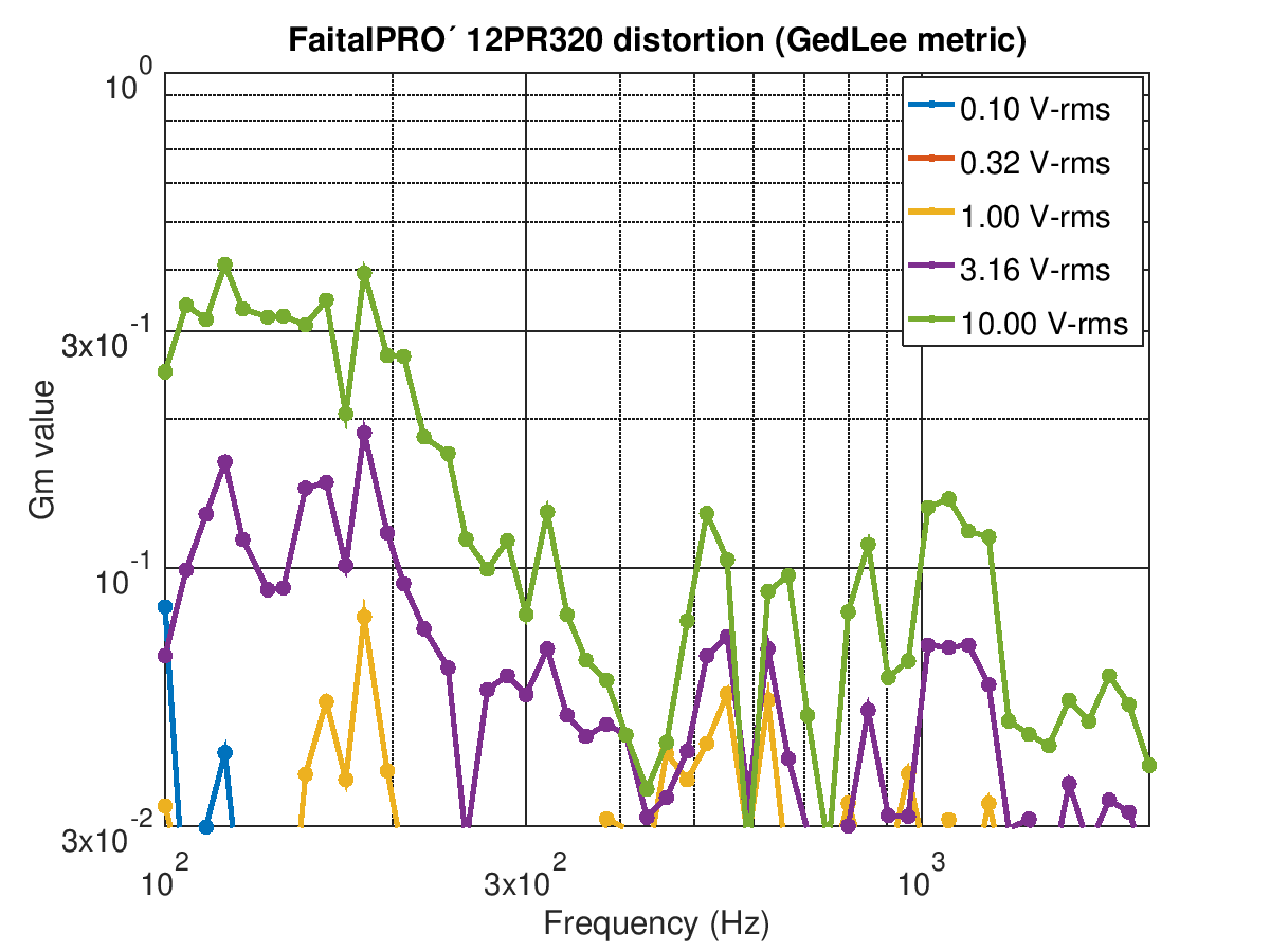

You are all over my meaning, “visual patterns”.
Hope that you don’t mind that I post one of your visuals here. Your FaitalPro visual looks to have a pattern of peaks and valleys that may even be brand and model specific. I am thinking that type of data would look really impressive in a waterfall type graphic spilling down the diminishing input voltages.
Thanks DT

MATLAB. I can code stuff up. I'm not the best developer... but I make do.
Then take a look at MATAA. It's basically an audio test system for GNU Octave (or Matlab).
MATAA has a function to measure GedLee metric, see here: mataa/mataa_measure_GedLee.m at master * mbrennwa/mataa * GitHub
Much of the code is concerned with plotting the intermediate steps of the GedLee stuff, but you might be able to extract the stuff that is interesting for your needs.
Here is an example of how I used MATAA to measure the GedLee metric for two different woofers.
