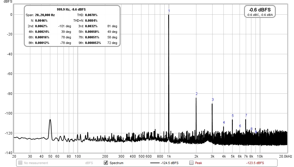

REW will show the phases of distortion components in its RTA distortion panel, there is an option for that in the RTA graph controls. On the earlier post about multi-valued output, that's the normal case for any system displaying hysteresis. Quite common behaviour in mechanical systems, not so sure what the equivalent behaviour in an electronic system would be.

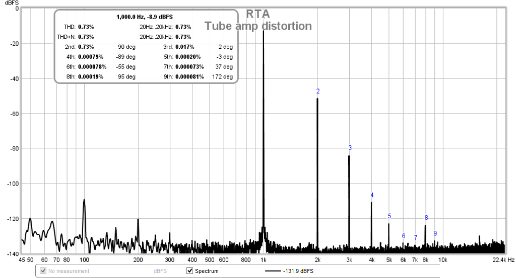

Yes, REW can do it. Attached is a measurement of a tube link stage that has no global feedback and most surely no hysteresis. Distortion components are close to 90° multiples if they are high enough (level). For small distortion components, phase reading starts to be random and differs from 90° multiples.

There are occasions when the harmonics are far from quadrature though, here is a loopback measurement of an old Edirol UA-1A card as an example. The harmonic phases change at different stimulus levels.
Edit: one might speculate that is a result of more than one harmonic contribution at a given harmonic frequency with differing (but quadrature) phases and unequal amplitudes.

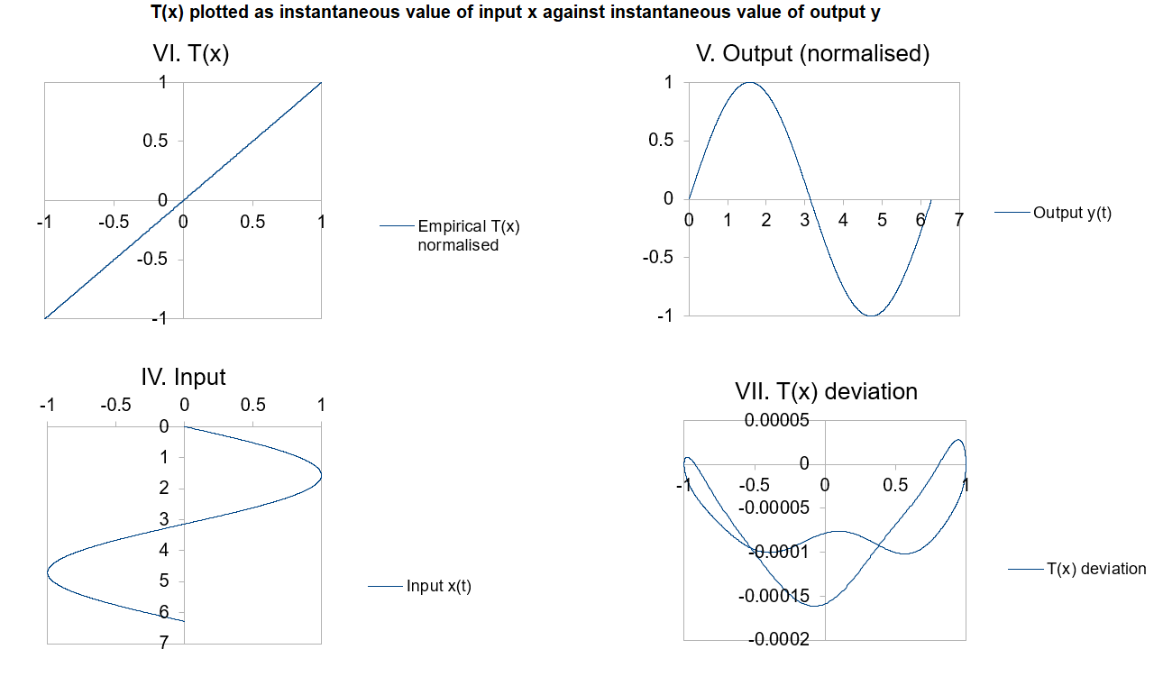

I plotted T(x) for your results. At these levels of distortion, to the eye, T(x) appears to show no nonlinearity. However, the plot of T(x) deviation (from the ideal case) shows two lines, and hence an element of dynamic nonlinearity.

I'd guess it may be a result of the combined nonlinearities of the output stage and input stage, since it is a loopback measurement.

This is possible as is a contribution from the noise. The noise may have a small effect on the harmonics amplitude, but a much larger effect on its calculated phase.
So we do have a few real-world examples where the phase angles of the harmonics are not in quadrature to the fundamental (either because that's how the DUT works, or because of measurement noise, or whatever). This means the transfer function reconstructed by summing the Fourier components can indeed be multi valued for a given input. How is the GedLee metric defined in this case? Which "branch" of the transfer function should be used for the calculation?
