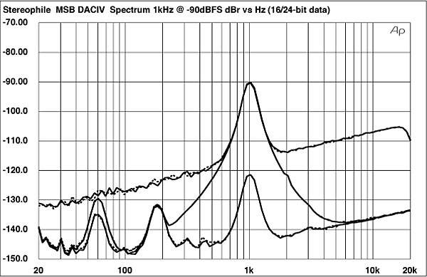

Valid point. To clarify, I'm thinking of something like this (top curve is dithered 16 bit data for -90dBFS sine wave). If you integrate the noise floor, you get the S/N, which is probably what you're reading on your meter.
(from http://www.stereophile.com/content/...p-diamond-dac-iv-amp-da-converter-measurement)

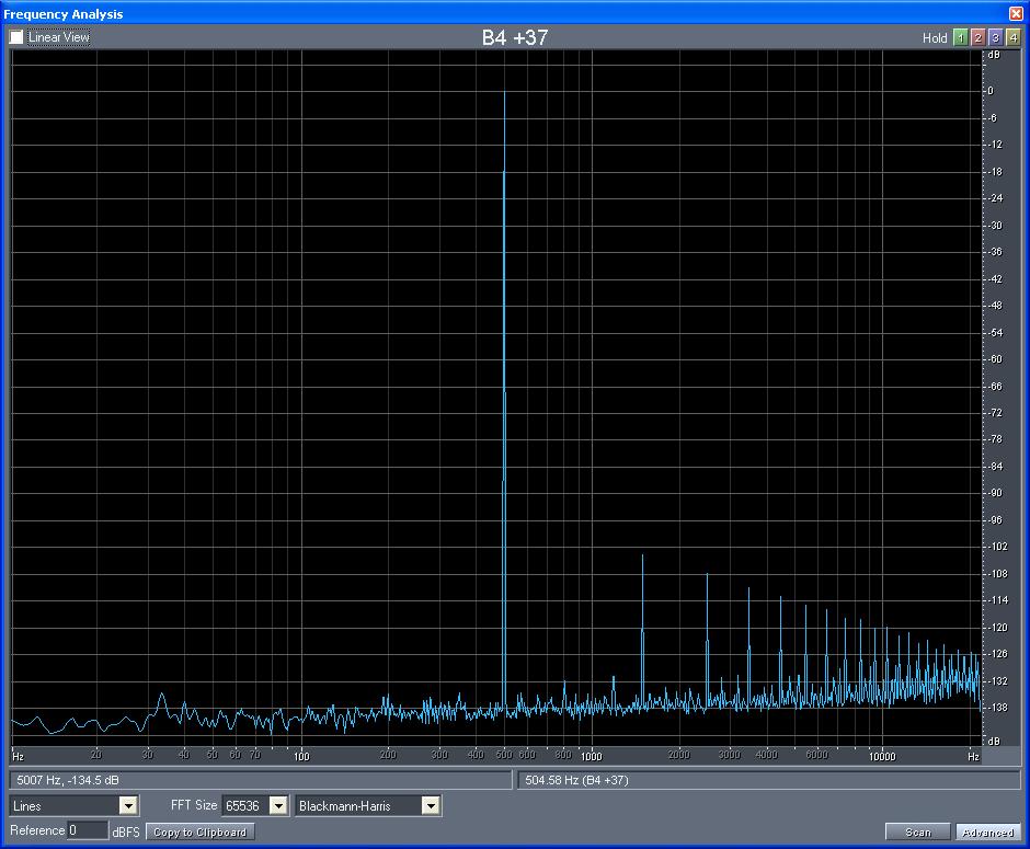

I have pictures too. Example unditherd 504.644Hz 44.1/16 full scale sinewave. The odd frequency is because the tool does not have arbitrary N FFT's. To show the result of 44100Hz sampling and 65536 point FFT's without artifacts the frequencies should be multiples of the ratio 44100/65536.
Brickwall at 600Hz leaves perfect sinewave.

Sorry but you can easily do the exercise yourself with Audition/Cooledit. Take an undithered 500hz quantized sine wave with all the little steps like you see in the text book and brickwall it and you are left with a near perfect 500Hz sine wave. See for instance the AES white paper from Channel D on digitizing LP's.
As an additional comment with respect to LP's I would think the sample to sample uncertainty would determine the degree of self dither. That is the distribution of the total noise amplitude in the process sampled at say 1/fs time points. This is not a trivial problem but like all these types of problems the answer is somewhere in Rice's Bell Labs treatise on the statistics of noise. I know the answer is there for white noise bandlimited between two frequencies.
Well, at the 16 bit resolution I was speaking of, I doubt one could see 'all the little steps' when viewing the entire waveform, either before or after. But I've seen the effects of such post filtering on general smoothing & noise removal with a variety of signals with step function noise.
