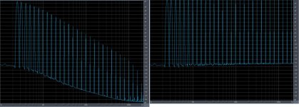

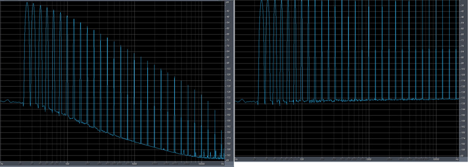

I had this multitone file from an old experiment so I was curious about what artifacts I would get running it through a very simple 40Hz two pole IIR filter. The source file (right) is 1/3 octave spaced sinewaves at frequencies chosen so that they fall exactly on an FFT bin at 44100 sampling and 65536 length FFT’s at the same time to maximize resolution of the noise floor. This was intended to go on a CD so it is 44100/16bit dithered with 1 lsb of Gaussian noise. The file runs 20sec so my thought was doing a running FFT average would give a pretty flat noise floor. The output (left) is the same spectra after a simple 40Hz two pole biquad IIR filter at 64bit floating point precision without dithering. It is clear that the numerical artifacts even though the simple 5 coefficient filter ripples results recursively through almost 500K data points are so far below the re-dithering threshold that they do not matter. With modern hardware there is no reason to use DSP’s with short data words or fixed point math for audio and have to worry about rounding and truncation errors propagating through the data stream .
As a curiosity the small artifacts in the left plot at the high frequencies are related to subharmonics of 44100KHz modulated by 10Hz in some unusual relationship and not the input data. Note Audition does not have a rectangular window so the tones have “shape”, in a tool that does the tones are exactly spikes but none I have makes pretty plots.
I hope to take some 24/96 files recorded off of an LP and look at the digital equalization. My feeling is that there are so many lsb's of self dither that there is virtually no difference digital/analog.

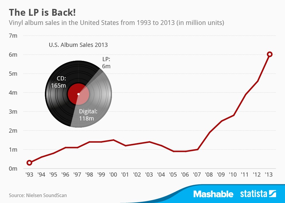

The future of analogue sources 🙂 :
Very interesting (that graph from your post #181 above).
And it of course that only reflects the sale of new vinyl and not the piles of used record store vinyl (mostly on line now) that many of us also buy.. I buy roughly 3 - 4 x as much used vinyl as I do new, averaging a couple of dozen recordings in a good year. I have somewhere close 1K including a hundred or so sitting in the garage that I am trying to get rid of.. 😛 I have friends with 10 - 20x as many recordings, but I suspect I actually spend more time listening than most. Sadly I have recordings I have not listened to in years, and now make a point to try and sample a few of these albums a week. Some will go to make space for others, others will get into more frequent rotation..
It amuses me when I see people posting the latest stats on music record sales.
It's not what is selling that truly counts, it's what people are listening to these days.
Do you think it's from analog turntables and analog Reel-to-reel tape decks and VHS tape cassette decks and music tape cassette decks?
...Or more like from digital download audio files, USB sticks, iPods, iPads, iPhones, PS3s, MP3s, CDs, Blu-rays, DVDs, SACDs, Ethernet radio, ...?
Who's got the stats for that!?! ...The one that truly counts.
Yeay right, there is a new resurgence in vinyl, just check the sales!
...As if they were trying to convince you that analog is superior!
Get a grip, we live in a digital world, and analog is for the prehistoric emotional nostalgic sensitive type. ...A beautiful type of people for sure, but totally restricted in dynamic range, two-channel stereo, and full of phase issues and distortion, and very bad recordings with tics and pops and styluses you have to replace, and album's wear and tear, and record cleaning machines that are essential, and phono preamps, and expensive cartridges (for better sound), and liquid and brushes, and getting up of your chair every 20 minutes, and static and hum and feedback and sub-bass issues, and so many more calamities involved with analog listening, the full inferior experience, even for people who have invested more than hundred grands in it!
Yeah right, analog is more accurate and pleasurable! ...And you got all these great jazz albums and digitally recorded classical albums! ...Stuff that you'll never get in digital form!
Plus you need the RIAA EQ curves! Plus people who listen to albums are generally more peaceful and laid back. ...Like in the discotheques with the DJs spinning them albums backward! ...The future of analog that's exactly where it is; spinning them backward (in reverse)! 🙂
Daft Punk @ the discotheque, that's where analog is and where it truly belongs! ...And the future simply follows it.
This holiday season I saw at Target a display of cheap USB turntables and 180 gram reissues of the usual suspects, "Abbey Road", "DSOTM", "Cheap Trick", etc. at $40 @. LP sightings have even reached GEICO adds and numerous recent TV shows and films. I'm not sure this is an audiophile movement or simply a retro-fashion statement.
