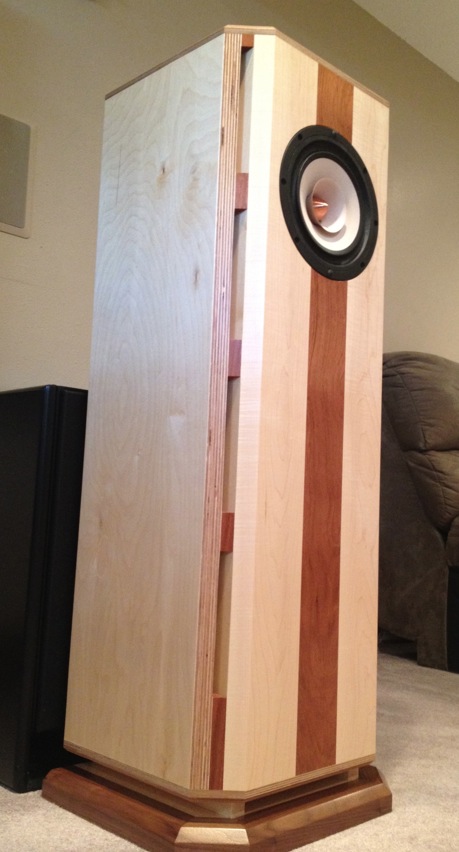

Alot of people like these, i have not been overly impressed. Preferring the 1880 over the 1772 i designed these: http://www.diyaudio.com/forums/full-range/218907-tanken-1808-tang-band-1808-a.html
dave
Darn Dave those are absolutely beautiful! Nice, nice work and design. I love the way they look.
Thetubeguy1954
I did the design, Jon Parkhurst did the build.
dave
