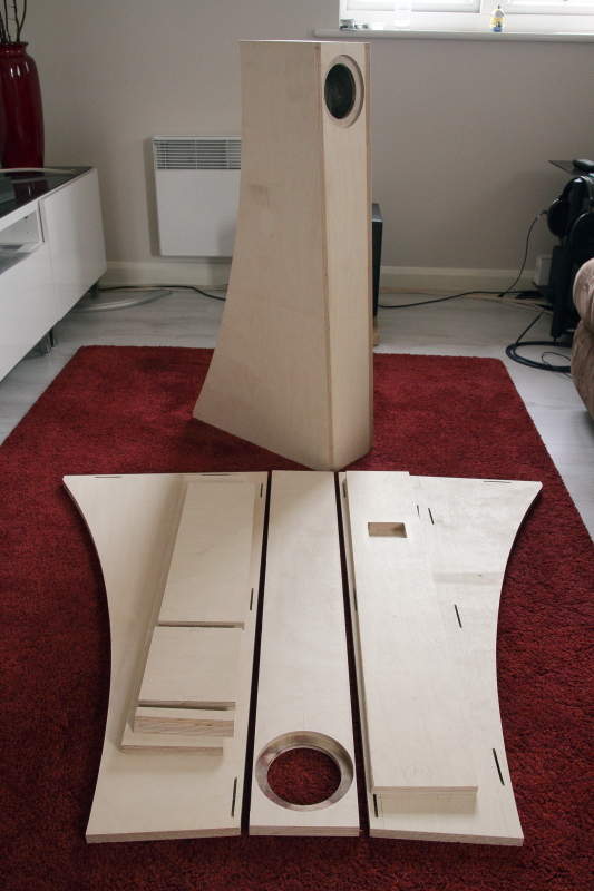

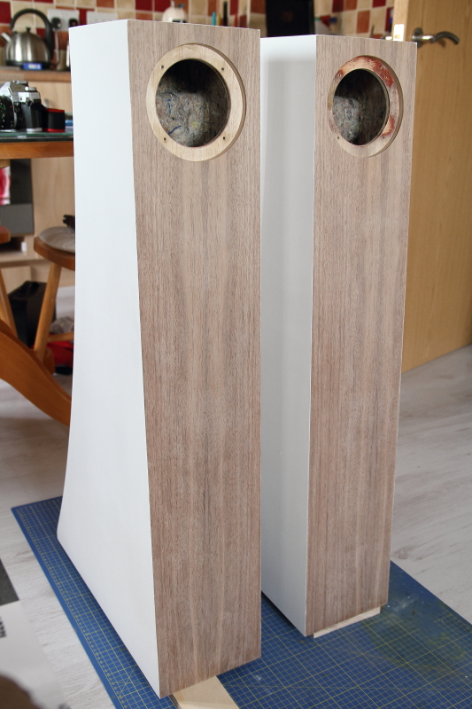

Having got my kits from Colin a few weeks ago, some progress has been made in getting them ready... As they stand this evening, the American black walnut veneer is on and have also applied two coats of primer/undercoat, which I'll sand tomorrow :)
With the MA Alpair7.3's fitted, the FH3 do sound very good. Very impressive indeed, particularly the lower end performance.
