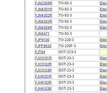

What about the Fairchild FJP5200/FJP1943 transistor? This is a TO-220 version of their FJL4315/FJL4215 (2SC5200/2SA1943 clones). It looks suitable for driver use.
My experience is that Fairchild's models are generally pretty good, so maybe it is worth simming with their driver and outputs.
Yes ,JC, they look good ,but WTF😡 no models. Fairchild
sucks in this way, they have good models for some but are
very incomplete in their listing. They want us to buy their
$#$T ,but don't even supply us with adequate design
resources...ARggg😡

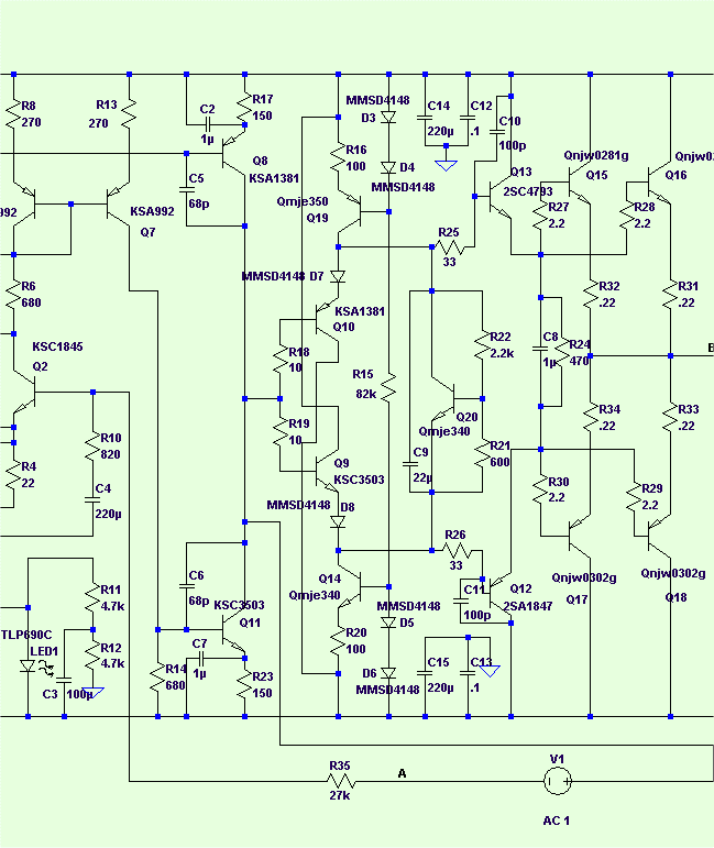

Now I will do the "Beast"... (attached)
OS

ahh ,drivers are "sher gut"..
Attached..

They do have models... they will only email them to you instead of download, but they have them.
AS they stand, they're a subcircuit which models both the transistor and the thermal parameters, but it is trivial to change it to a straight transistor model. Here you go:

Go to the actual product page for the device in question. If they have a model for the device, there will be a link "Models" in the Contents section of the page.
My guess is they maintain the models page by hand, and they havent updated it - a stupid thing to do, but well there you go 🙂
Got a few ideas after looking at your FA3:
Q8/Q11 dont have to dissipate much power - you could use KSA992/KSC1845 there instead. Then make Q9/Q10 the KSA1220/KSC2690's instead.
How about changing the mirror Q6/Q7 into a Wilson mirror ? Normally Q6 dissipates about 2mW and Q7 around 200mW which could unbalance it.. in a Wilson mirror the power would be dissipated in the 3rd transistor but this wouldn't affect the mirror's balance.
Personally I'm still diddling with my Cyrus input stage affair. The KSC1845/KSA992 have actually improved things a lot. My guess is speed is important in the input stage, the Cyrus One used very fast small signal devices (200MHz fT) here and in the VAS.
Who knows what i'll end up with though!

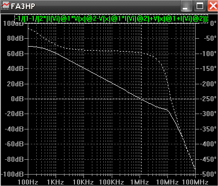

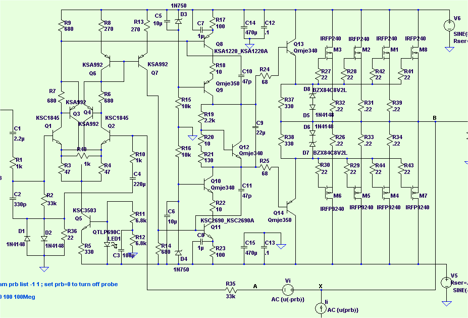

just ported the current amp of the krill to the front end of the FA3
and came up with ..WOW.. 🙂
Here is the circuit.. download in the frugalamp folder FA3K.asc
to play..
OS

Yes,yes ,yes...a wonderful predriver stage.. 😀
After reading about the diamond buffer,dissecting the "krill"
i have been won over to this technique. Steve dunlap explained
it to me very good but after playing with it, I wanted to
go solo (more like the marantz dc300).
This arrangement differs from the krill in 3 ways , 1. use of
a standard Vbe and 2 diodes bootstrapped (like the marantz)
2. Full global NFB instead of VAS only (eliminates CCS's
for the diamond (also like the marantz) 3. Use of the wonderful
input stage of the FA3.
This one has been fun to Simulate 🙂 😎 and performs better
than any I've done yet.. Very strange loopgain ,flat with
no "hump" at the end like a blameless or P3A type topology.
I first tweaked an isolated "krill" type current stage
to get rid of oscillations (fast newer devices) then
realized any VAS could be attached (used mine).
