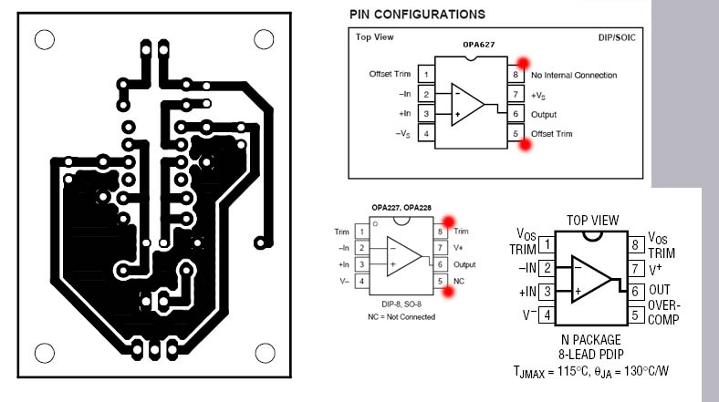

I am very much interested in freebird. But one thing I can not understand I have seen the DataSheets of OPA627 and OPA228. The PIN configurations of these two OPamps look different I think but you said that you have OPA228 with the same PCB . Can you explain that to me.
I am new and plz do not mind my stupid questions 🙂
I am also attaching its image

Dear Wasim:
when working with an Op-Amp one needs to be more concerned with Invereted and non-inverted inputs and outputs along power supply pins, in pinout picture that you attached it is clearly evident that OPA627/228 share the same pinouts for inverted and non-inverted inputs both at pin 2 and 3, outputs at pin 6, postive power supply at pin 7 and a negative rail at pin 4, as for offset trim pins, not many preamps use offset pins.

Hi Was,
look at the PCB again.
Pins 1, 5 & 8 are all unused.
The pinouts of the other 5 pins are identical.
