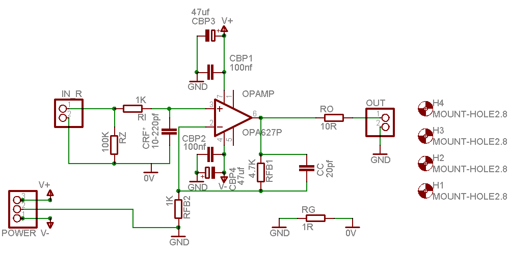

Single channel Freebird..
Here is the freebird single channel.

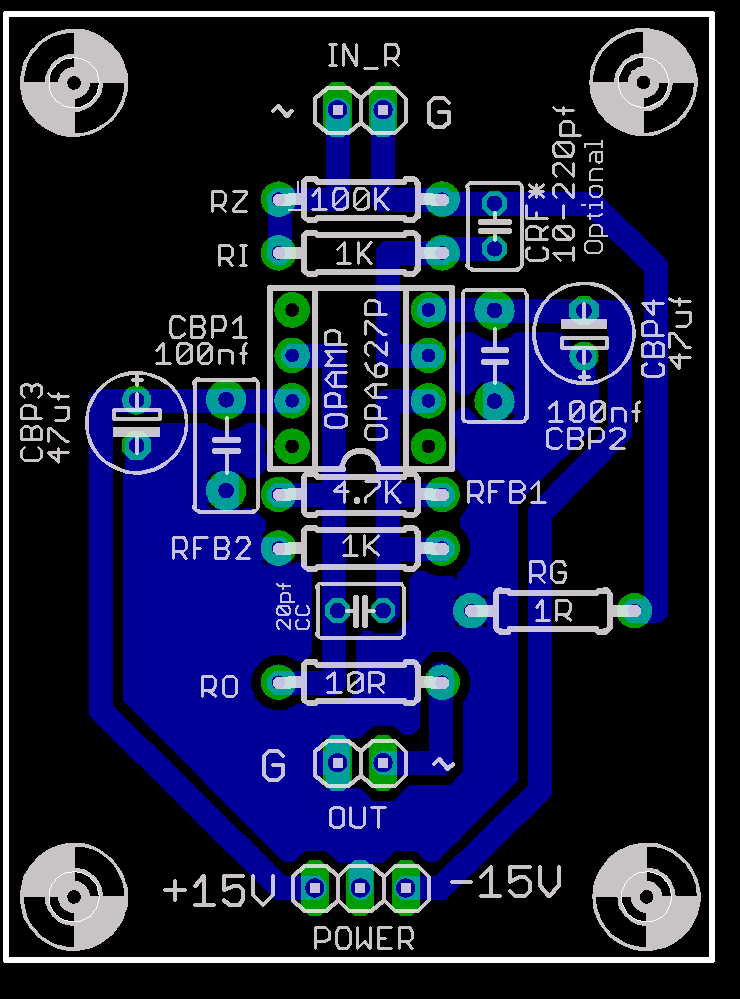

The PCB is tiny. (less than 2x2)
Here is how it looks. 🙂

Somewhere in this thread, Carlosfm posted his preamp design for a OPA627. Besides using different resistor values, and a 2k "class A biasing resistor", I noticed a 330nF capacitor between +V and -V. What would be the idea behind this capacitor? Anyways, I've added the capacitor to my Freebird, and I can't say that I notice much difference at all. I wish I had an oscilloscope so I could do some actual measurements though 🙁.
I remember when I did my thesis for school, I had a very bad noise in the circuit which was probably due to a poor ground circuit on the PCB. Anyway my advisor told me to put a small capactor between +V and -V and magically all the noise had vanished. I can't for the life of me remember why he said to do that, and I was hoping someone here would know?

Probably because the active component was not well bypassed in the first place. This circuit is very well bypassed. :yes: Also, the signal and power grounding is solid.
Mick_F said:
What is the use of the Cc capacitor? Are you sure it will not be a problem when DC comes in?
Mick
The CC( compensation cap) capacitor is optional, and is only really needed if you are using a very high speed/high SR opamp in very ow gain, like an OPA637 or OPA228 which otherwise would not be stable.
For DC you would put a decoupling cap at the volume pot wiper. There is none on the PCB an it is optional, most sources do not have DC.
This is a well proven design, quite a few here have built it.
The resistor values are all just suggestions you can use quite a broad range of values.
The important resistors are RFB1 and RFB2.
Gain is set by the following formula:
G=1+(RFB1/RFB2);
Cheers!
Russ

Cool, then there is no harm done by adding it in there.
I have noticed absolutely no DC on the ouput of the 627. I removed the coupling caps on my source which resulted in 3.4mV of DC. There is also 3.4mV of DC on the output of the 627 which is great because now there is only one coupling cap in my entire system.
