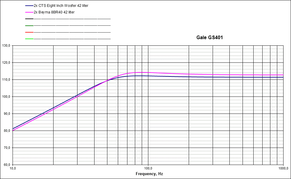

I think sticking with Rule 6 is important, as one of the aims is to see what can be achieved with modern components and methods. If we set out to have something that won't go as loud as the original then we're losing our way. It would be good to have something that could be fairly compared with the original.

it will be better than the Gales, but the ultimate 8" for your size is Scan Rev.
I would use...
Beyma 8BR40/N
Vifa TC9FD-18-08
One of the ones recommended by system7 or HiVi Q1R

There are few reasons :
1. Available in Australia (through WES)
2. I've worked with 12M and heard the D3004 and Scan 8" Rev
3. None of the 8 can work within his volume limits without EQ, when we apply EQ, the power handling drops significantly, hence we need woofers with stronger motor and more xmax (have a look at my simulation)
this is the ultimate version of Gale inspired speakers. I'm pretty sure there are few dozens of combo out there.
1. Fair enough as I obviously have no idea what's easily available in Oz.
2. I've no doubt that they are good drivers, just a bit on the steep side but as Brisso said 'Phase III' candidates.
3. According to MrMag and my own simulations the Beymas do 50Hz without eq using factory data.

With regard to -henrys- objection how loud do these actually have to go?
10mm nominal X is actually quite a bit as X-damage is at least +15% on these woofers so how much low bass boost were you thinking of henry??
the xmax is 3.5mm :)
