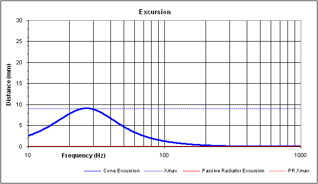

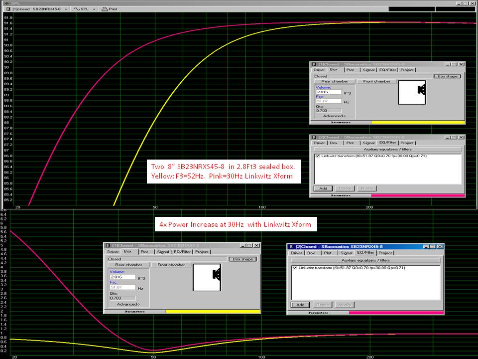

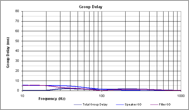

This trick might be the way to use a lower Q driver sealed:
http://www.humblehomemadehifi.com/download/Humble Homemade Hifi_Black Box_copy.pdf
I'd rather break rule 3 though...

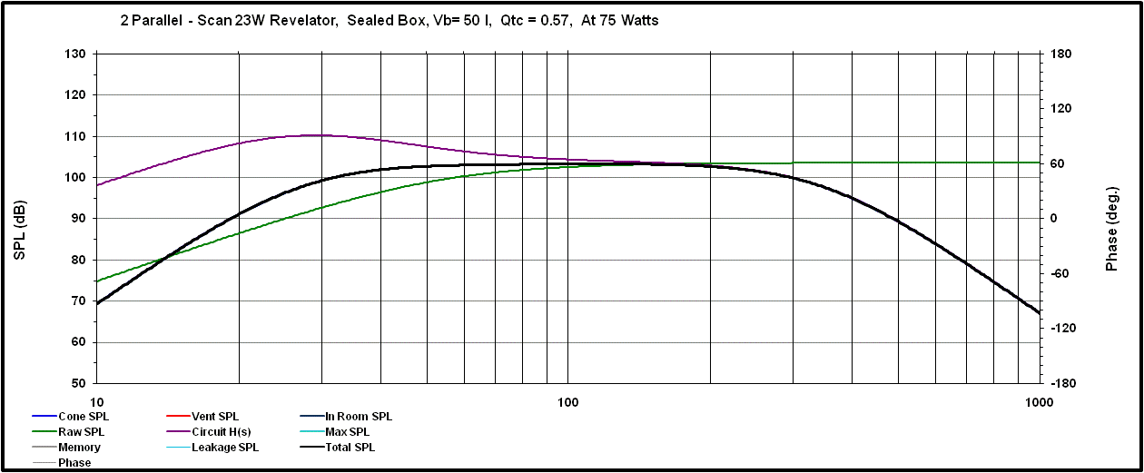

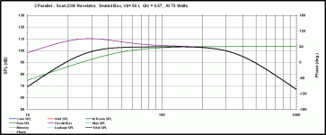

dual Scan Revelators in 50L box, with your dimensions (adjust depth to 305mm) plus 15% with 12mm Euro Birch Ply, possibly 50-75% fill
this is with LT and LP @350hz
