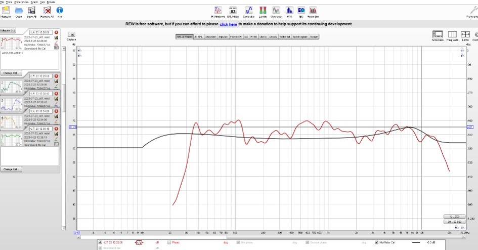

test SPL and adjust speaker, dsp, environemn, test and adjust, test and adjust......
finally, the SPL looks smooth......

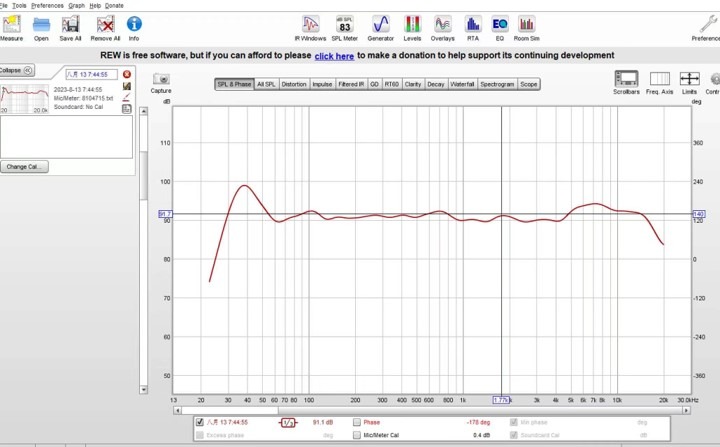

in the beginning, without diffusion block board

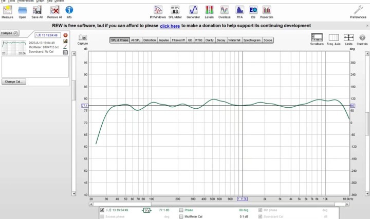

cut off the peak in 38Hz, the SPL looks vey smooth

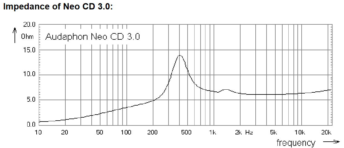

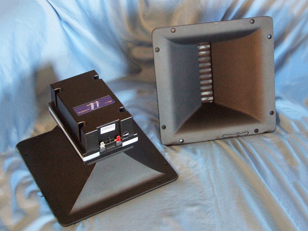

I hope you have capacitors on the true ribbons. If not, you'll short out your tweeter channel amp.

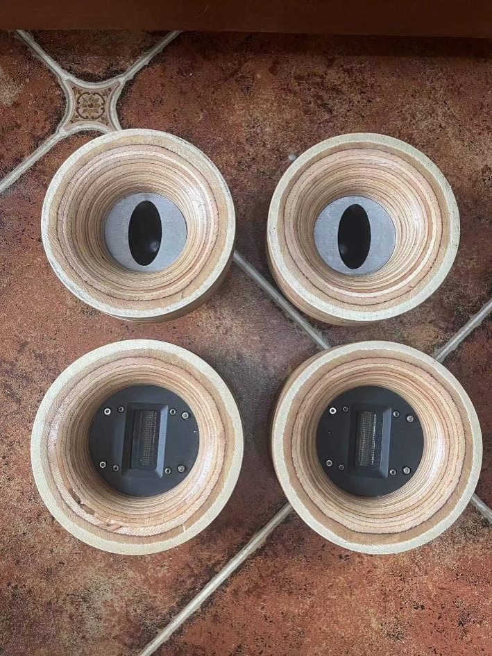

it is very complex, I did lots of testing for the horn shape, finally, that shape make SPL very flat, and sounds very smooth, it is really some different between theory and practice.I have a question about this picture:
I know that the beginning of the horn/waveguide should be as close as possible to the sound outlets or the diaphragms. Otherwise you would get a reflection chaos. Why has this been done differently here? Have these combinations of drivers and waveguides ever been examined metrologically?
An example of an AMT with waveguide from Beyma, image from Vance Dickason's Audioxpress Test Bench:
Many greetings,
Michael
Thanks for your informaiton, but I do not quite understand, I use minidsp flex 8 to seperate the frequencies to different speaker unit, is there anything I need to take care?I hope you have capacitors on the true ribbons. If not, you'll short out your tweeter channel amp.
A real ribbon-tweeter like the Neo CD 3.0 would have a resistance of close to 0 ohms without an output transformer, with its built-in output transformer this only applies to the lower frequency range, which must therefore be filtered out with a capacitor so that the responsible power amplifier does not "see" a short circuit.
But as you already wrote:
"it is really some different between theory and practice."
So try it out. 😉
Many greetings,
Michael

Yes you are right, Neo 3.0 present good performance in high frequency.
JBL 076 prensent decrease after 15k.
so that I use a 1.5uf capacitance to simpley seperate around 15k to Neo 3.0, this will make the SPL higher and sounds better after 15k.
bty, my system is DSP to seperate 4 ways + 1 way with capacitance for HF.

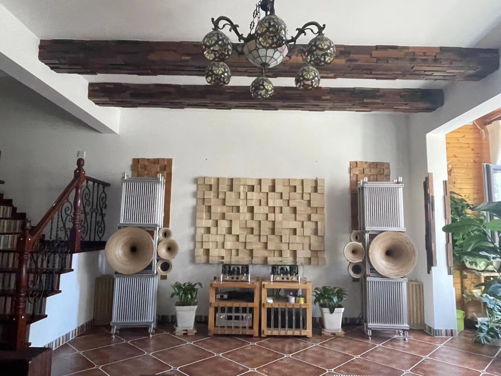

- The first DIY loudspeaker I am working on
