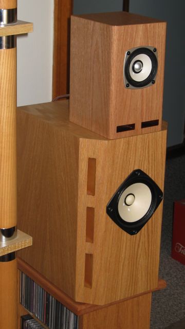

They’re finally done! The FF85k’s are in their micro-Fonken cabinets. Photo below shows one sitting on top of the larger FE127 Fonken.
I used Acousta-Stuff fiber from Parts Express, since the cabinet is so small and hard to install the foam lining I have used in other builds.
As you can see, I elected to use a round-over bit in the router than than doing a 45 degree chamfer on the vertical edges. I darkened the ports with Minwax red chestnut stain; veneered the cabinets in red oak; and coated with Minwax semi-gloss polyurethane.
Initial impressions:
-- No BSC needed; (I still don’t know why that should be, but, hey--it’s great!)
-- seems to have less bass than in the Sprites; probably because the Sprites have a ‘commercial’ tuning to put a little bump at the bottom end to make them sound like they have more bass than they actually produce.
Now I need to try integrating them with a sub--which should work better than the Sprites, since the bass is properly balanced and rolls off smoothly.
Cheers, Jim

Nice work Jim! Could you compare the two fonkens? Sound stage, depth, detail, etc. Obviously the bigger fonkens are going to have more bass but I'm just curious about your impressions of the two side by side.
Thanks!
Comparing the Fe127e to the FF85k: I like the FE127e, but the FF85k (above the bass freqs) has more of everything I like. It has clarity, detail, and balance. As to sound stage: you need bass for that, so I can't say until I get a sub running w/ them. As to imaging: I think the FF85k is better, but this is something I'm not as sensitive to as may others here seem to be.
My ultimate endorsement is that after hearing the FF85k's, I changed my plans for next summer's builds. I will be purchasing another pair of FF85k's which I will try in an MJK OB configuration, and perhaps another design as well.
Cheers, Jim
