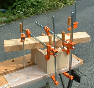

The Sprites have been fun, but now it’s time to move on. Finally got started on the micro-Fonkens! These are so small! Makes them harder to assemble than I thought it would be.
I only have six of the small clamps, so partial assembly, one cabinet at a time. And at the rate I work...expected completion is about one month.

Looks like we were doing the same thing today. Here are my uFonkens. Haven't decided how I'm going to finish them.
Total build time was about 7 hours (I work slow -- and that includes a few beer breaks).
I started with a 2x4 sheet of birch ply from Lowes. I ripped 2 boards 145mm wide using the table saw.
I used my mitre saw to cut the rest since the pieces are so narrow. I did all the 145mm pieces first and then ripped the remainder of the second board down to 102mm for the inner pieces. All the measurements in the PDF were perfect and everything fit flawlessly. I came up short for wood and I didn't want to rip another length off the original sheet so I used some spare MDF for the braces. I have enough wood left to build another pair if I wanted.
