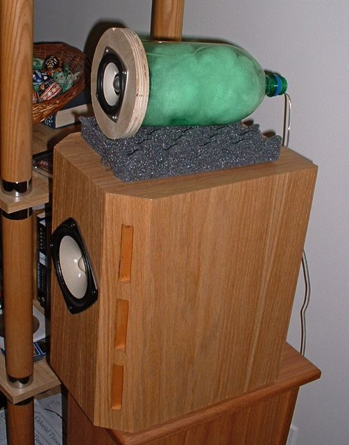

I’m busy right now building Metronomes for the Fostex F120A’s I bought last summer. However, I just bought a pair of Fostex FF85K drivers for a micro-Fonken build later this summer. Usually I put new drivers on OB (i.e. an old board) to check them out & get an idea of how they will sound, but I was afraid of hurting these little guys.
Others have put their drivers into cardboard boxes to check them out--not a bad idea! Just need to figure out how big a box I need. So I got out David Weems’ “Designing, Building, and Testing Your Own Speakers” and calculated a ported box for he FF85K. Works out to 1.77 liters and the port...Hey, that’s pretty much what I’d have if I cut the bottom off a 2 l soda bottle, glued a piece of wood to it, and added a bit of fiber fill!
So here it is: the FF85K Sprite!
(Note that Sprite is a brand of lemon-lime soda here in the USA.) Photo below shows The Sprite perched atop the Fonkens I built last summer.
How does it sound? Not bad. Especially considering that the drivers are fresh out of the box and the ‘cabinets’ are fresh out of the re-cycling bin. (But I do expect that the micro-Fonkens will be considerably better.)

The FF85k's are now broken in and sounding amazing! As noted above MJK came over to check out the F120a Metronomes, but took time out to have a listen to the Sprites. While the Sprites may look butt ugly and have no WAF, they sound GREAT!
That doesn't mean that I have abandoned the micro-Fonkens--those are under construction. On the other hand, my enthusiasm for the FF85k has me planning two, more extensive builds for next summer using this very special driver.

Hi Jim,
Glad the FF85k's are working out for you. If you were going to build a "regular" enclosure for these based on the calculations you made, what would be the particulars? For the 1.77 liter volume you mentioned earlier what would be the port size and resulting tuning freq / F3?
Hi ped,
I tossed out the calc. I did based on the Weems book, but a quick visit to Madisound for their link to an on-line calculator yielded the following:
V(box)= 1.82 liters
F(box)= 104 Hz
Ripple= 0.02 dB
F(3)= 96 Hz
Port D= 1.06"
Port L= 2.59"
Port area= 0.83 sq. in.
Not identical to what I figured out from Weems, but close enough.
