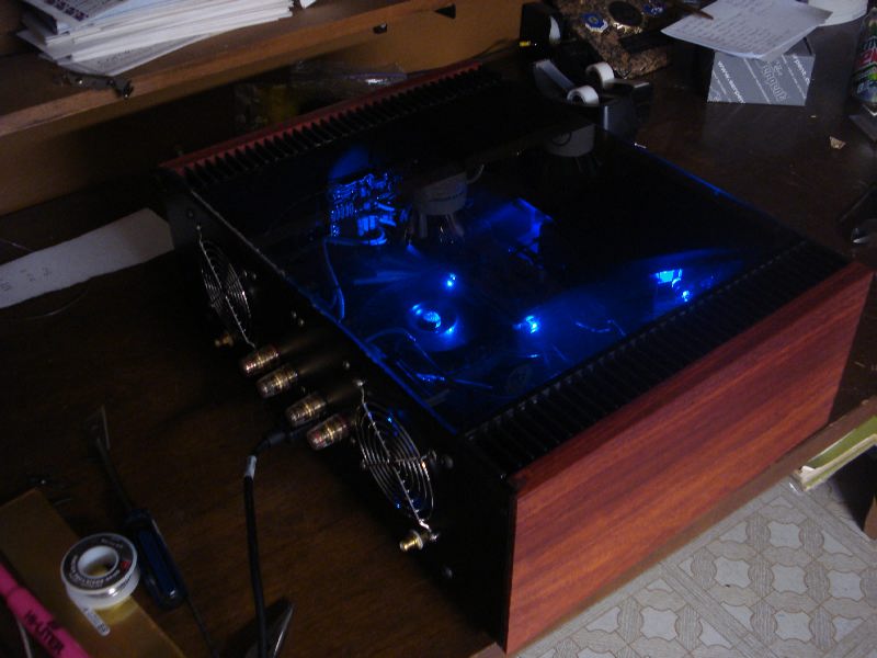

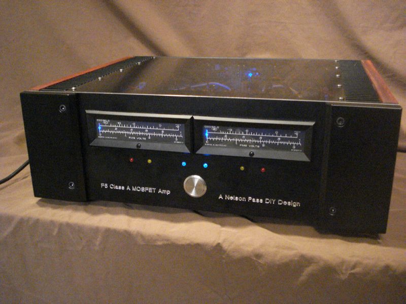

You have friends here. Despite your newbie disabilities as a physics major, we can help get you through....... and Oh.....I graduated with one of those physics degrees, too! (Pics of my "first effort"...a Pass DIY F-5 are attached)
The Pass designs are superb, provide outstanding results, and are perfect for a new builder. Welcome on board.
P.S. DO NOT overlook polarities on your bridge rectifiers, electrolytic capacitors and (of course) your semiconductors!!!
