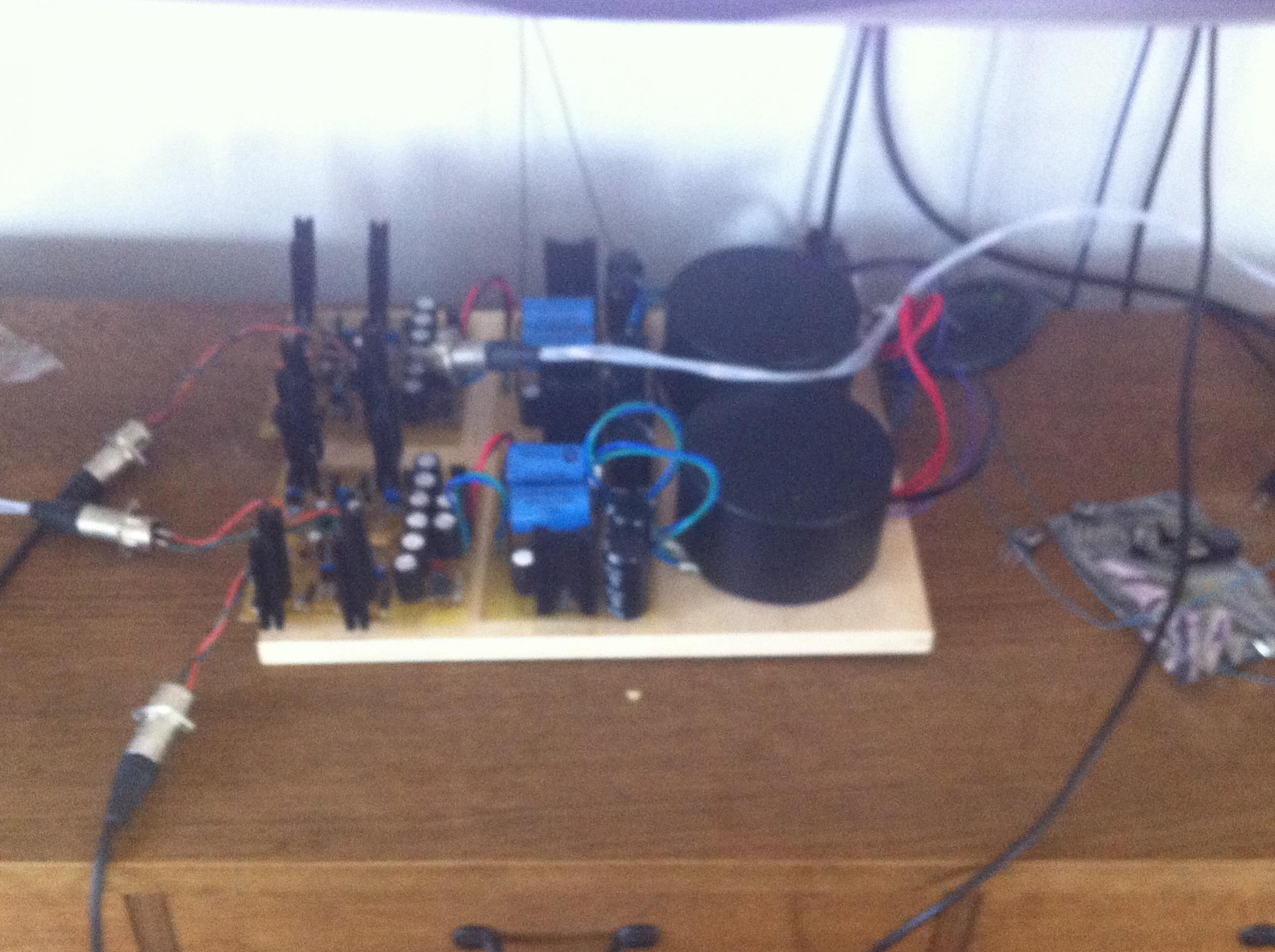

We listened for quite some time tonight. I am pleased with the overall sound. I am tempted to reduce the overall gain, but it is nice to have it. Pitch black background. It gives the impression of improving bass response, both in amount and quality. Excellent imaging and soundstage presentation. Rewards a good recording. An unexpected positive is that it seems to have a very organic sound. Its a bad description, but you seem to really hear the character of instruments when listening to small ensembles. It is a bit ruthless. I would not recommend it for poor recordings. This listening session was with Oppo105 FE, J2 clone, and Satori monitors. Next week we will try wth LP12 and Sota Saphire tables.

He wrote me this morning and said that he continues to be pleased. I may try changing the 200r load resistor to 100 to try to throw away more gain and reduce feedback, just to see what happens. He probably will tell me to leave it alone. I am going to try an SMD version with slightly different cascode and see how that turns out. Get either Susumu RG 5ppm or Vishay TNPU for the signal resistors. Make sure there not causing any issues. It is a good circuit. I am sure your highly tweaked version with the laterals is impressive. I look forward to seeing it fleshed out.
200R load is a good one as you can use 100ohm twin-ax cables and 100R termination resistors as in a transmission line.
If you want to be able to drive lower load (like 100R), you really need other MOSFETs with a higher transconductance.
I do not see a need to do so at this stage.
If anything, you should first check square wave response.
Then try lateral FETs if you can get them. Beware of different pin assignment.

So, Mr Patrick. I have an interesting experience to relate about my not so similar clone that I would like to get your opinion about.
Last night we had a good long listening session. Setup was Oppo105>Blue Jean Cable(Belden 1800F version)>(terrible clone)F5X preamp gain stage>DIY XLR cables>Terrible J2 clone> Satori Moniters
My brother wanted me to listen as he said the preamp had opened up some more and was pleased with where it seemed to be going in terms of performance. Only significant issue remaining was a slight graininess on the top end. I agreed about the graininess and argued that it was either tweeter cap or probably something we could tweak in the preamp. The graininess was present but was more of an issue if being extremely peculiar. The preamp sounded nice, but i felt that something was still missing. It was not WOWing me as much as I had expected. IT was good, very good, but not reference. I was bothered by my DIY XLR cables in the chain, as we had done a direct comparison with the Belden version when just playing the Oppo into the J2 and had noticed a difference. It was subtle, but present and audible. I had requested that my brother get an extra set of cables to replace the DIY version and he had done so, but instead of getting another set of Belden, he got two sets of Blue Jean Cables Canare version. We plugged in the Canare, replacing the DIY XLR cables in between the preamp and power amp and listened again. When the song was over, we both discussed the fact that there had been a noticable change in a very positive way. The sound opened up in a way that neither of us had expected. To be sure, we listened to a couple more songs, switching the cables bakc and forth. Without any doubt, the improvement was real. All in all, i was not surprised, as we are talking pro cables vs my cables. Even thought the sound had taken a big step in the right direction, we decided to try to switch the Canare for the Belden in between the Oppo and the Preamp. WOW. Talking about opening up. The sound coming from this rig now is reference level. I am talking about not building anymore and just listening. Synergy complete.
In an effort to be scientific in my approach, I went looking for the datasheets on the two cables. Here they are. Clearly the system liked the lower impednace cable. It made a SIGNIFICANT difference in the sound. Before it was good but constricted. I had no idea until the change, jsut how constricted it was. I was truly taken aback by the change. This preamp sounds so good now that I will be patiently waiting for your improved version.

Not my synergy, my brothers. In no way am I advocating fancy cables. I believe the answer is right there in the datasheets. Transmission line theory is most likely the explanation, but i just wanted to relay the experience. We are talking a distinguishable improvement in sound. Perhaps buffers on the outputs of both the OPPO and Preamp would negate this difference, but I cannot say with certainty
This is what I use myself, together with Lemo 2B connectors.
http://www.belden.com/techdatas/english/89207.pdf
No buffer needed for the preamp. It has enough driving capabilities.
