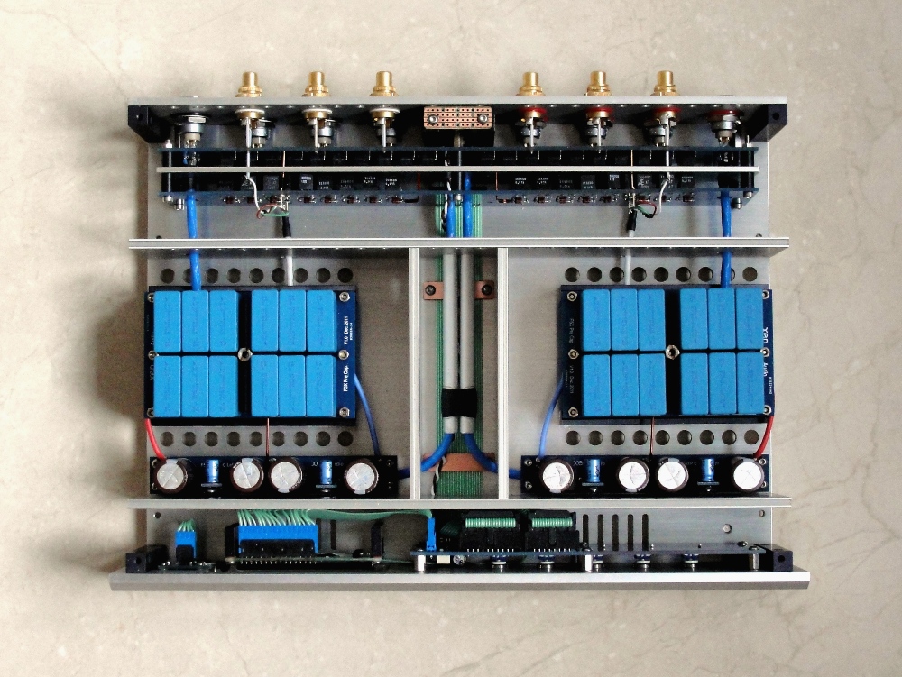

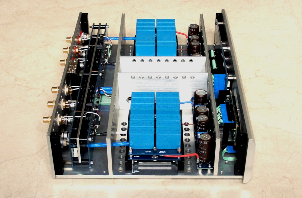

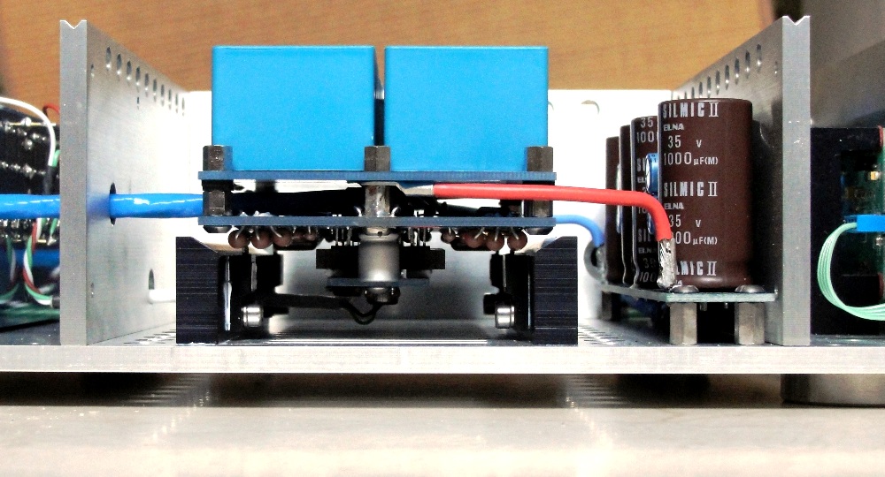

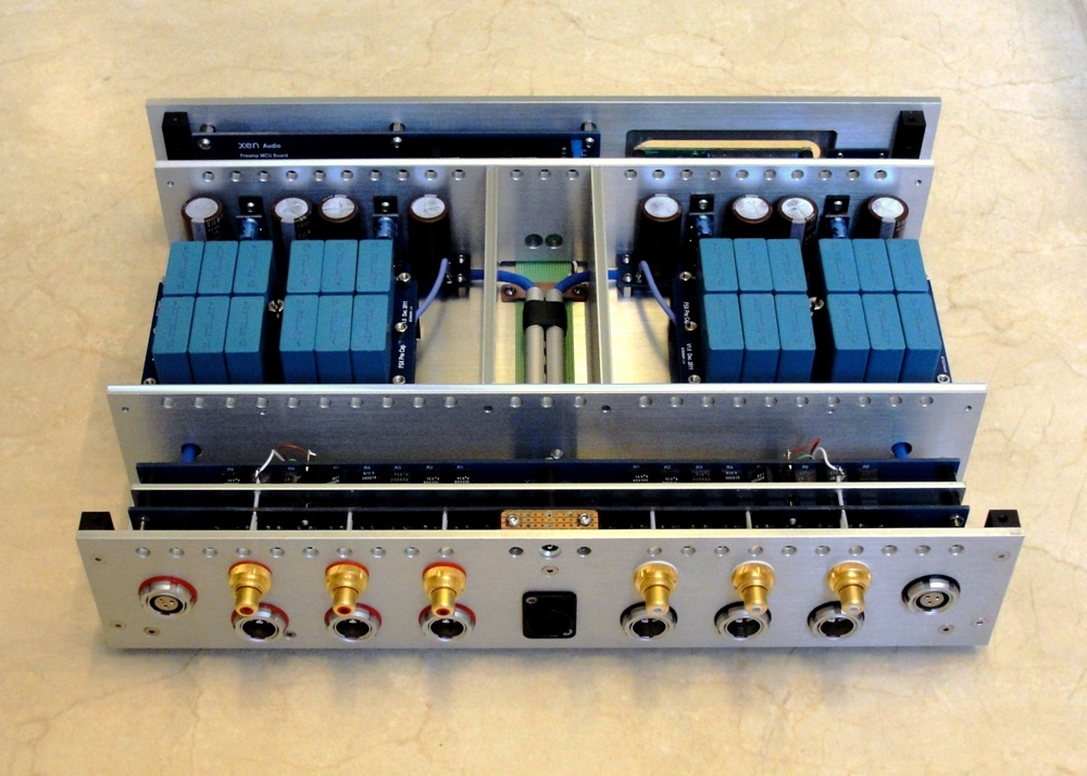

Another 6 months have gone, before I have another update to post.
Wiring is now totally complete. Testing in the next weeks.
And then that would be it, for me at least. 🙂
Patrick
PS This is my personal example with a few non-standard things such as Lemo connectors, etc.
Patrick
