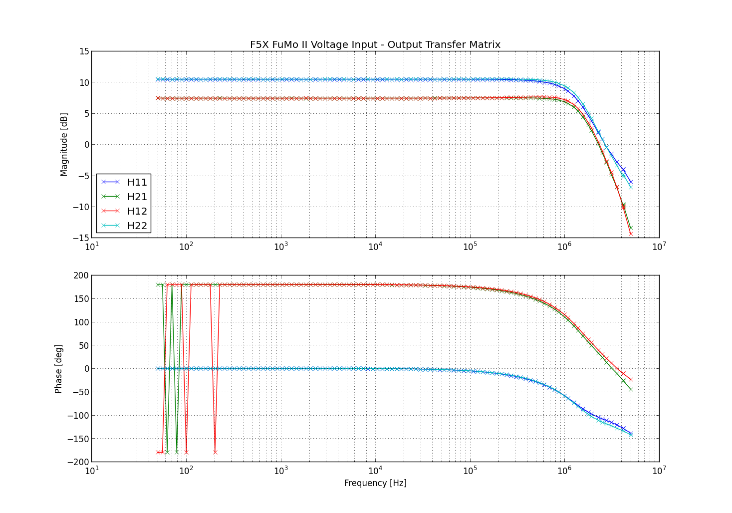

So I did an input output transfer matrix measurement with my F5X proto to find out how well this works.
The attached plot shows the measured voltage transfer matrix from both input terminals to both output terminals. A 11Ohms resistor across the output terminals served as load for measurement purpose. From each of the inputs the transfer to both outputs was measured while the other input was shorted to GND.
As one could see the bassband gain is pretty flat before it is turing into a (approx.) 2nd order roll-off at a corner frequency of about 2Mhz. Very impressive, but nothing new to most of the DIYers around here I guess. The phase also does not reveal any surprises. ( The phase wrapping spikes of the off diagonals H12 and H21 are due to measurement noise)
What could be read from the data is that the gain of the off-diagnoal elements is about 7.5dB whereas the gain of the diagonal elements is about 11dB. This means this amp driven single ended results in a difference of 3.5dB ( factor 1.5) in the amplitudes of both output terminals. Well, one could say this is still balanced, but not perfectly.
Since the topoloy of the F5X P is almost identical I anticipate a very similar result. I will keep on looking around for other options for SE - balanced transition. Conceptionally transformer would be ideal but I am not sure how far the parastics of the realizations will hurt.

Any fully balanced amplifier with negative global feedback will have unequal amplitudes on the two phases when driven with a single ended signal.
I remember Nelson mentioned this also years ago.
The SE inputs are there for convenience, not for serious use.
Anyone who is serious about making optimal use of the F5X (or F5X Pre) should use differential over the entire chain.
To convert single ended to balanced properly, one could use a simple inverter circuit to generate the negative phase.
The simplest of that is of course an inverting opamp with unity gain.
The other option is a Blowtorch type circuit with grounded inverting input and unity gain.
Or as you said, transformer (fully passive and hence simplest).
Patrick

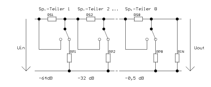

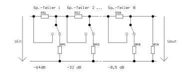

But you are welcome to use one of those constant impedance attenuators if this is what you all agreed upon (see attached).
We'll make a special "public" version then with max. 8 relays per channel.
The problem with such a solution is that the signal goes through a chain of resistors and relay contacts in series.
We compared those to just a potential divider with 2 resistors. Huge difference.
So we ourselves will stick to our own solution.
The balanced input signal will only see 2 fixed series resistors and a shunt resistor.
The latter being made up of a varying number of resistors and relay contacts, BUT in parallel.
Patrick
