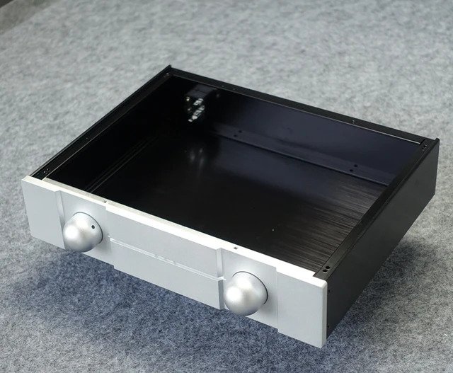

Here are some information about the case we used, and a comparable one from HiFi2000.
The links are just examples, you need to search around for best offers.
BZ3213 Blank
https://www.ebay.com/itm/295542655383
https://www.aliexpress.us/item/2255800533216694.html
External Dimensions -- 320W x 130H x 313D
Internal Dimensions -- 220W x 122H x 300D
Heatsink Dimensions -- 300 x 50 x 125
Weight 6.3kg; Shipment weight 8kg
Hifi2000 Mini Dissipante 3U 300mm
https://modushop.biz/site/index.php?route=product/product&path=285&product_id=716
External Dimensions -- 330W x 126H? x 313D?
Internal Dimensions -- 250W x 120H x 300D
Heatsink Dimensions -- 300 x 40 x 120
Weight: 5.5 kg
The BZ3213 has slightly better heatsinks.
The Mini Dissipante has a bit more width inside.
We have not tried the latter, but we attach here a layout drawing of our build.
You can then check whether you can still use all our PCBs.
Or you have to plan your own build from scratch, using other cases.
You need a DWG reader to view the file; plenty of freeware around.

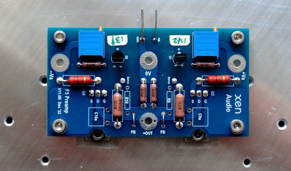

Two more frontends were built today with gain 20 using Fairchild MOSFETs and JFETs.
Bandwidth is 750kHz -3dB without any compensation or feedback caps.
So circuit works well also with the said alternative devices.
Too dark for photos now.
Tomorrow, if the sun is out. 🤓
Patrick
Patrick

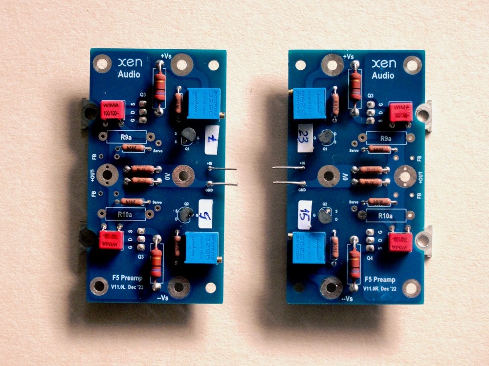

As promised.
Note the oritentation of the JFETs due to different pinout.
The caps shown are not connected and only come into play in MFB configuration.
Maybe should pair with some Fairchild power MOSFETs in the M2OPS.
Should have quite a bit higher 2nd harmonics.
But the frontend can still be nulled for H2 as in the F5 Turbo.
Extra pads provided for trimming resistors.
Patrick

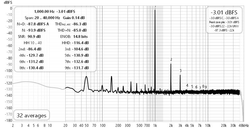

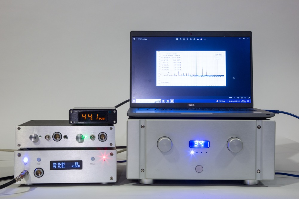

I am pleased to say that we already have 2 Beta Testers, who will proceed to order PCBs.
In the meantime, Fran has sorted out his distortion analyser and here is the first measurement of the entire integrated amp.
Signal source is the Viktor oscillator at full output, attenuated by the modified Relaixed to output 8Vpp into 8R.
