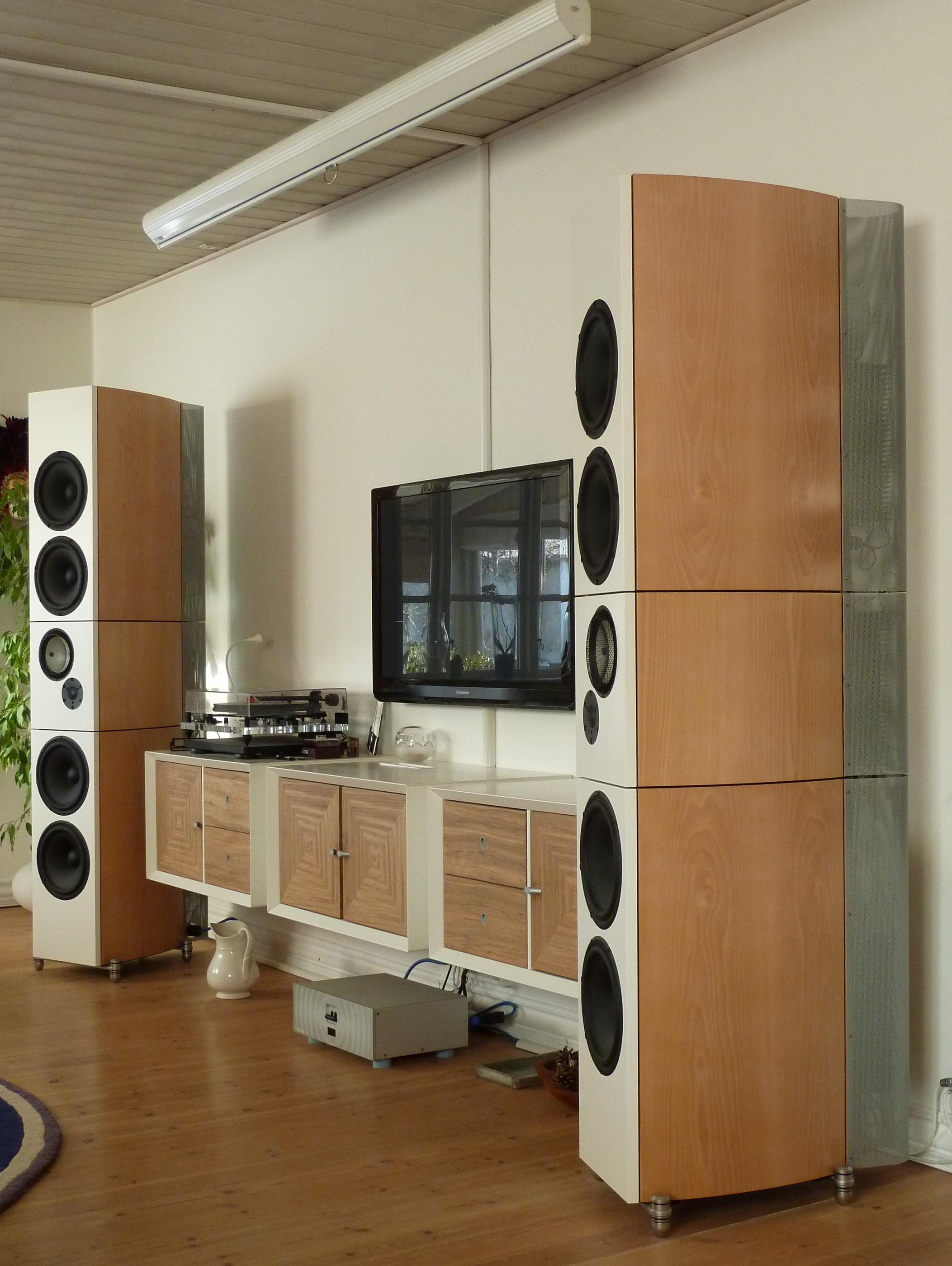

Almost a year in the making, but finally the changeover from the old Peerless 8" bass drivers to new Scan-Speak 10" Revelator drivers is finalised.
Due to the larger diameter of the 10" drivers and the ensuing diminishing amount of material at the edges of the baffles (where driver chassis gets closest to the edge), it was necessary to replace the 20 mm MDF baffles with 20 mm aluminum baffles to ensure enough strength/stiffness.
This material change also made it possible to update the design a little, so I decided to paint the new baffless the same colour as the cupboards 😉
See photo.
So, what about the sound?
Well, there is still a NAKSA 100 driving each bass enclosure, so with drivers being 8 ohm, and with two drivers per enclosure, it's a 4 ohm load. Since I use a digital/electronic x-overs, there are no passive components whatsover between amps and drivers, and as the NAKSA 100 is rated at around 180 watts in 4 ohms, I have around 4 x 180 watts of power available directly at the driver terminals, i.e. just short of 800 watts in all! 😀
And I can safely say that those NAKSAs keep the drivers on a very short leash! Bass is now much more precise and especially much more dynamic than before. Just goes to show that it was not the NAKSAs holding back (I knew that) 🙂

Yes, this system will definitely go loud! However, houses in Denmark are usually quite sturdy - and my house is no exception; built in 1935, double brick walls (yes, real brick) and a very sturdy roof. My listening room is some 30 to 35 square metres and fairly well dampened by various furniture, which means that some power is needed, but no roof-lifting has ever been imminent 😉
A major part of the philosophy behind the Equilibrium system is that amplifiers and drivers should remain as un-stressed as possible. So, using 8 fairly large drivers has the effect that each driver actually does not move a lot, but having those 8 drivers gives a large total membrane area that can certainly move a lot of air. The same goes for the amps - so having an amp for each bass driver enclosure means that each amp operates in an area where it can deliver its best. You know, I've never been able to make those NAKSA 100s clip. I believe the drivers will start failing before the amps do!

Yes, version 1 of the Equilibriums was really good. They did in fact have an an analogue electronic filter for the bass section, and this worked surprisingly well, but could not be adjusted for room anomalies - hence the 'punch in the stomach' back then 😉
But things have moved since then. Considerably. Not that there isn't 'punch in the stomach' anymore - there certainly is! But now the punch comes from the sheer dynamics and power of those 10" drivers and is under iron-fist control by the NAKSAs. And I could go on to speak about faboulously, deep, high and wide soundstage and phenomenal details.
