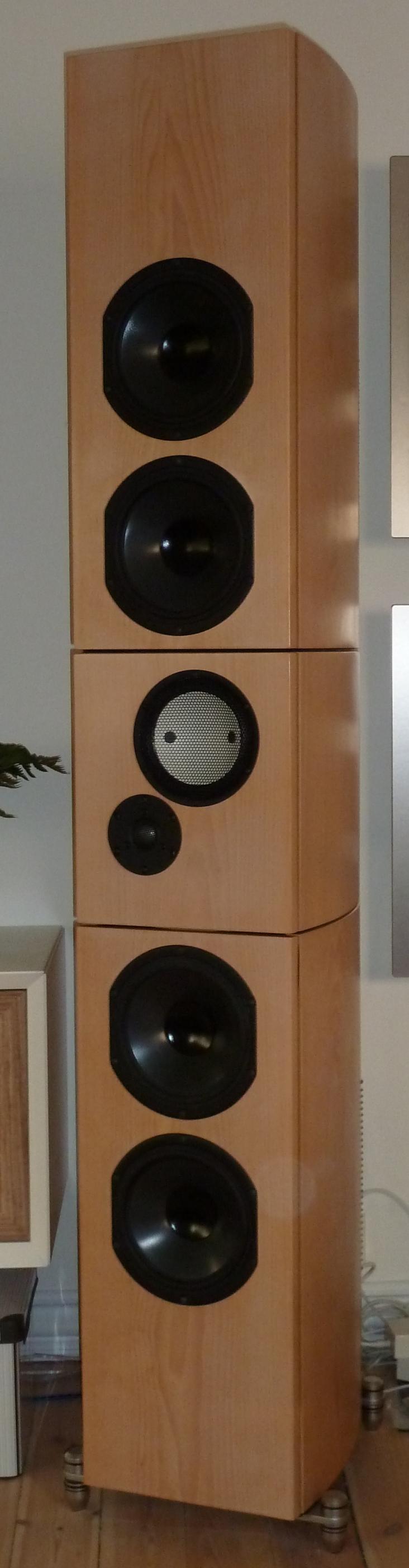

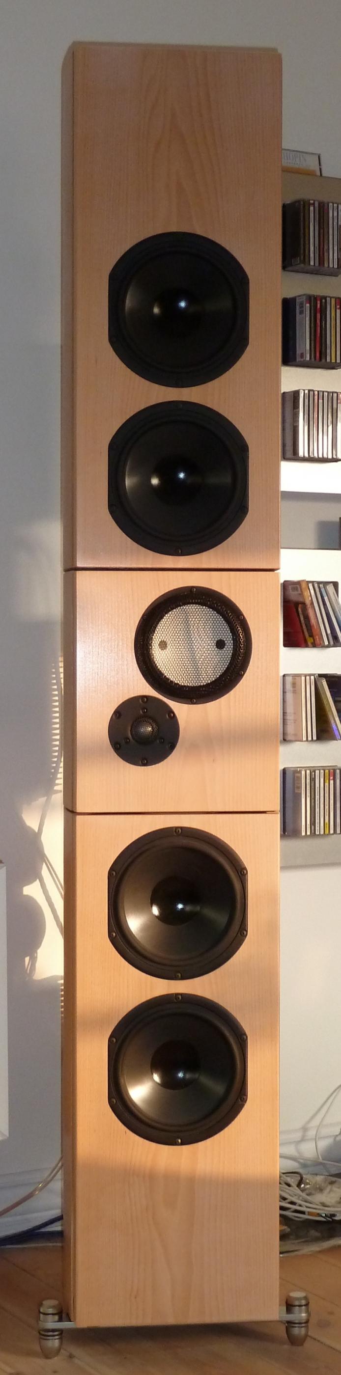

Almost a year in the making, but finally the changeover from the old Peerless 8" bass drivers to new Scan-Speak 10" Revelator drivers is finalised.
Due to the larger diameter of the 10" drivers and the ensuing diminishing amount of material at the edges of the baffles (where driver chassis gets closest to the edge), it was necessary to replace the 20 mm MDF baffles with 20 mm aluminum baffles to ensure enough strength/stiffness.
This material change also made it possible to update the design a little, so I decided to paint the new baffless the same colour as the cupboards 😉
See photo.
So, what about the sound?
Well, there is still a NAKSA 100 driving each bass enclosure, so with drivers being 8 ohm, and with two drivers per enclosure, it's a 4 ohm load. Since I use a digital/electronic x-overs, there are no passive components whatsover between amps and drivers, and as the NAKSA 100 is rated at around 180 watts in 4 ohms, I have around 4 x 180 watts of power available directly at the driver terminals, i.e. just short of 800 watts in all! 😀
And I can safely say that those NAKSAs keep the drivers on a very short leash! Bass is now much more precise and especially much more dynamic than before. Just goes to show that it was not the NAKSAs holding back (I knew that) 🙂
Jens
