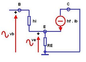

As others have said in the emitter follower as the base voltage is applied the emitter voltage increases. The output voltage rises. A positive going signal into an NPN emitter turns it off with respect to the base. No other conclusion is possible than that being negative feedback.

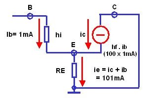

In a BJT if you take the (current) gain as the Hfe, you can expect that an emitter follower has about Hfe distortion reduction. However, the non-degenerated BJT is pretty non-linear so even with Hfe to work with, the distortion will be a far cry from zero.

doesn't the emitter follower has always 100% negative feedback in voltage?
A property common of active amplifying devices, tubes and transistors, is that they have an electrode which imperfectly copies the voltage variations of the input electrode. In amplifying circuits, its effect can be seen as soon as this electrode is separated from ground by a load. What can then mean 100% negative feedback ?

His article is available here https://hifisonix.com/audio-power-a...ndall/baxandall_audio-power-amplifier-design/ and go to Part 6 (a download is easier to read). The transistor is Common Emitter for AC. The base effectively see 1k at AC - effectively adds 1k/(Beta+1) in series with the transistors re. The re~Vt/Ic=26mV/1.5mA=17 ohms. His Beta is 580, So add another 2 ohms to re giving about 20 ohms. The gm=1/re = 50mA/V. The available loop gain is gmxRL = 50m x 3k3 = 165 or 44dB (neglecting Early effect).
He varies the amount of feedback from 0dB (no feedback) to 40dB (almost max available) using the feedback pot.
With full feedback the jig would give the amount of feedback that an emitter follower would give which is pretty close to the 40dB mark on his plot Fig 2 (see Post 49 above). My Post 22 jig showed an emitter follower gives exactly the same distortion as a common emitter stage with 100% feedback. The feedback depth of an emitter follower in dB is 20 Log10(1+gmRe) where gm is the Common Emitter transconductance at the DC operating point. And the gm can be calculated as shown above.
Typically the feedback depth of an emitter follower is 30dB to 40dB. This is more than enough feedback to get over the "enough feedback" requirement for re-entrant distortion to be a non-issue in our amps, as shown in Bob's plot Post 48 above.
