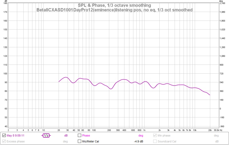

I certainly will. There is a build lot on PETT as well. The woofer is the Eminence Definimax 4012ulf-8 in 2cu and an fb of 38. I will be using a MINIDSP to cross between the woofer and mid/tweet. And passive between mid and tweet.
Rkondra, where is your crossover? I'm concerned the cone used as a waveguide would not give optimal results. Your chart shows I am probably wrong.
Thanks!
Thanks!

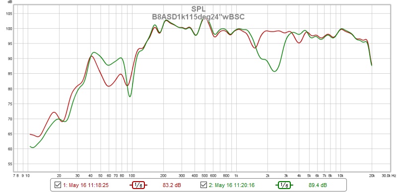

Acoustic xover is at about 2.3 KHz. Far from the electrical. Neither driver is very flat in the xover region. However, end result is good, with a deep null with tweeter inverted indicating good in-phase response throughout.
Not textbook, but measures (and sounds) good.
To your point, "optimal" ? not even close. Usable ? for sure !

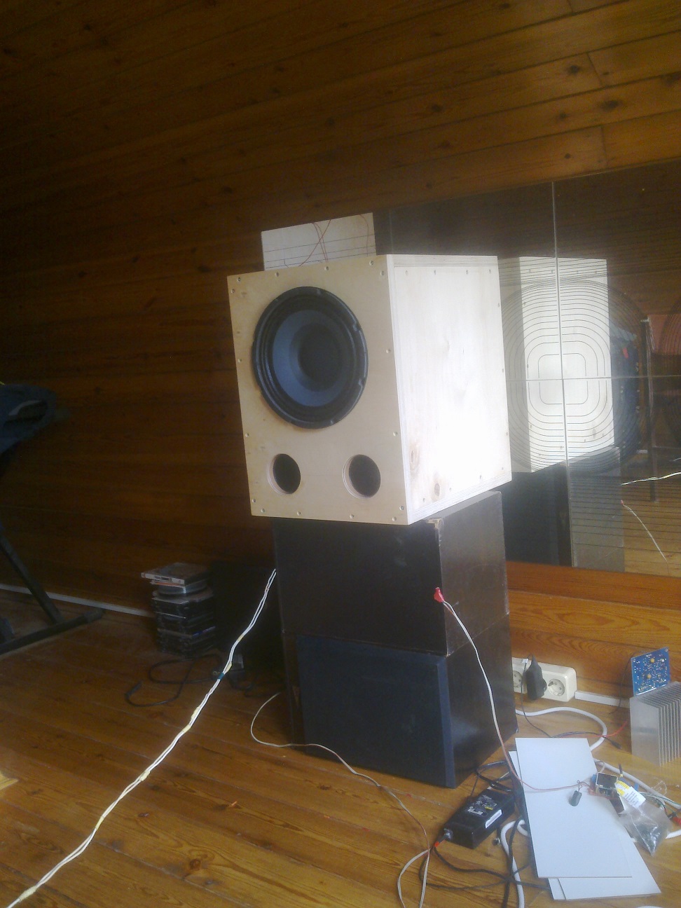

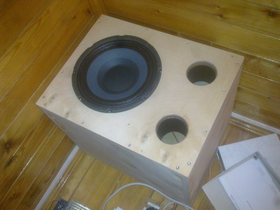

Finished. with ASD1001 compressors.
Very transparent, very punchy, very very beautiful speaker, but there are but's....
Will measure it soon and publish data here. Right now, i still prefer OR-70 close boxed speakers, on the last pick 🙂)
Crossover is an original eminence.

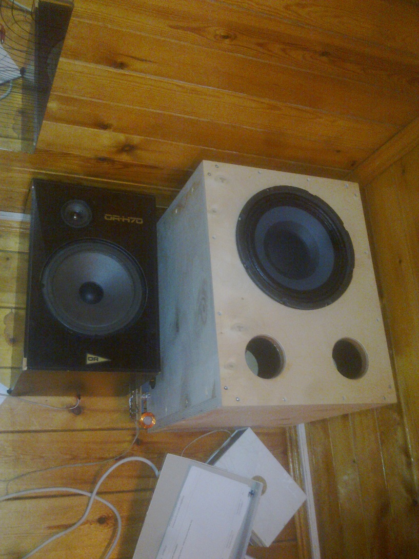

Are those pictures inverted or the speaker is close to the ceiling ? The driver axis should be at ear level for it to sound OK. Did you listen to them with the box raised to match your ear level ?
ashok, blakkshepeaudio

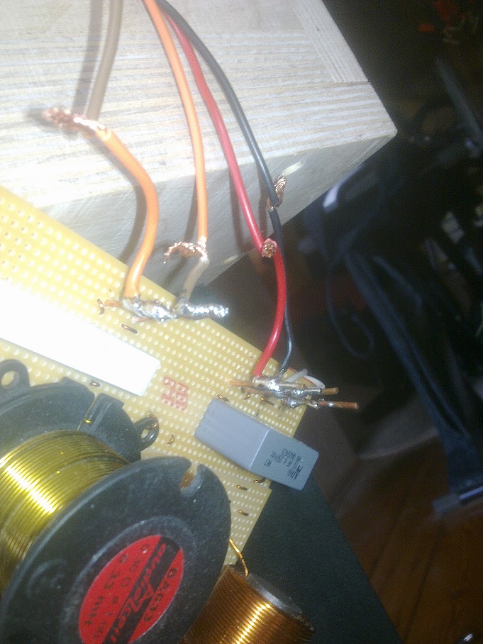

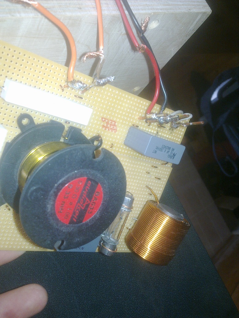

I did new pics, positioning and first two pics show the tweeter (Orange, Brown reversed connections).
I found the problem, omg. Inverting the tweeter connections brought back mids and tonality.
Connecting tweeter backwards results in strange vocals and mids.
That transparency ppl😎
Listening all the morning today, this beauties cannot be compared to OR-H70, not from any angle.
