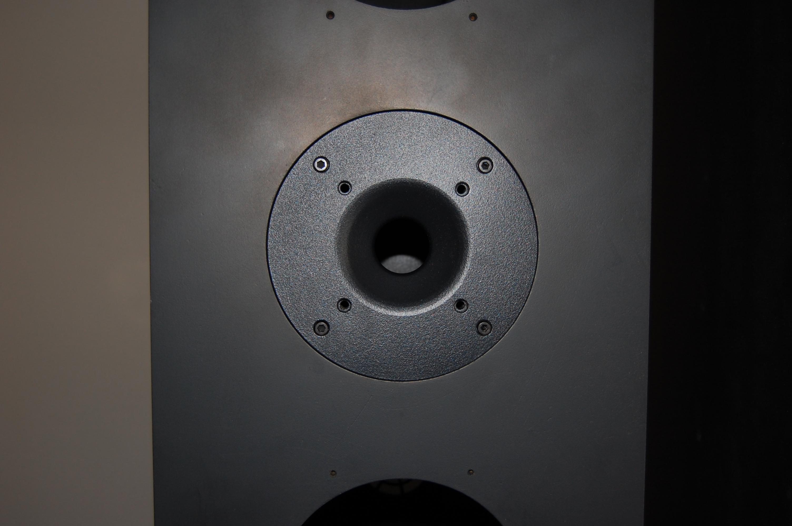

2. Waveguide: Does it have to be a metal like aluminum?
2b. Waveguide: What are the tolerances on this? If I do
.. a 1" circle will be maybe 1.004 wide by .996 high. Would this be fatal or could it be adjusted for when the waveguides are mounted?
2c. Waveguide: How "smooth" does the surface of the conical part need to be? .... Just wondering if it needs to be glass flat or if very small variations are OK.

1. A 1000 US$ is quite feasible based on basic materials, but nothing fancy - in addition to not getting fancy veneer that would also not get you Finnish Baltic Plywood, audiophile film caps and ribbon inductors, but you could upgrade the X-over components as you please later.
2. Metal is not essential for the waveguide - Joe's friend provided the first batch of waveguides in MDF. I think a waveguide turned/machined out of exotic wood would look very nice.
2b. Regarding tolerances -- e.g. 1.004 wide by .996 high -- such a small change would have negligible effect on waveguide performance. However, the tweeter dome is fixed and round, so there could be some issues making the throat of the waveguide fit properly.
2c. I'm not sure about smoothness. Smoother is better but I doubt that there would be an audible difference between "glass smooth" and "slightly stepped". The waveguide I (and several other satisfied customers) purchased on this thread is more like "sandblast smooth" due to the powder coating finish.

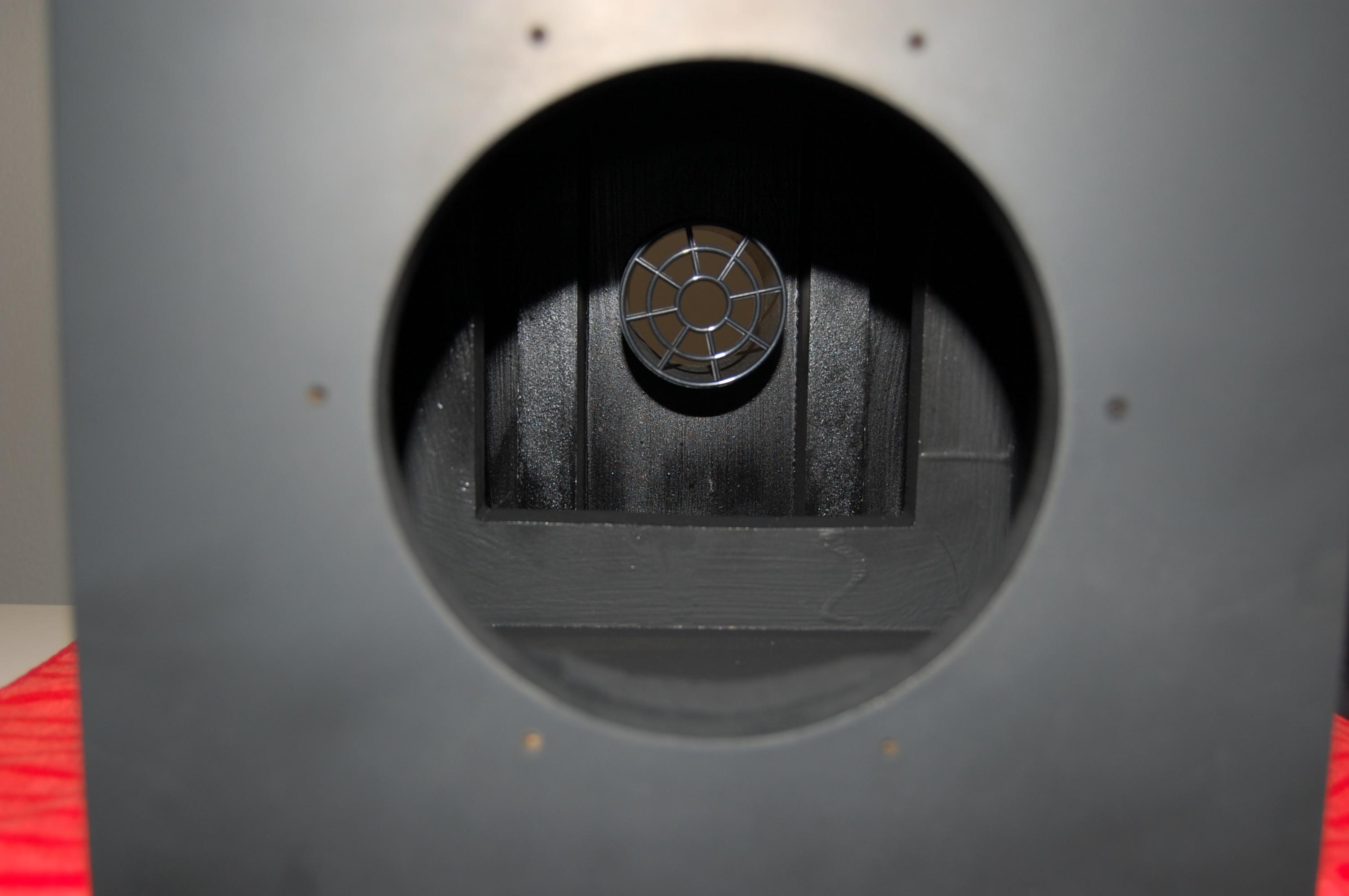

As per Joes post 80 on page 8.
Re port, use 60mm (internal) and 120mm long. If the 60mm port is slightly less than 60mm, then that will be OK as well. But if it gets close to 55mm, then reduce length to 100mm.
I found this.
OD: 90mm
L: 125mm
Cutout: 70mm

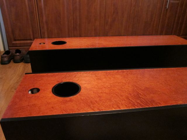

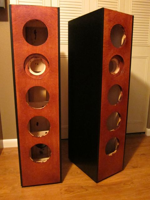

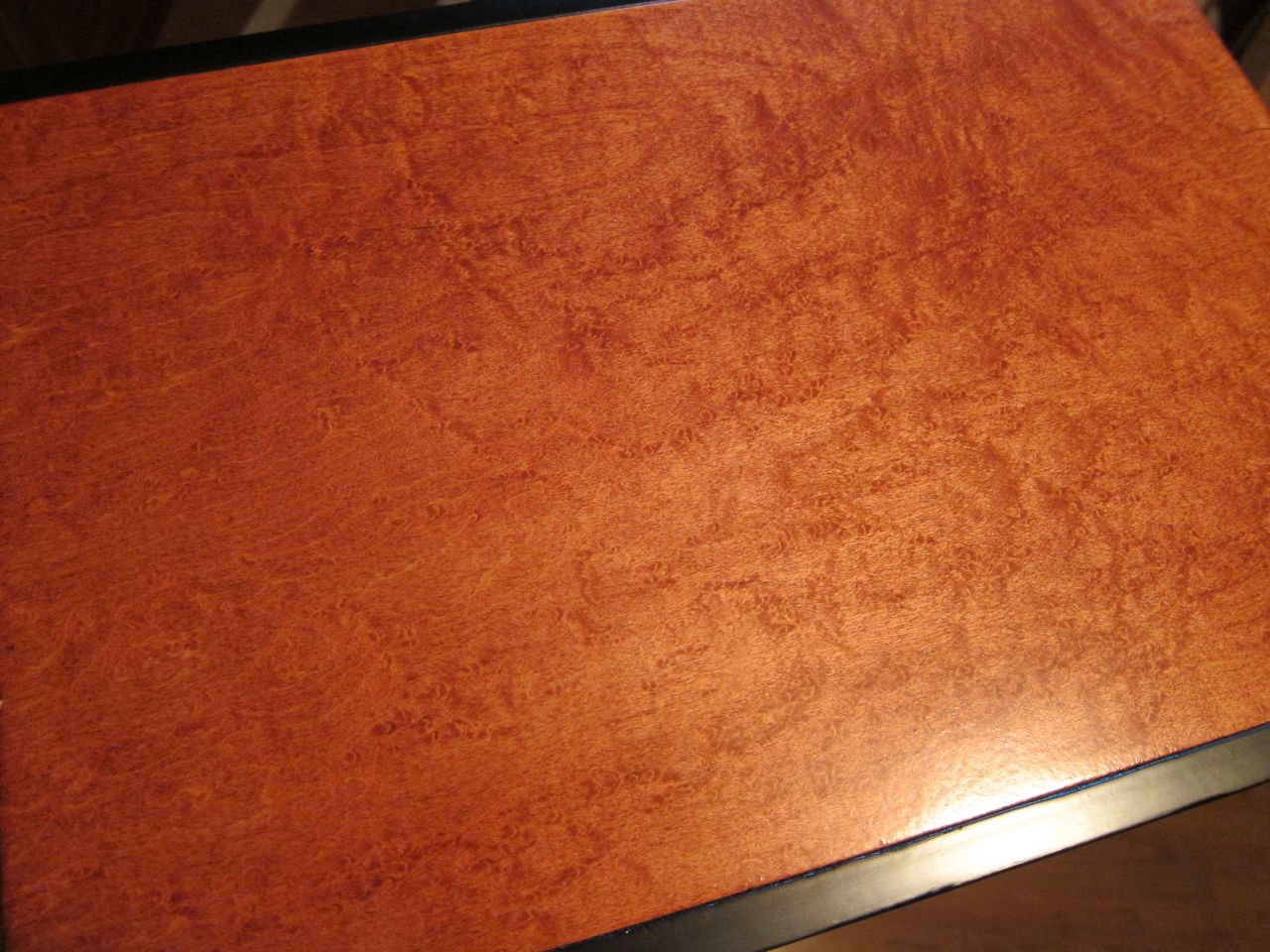

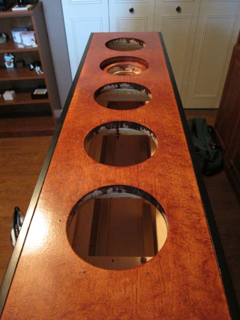

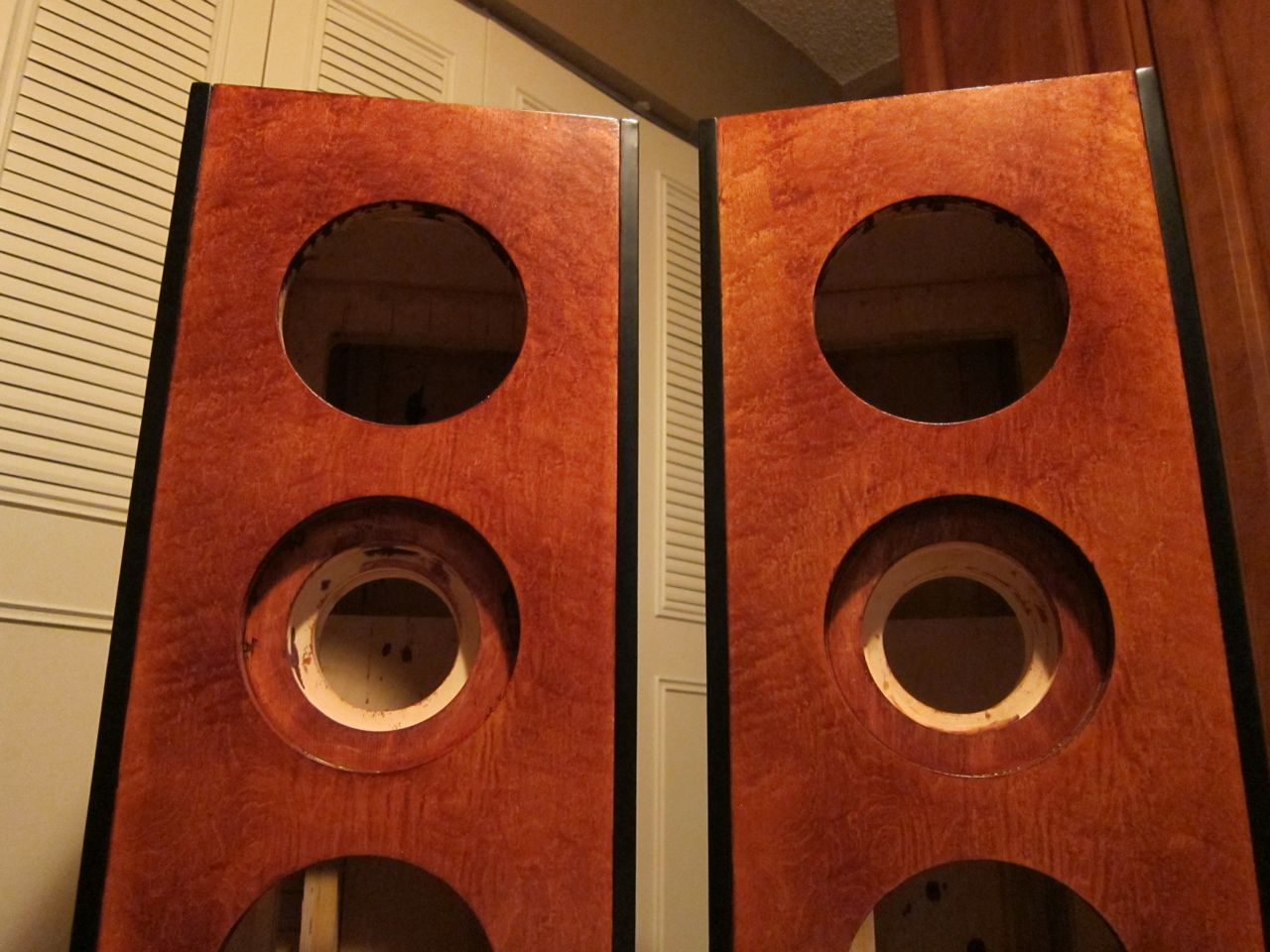

Well, the holidays and the day job took quite a toll on my ability to make forward progress (and I thought it might be a slow start to the year, HA!).
Anyway, I was finally able to finish and attach the side panels, insert and chalk the ports into place and put the final finish coats to the side panel end facings. Overall, I am very pleased with the results. The pictures are some what poor due to lighting, but, should give you a general idea on what the finished product will look like and where I am ultimately heading.
In any case, the cabinets are finally finished. (Yeah!!) I fit and drilled the driver holes this weekend as well. Now to stuff them, wire them up and then transition to build the cross overs.
The end is actually in sight and that feels good.

Jake, Noticed that you only left one hole for the input wires. A big part of tuning the speakers will entail changing some of the crossover parts to your liking. It is much harder and takes much more time to change parts when they are inside the cabinet. With that much time between changes it can be very hard to tell which you like best. Yes, ultimately you will probably end up with a favorite set up and it won't be an issue. At least use speaker terminal style spade connectors on the tweeter cap so it will be easy to reach through the woofer hole and change. Also the port tuning will be something you will want to do when the speakers are finished and working. Small differences in stuffing and stuffing material make a lot of difference at the port length. The speakers look stunning. A far cry from the black painted particle board mine are made of.
tpate,
I will be building external crossovers. I am using a neutrik 8-conductor speak-on connectors to bring out the connections to each of the drivers (two spare connections). Each driver will use spade connections to allow quick disconnect from the wiring harness. I will take a pic of the harness when I am finished with it to give you a better idea of where I am headed. I hear you though, flexibility appears to be key for any DIY design and I am attempting to embrace that philosophy to the fullest extent possible.
As for the port, it is held in by friction and anchored (and sealed) by silicon chaulk. If required, it will be straightforward to remove and remount. Not easy, but, straightforward. The material for the port is an electrical PVC coupling, so, extending should not be an issue (nor shortening for that matter). I should have a fair amount of leeway if need be.
