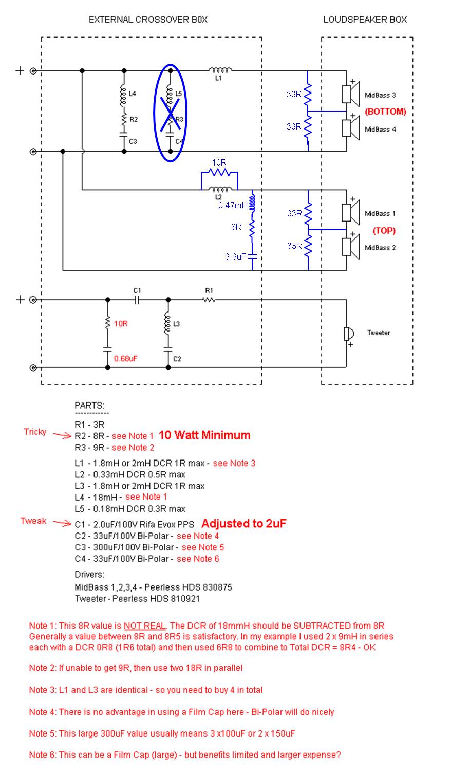

What is clear is that, if the speaker is pointed directly towards the listener (both of them of course) then expect there to be an excess of energy centered around 4KHz. Toeing out will lessen that lift and if you wish to experiment with that, it is definitely suggested that you do. The final amount of toe-in could well dependent of the inherent brightness of your system and if it is biased that way tonally, you may even find point the speaker straight down the line of the room (but no more) as preferable. But I suggest that in a well-balanced system there will always be some toe-in.
tpate was troubled by this excess energy and after we measured his Mark 5, I modeled the crossover and suggested the attached modification for his crossover. For builders that find their listening setup to highlight the excess woofer energy around 4kHz, this modification might prove to be beneficial.
tpate is currently using this modification and has been very pleased with the results in his setup with both solid state and tube amplifiers.
Basically the modification involves 3 changes shown in blue in the attachment:
1) addition of 4kHz LCR notch filter to the upper woofers, similar but not identical to what was used in the Mark 4 crossover.
- parts involved are 10ohm(10W) placed across L2, and the LCR notch filter made up of 0.47mH + 3.3uF + 8ohm(10W)
2) removal of the LCR midrange impedance compensation from the woofer circuit to avoid an impedance dip in the midrange with two LCR filters in place.
- parts removed are L5, R3, & C4
3) addition of resistors across each woofer to swamp variations in impedance that can result if you receive woofers from different production batches.
- parts involved are 33ohm(10W) resistors placed across the voice coil of each woofer.

I have been listening to Bolserst's crossover mod for a few months now. If you are running a linear current amp the mod might not be for you. If you are running a conventional tube or transistor a or ab amp I would highly suggest you try it. First go with the 33 ohm resistors in parallel with the woofers. The bass gets really tight and the midrange is more defined. The notch filter smoothes the top end and both of my amps "liked" the load better than stock. I say this because the music seems to flow more easily, dynamics are better and the image is rock solid. I also use the "gap" on the wave guide with these mods. Before the mods I listened to my hybrid tube/transistor amp 80% of the time, the tube amp just couldn't keep up. Now I listen to each amp an equal amount. Never heard a tube system sound so good, and this is using a pentode. The sound now rivals my 20K list price Soundlab A-1's, for listenability and image. I didn't say anything earlier since it was Bolserst's mod and we wanted to make sure that the mod stood the test of time. (Sometimes mod's sound different and it takes time and many different albums to make sure they sound better.)
I've been running the changes for a few months as well. I have the same experience as tpate with the tube amps. Switching between SS and 8w 300b amps and leaving the tubes in for much longer periods..

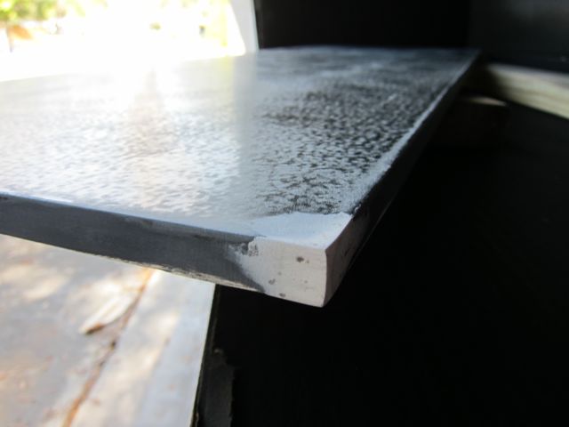

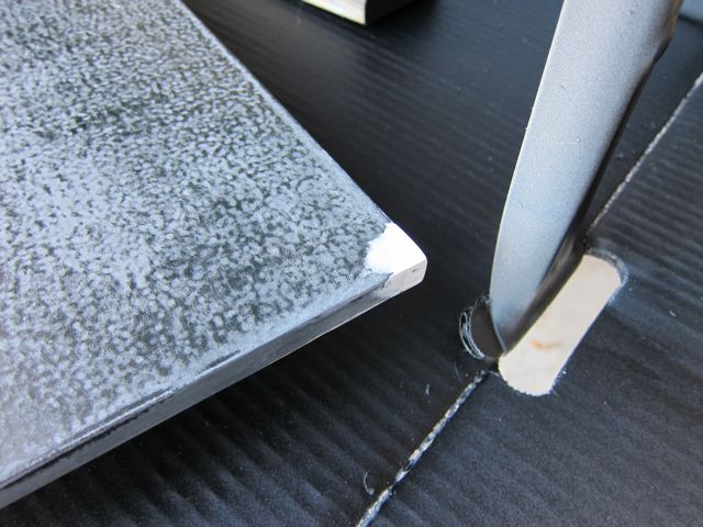

Small setback, nothing that cannot be fixed though...
No, I have not dropped off the planet. Spent the holidays applying layers of finish. The side panels have taken far longer to get the look I am after.
So, I finally got everything done and was going to start final assembly of the side panels to the main cabinets when an accident happened. I should have known better as I was just getting over a stomach flu that had literally kicked my a--.
During the prep for glueing, I was not paying attention and the panel, precariously perched on my work table, slid off and careened into the floor. The resulting force mashed in one of the corners. Now, there are only four corners and only one is the top front corner, the corner most visible, the only corner that MUST be perfect. Guess which corner hit the floor first? Yup, you guessed right.
So, I ended up using J-B Weld wood epoxy to rebuild the corner. It worked really well. Very easy to work with and took only two coats to blend correctly and shape to match the seam correctly. I am now in the middle of sanding, repainting and refinishing that piece. Hopefully it will look close enough to the other pieces, which I had painstakingly worked to be identical. Crossing my fingers.
The day job is backing my up big time, but, hopefully within the next week or two I can finish the cabinets once and for all.

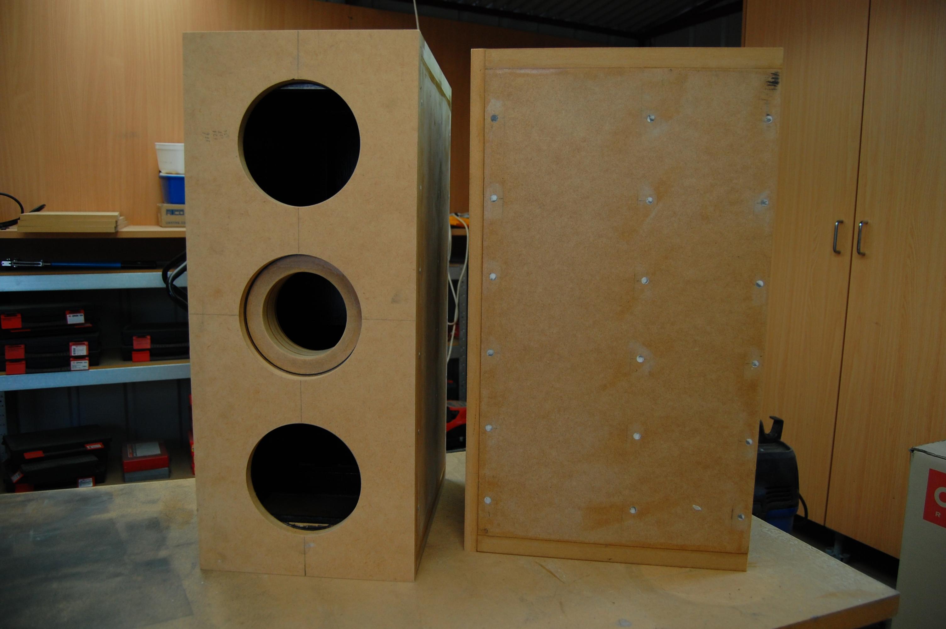

Hamlets
As per Joes post 80 on page 8.
Re port, use 60mm (internal) and 120mm long. If the 60mm port is slightly less than 60mm, then that will be OK as well. But if it gets close to 55mm, then reduce length to 100mm.
I found this.
OD: 90mm
L: 125mm
Cutout: 70mm
Looks the goods.
