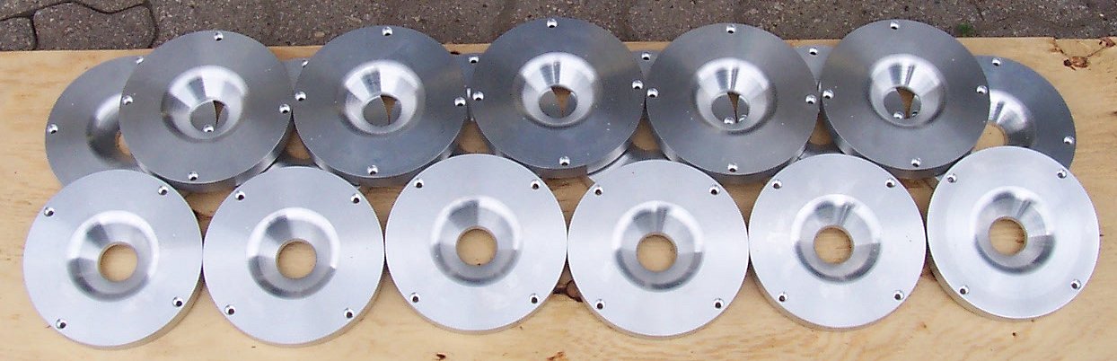

how much for the aluminum ones raw / not powdercoated ?
$140
I delivered and picking up tomorrow a pair that has a new version of black. Costs me $40 for a single pair but 20 in a batch..
Time to wake up this thread!

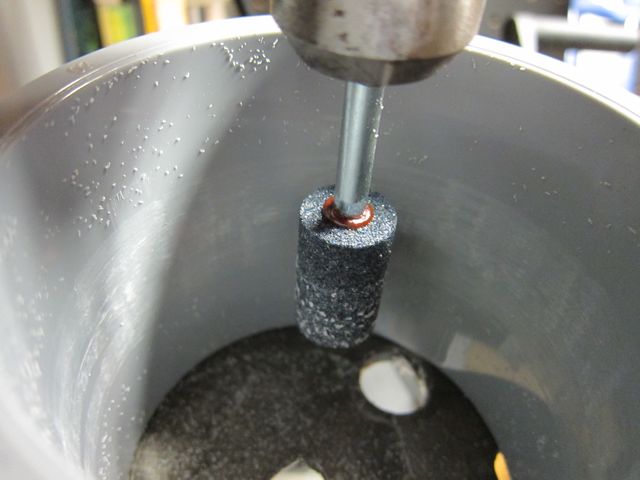

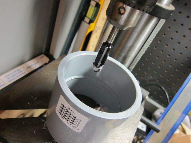

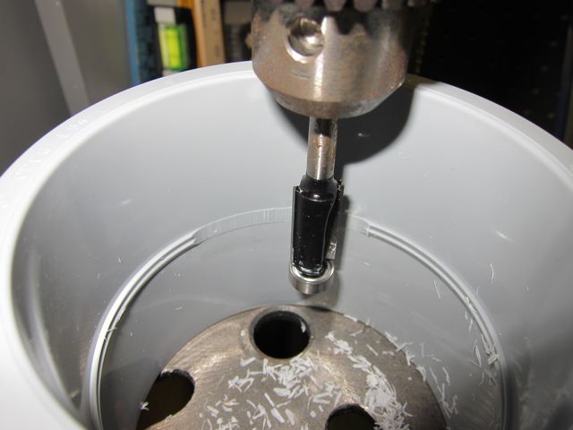

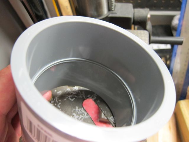

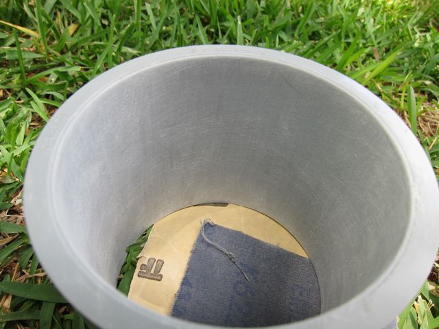

I thought I would share the technique I used to remove the seating rib from the electrical coupling connector I will be using for the port (first photo).
Second photo shows a 1 inch router flush trim bit mounted in my drill press. Pulleys set for 3050 rpm for a workable level of speed. This made it easy to trim down the rib to a workable depth as seen in the third photo. It was easy to maintain control and a level of safety while only removing material I wanted removed.
Fourth photo shows a grinding stone bit being used to finish the removal of the remaining rib as the flush bit is never truly flush. The final finish and surface prep is put on with a bit of emery cloth and a bit of elbow grease. Ready for painting....

Smart! Always like to add a new method to my collection. Thanks

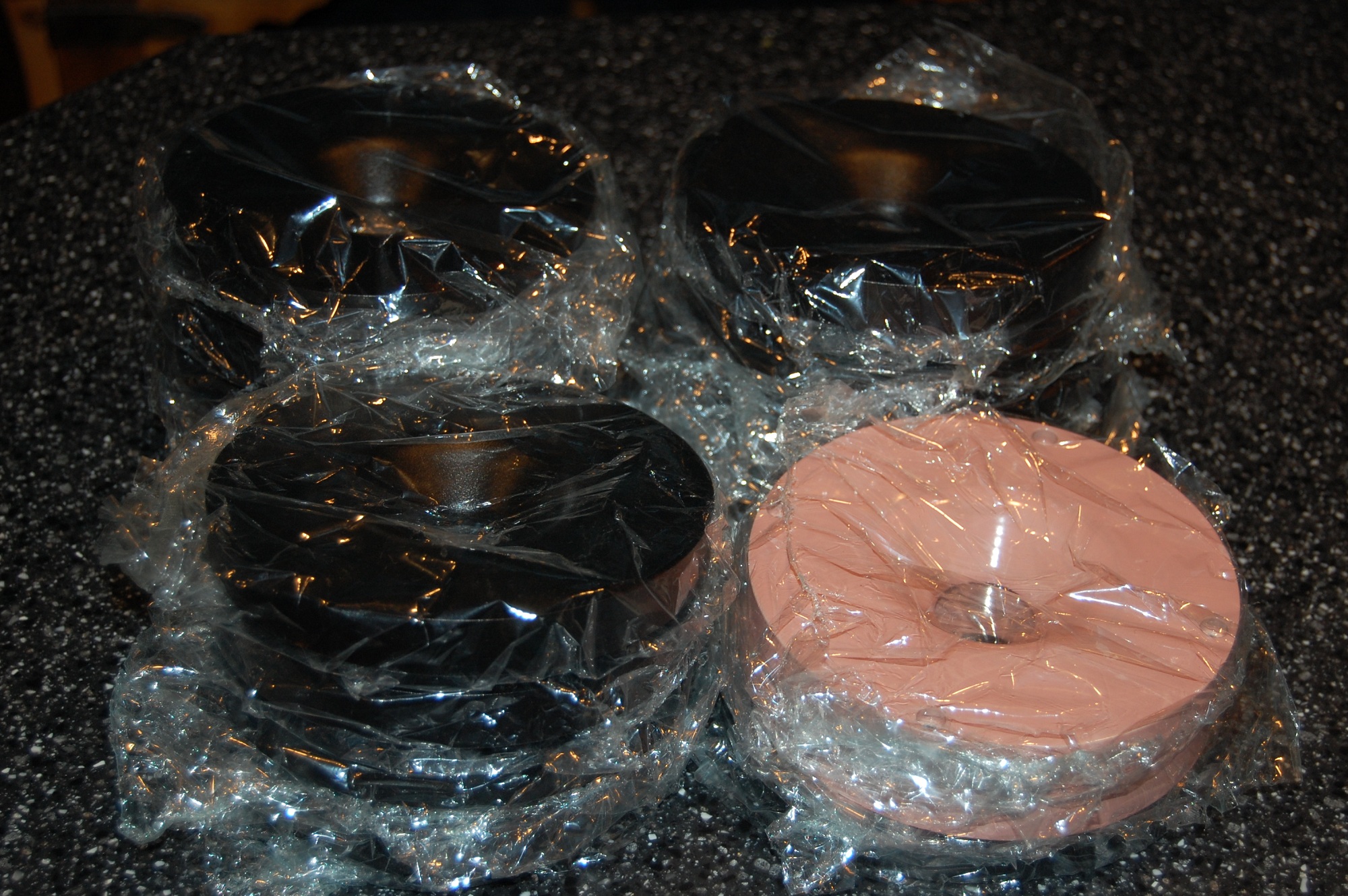

Some delays at paint. Expecting Painted Waveguides this weekend.
Joel
Picked up Painted Waveguides today. Shipping info to come

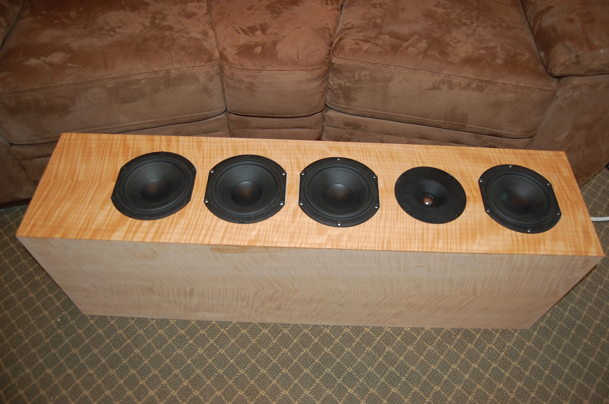

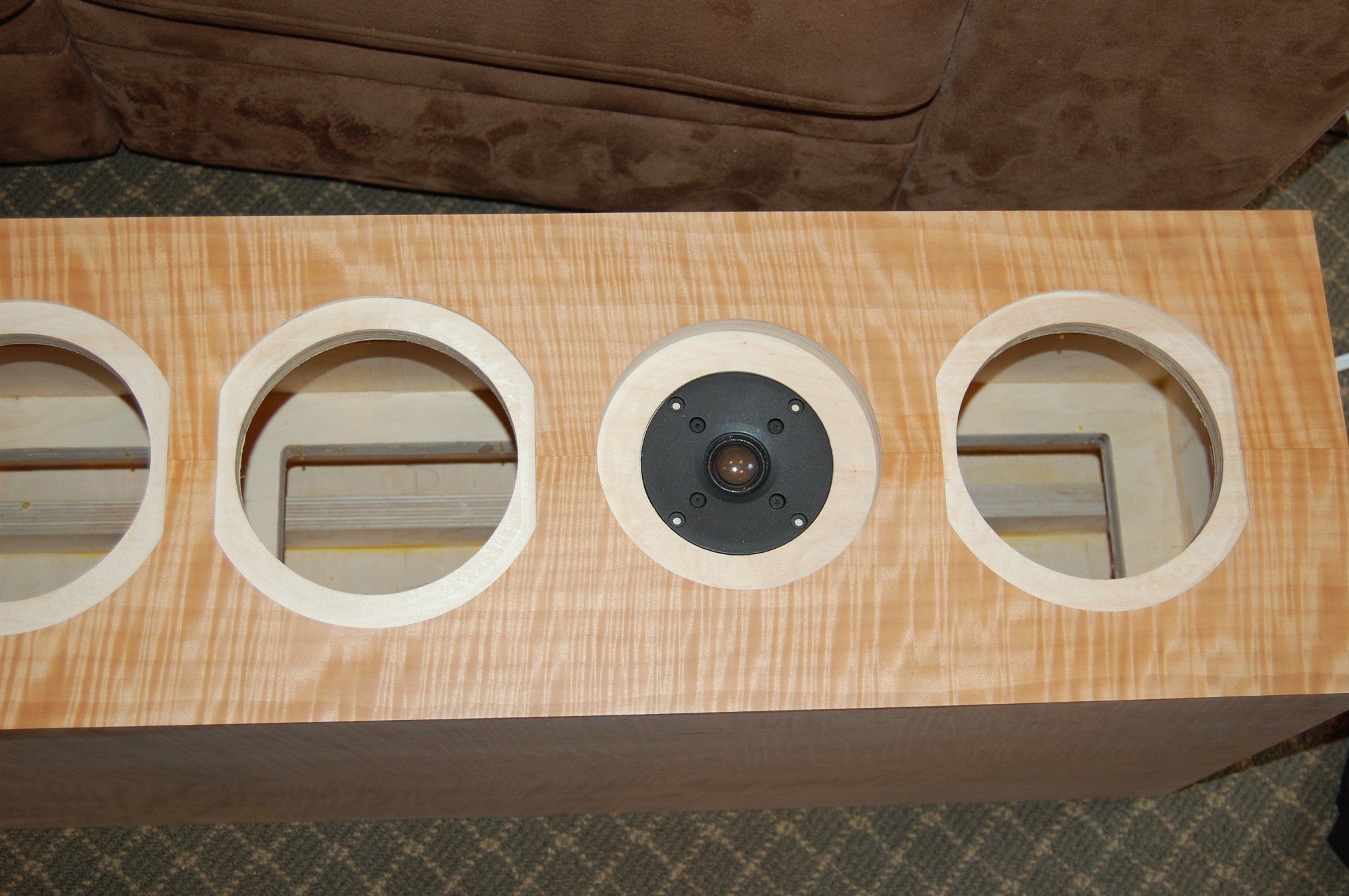

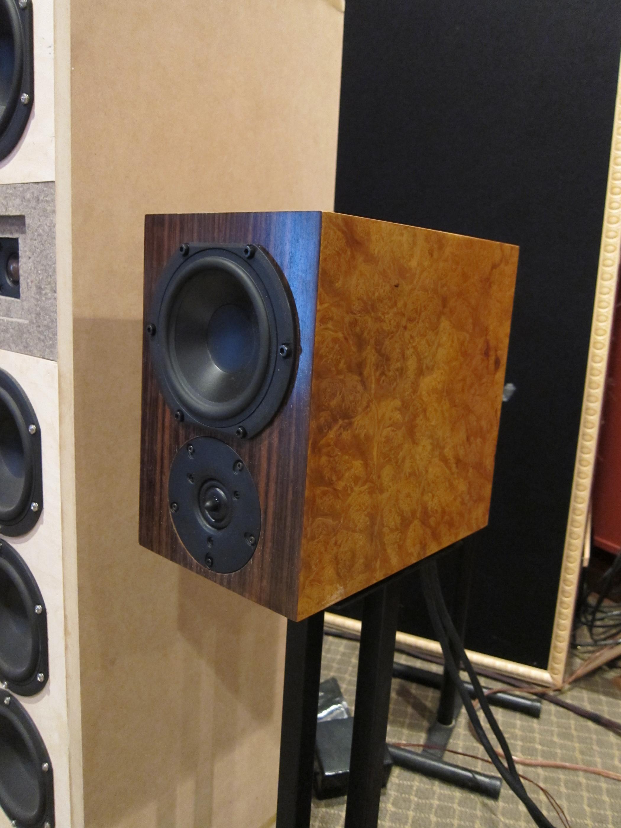

Pair of New Cabinets, components recessed with CNC Template. Tweeter and waveguide machines to the correct depths
Note on installing waveguide. Pilot holes need to be centered very accurately or srews will pull the waveguide off centre. Also best to drill out the top of the pilot hole with a larger bit to a depth of a few millimeters so the screw wont lift up the top surface..

Beautiful work Joel! Curly figured maple? The seams between the veneer sheets turned out perfect. Absolutely stunning.

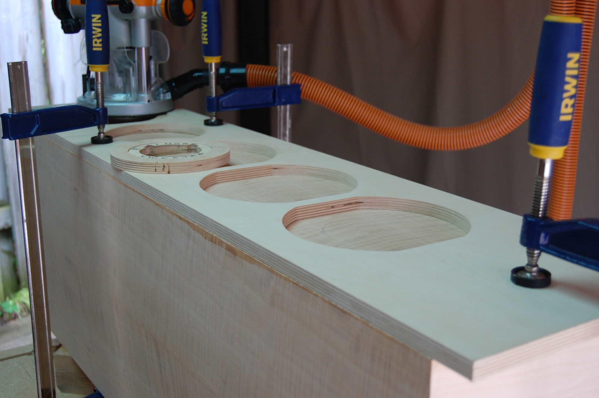

I am using 12mm ply.
I plan on building a box within a box. The outer box will completely overlap the joints of the inner box. The inner box will be butt-joined, glued and reenforced with cabinet screws. The current plan for the outer box is to butt-join and glue to the inner box. Although, I am always open to suggestions.

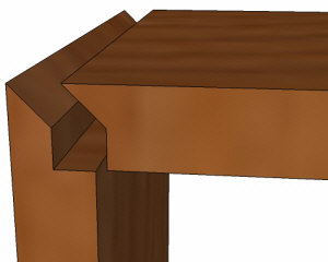

You dont want to veneer over the plywood end no matter how flush/sanded it is.. The end grain will telegraph through the veneer over a six month period.
The picture shows one solution. hardwood corners work as well.
The front of the Elsinore is a little harder.

It looks like a 45 degree with a 90 degree or two. Use solid wood on the front.
John
You said
I am planning on using 3/4 plywood for my build. Is this your "one solution"?The picture shows one solution. hardwood corners work as well.
