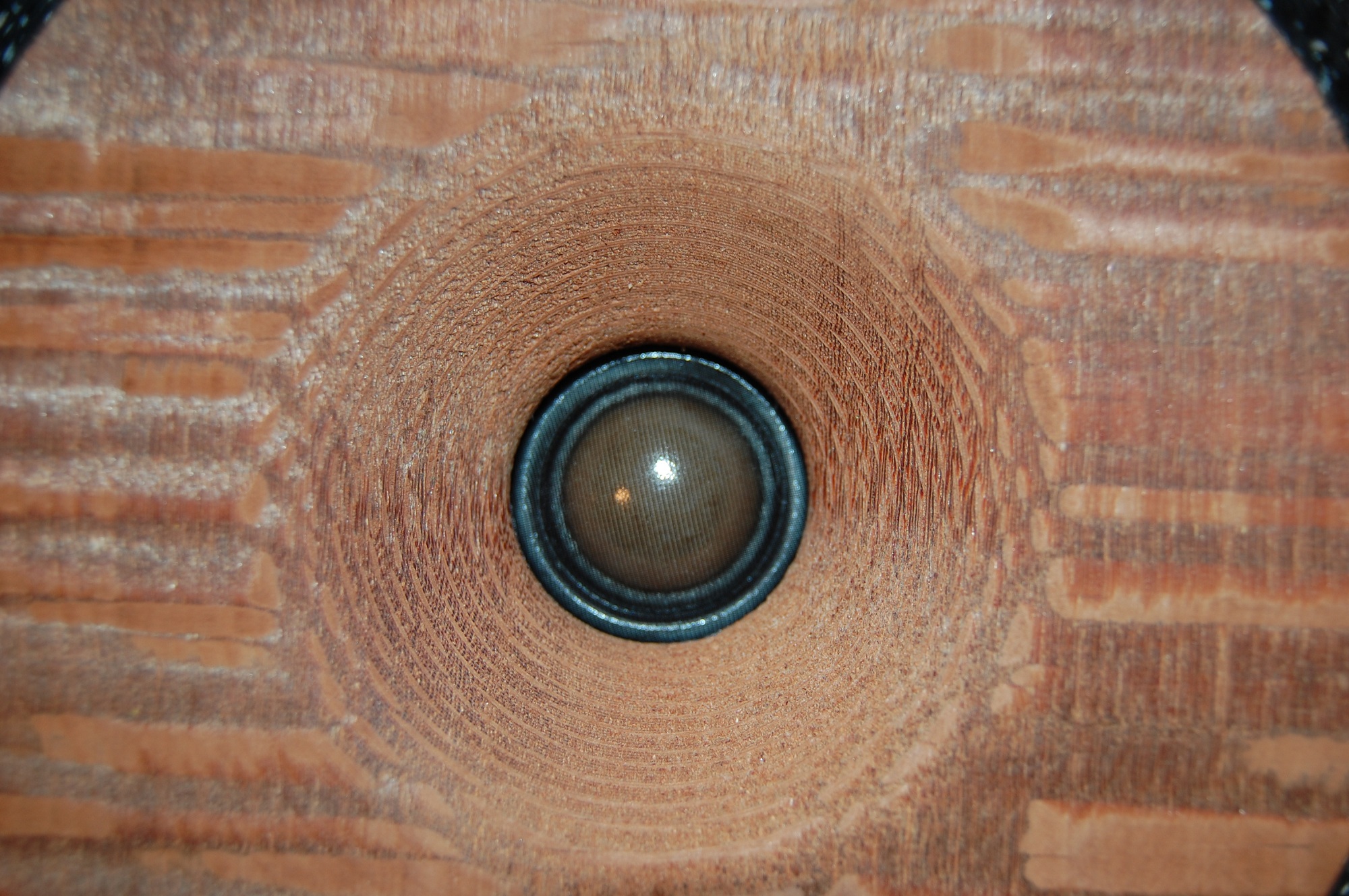

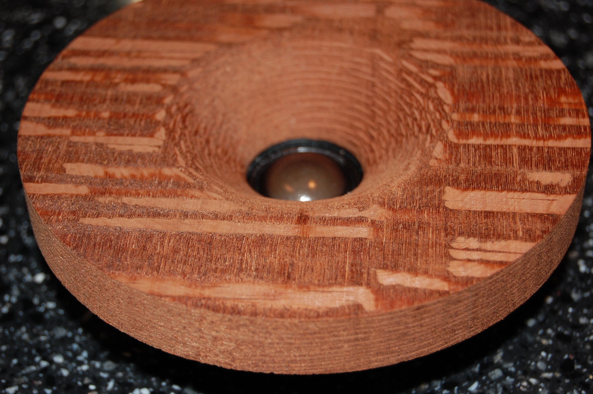

Can we see a closeup of where the waveguide meets the tweeter?
Tried some a few wood species.
Lacewood close up

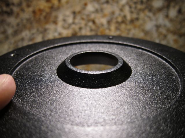

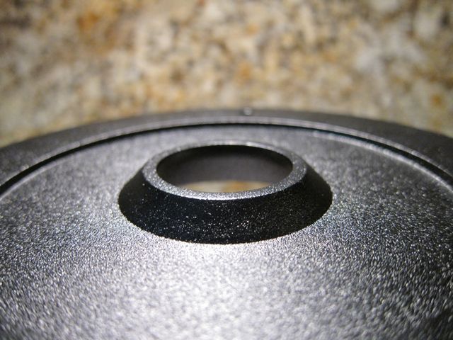

I think I can handle that.
I received the waveguides from Joel today. Wow, am i impressed! They turned out spectacular! They are quite substantial, more than I expected. The powercoat is first class and really lends a professional touch. Hat's off to Joel for the superior effort and outstanding turn-around/comms (Thanks again Joel).
In any case, here ya go:

Thanks. The plumbing slip couplings I found were a bit undersized. The 3" electrical coupler I got from home depot is ~3.5" ID (90mm ID) and 88mm in length. Once the center ridge is eliminate, it should be perfect. A 4 and 1/8 hole saw (105mm) will be just about right if not perfect for the outside diameter.

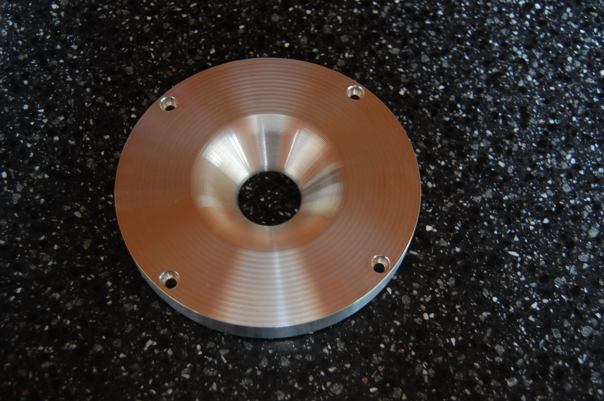

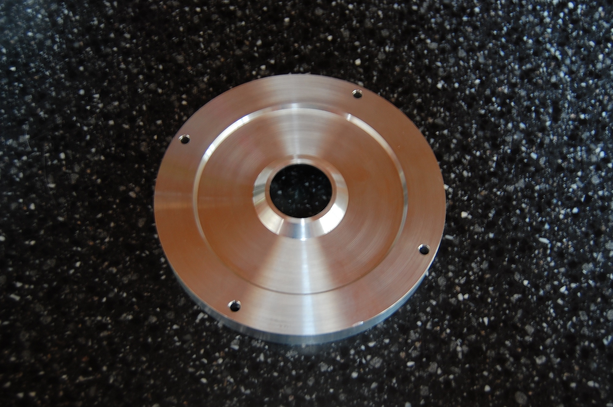

Waveguide Purchase 2 Invitation
I have one pair of Aluminum Waveguides for my speakers.
Notice 2 small changes:
The rear pocket finishes with a taper to alow for one set-up in the lathe.
The screw holes are moved close to the outside.
This pair was machined in a way that I will now use clear Powder coat for this pair but can paint a batch black as well. Personal taste here.
Note: There has been inquires. Maybe some, understanably, dont read all the posts but I need 5 pairs paid up front to make it work. $160can/pair
I can wait until the end of next week(June 5) if anyone is interested. The machinist can start the following week.

I'm going to clear coat the only pair I have left and use them in my speakers.
I'd like to see how they turn out before I can offer them.
I've spent some time talking with the powder coating guy's and also viewed numurous painted car parts of different colours. The clear will have the same durability as black and guys are polishing aluminum engine parts and clear coating them.
To explain a bit more: The first Waveguide batch was machined with minimal lines and black powder covers them. I like the aluminum look but they would have to sanded and polished to have them look good in clear. The car guys warned me that polishing metal for clear coat takes hours for a small piece, so that makes it impossible.
The machinist had the idea of doing a pair with nicer visible lines and then embrace the lines with a clear finish. See how it turns out.. Should have this figured out and show them before June 5
