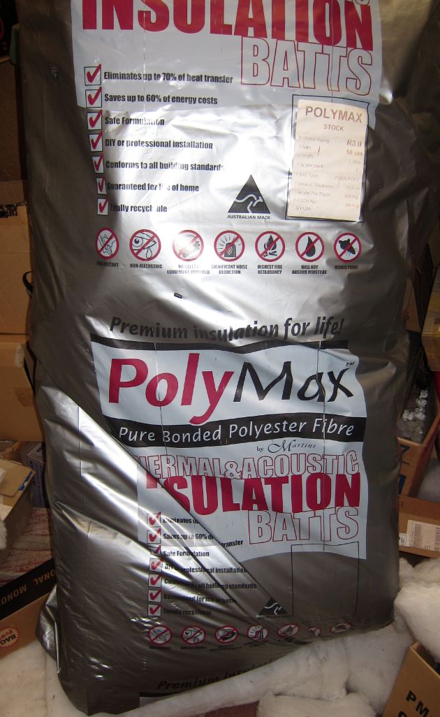

Re Damping Material, Can you get your hand on this:
PolyMax, Pure Bonded Polyester Fibre by Martini and rated R3.0
Note it is "acoustic" in the title description: "Thermal & Acoustic Insulation Batts."
Got the whole bag for $80, so plenty left over for other projects or helping others. This stuff is easy to work with, not hard on your hands and what I am using now.
You could call him on 0414-371163 here in Sydney and he may be able to tell how much to send to WA o maybe even better help you to find a place in WA that has it. Maybe he could give you Martini's phone number or where he orders it from.
If you call him, I seem to recall his name is Dave, Dave Burnett, let us know here how it worked out.
Cheers, Joe

Hi Joe thanks for the info,
as it turns out i have spoken to Dave before and he put me onto using Autex QuietStuf Acoustic Insulation bats witch are available from bunnings in WA.
The cook is flying to Perth in a few weeks so i,ll get her to pick me up some.
Autex stuff is available in R2.5 100mm, R2 90mm or R1.5 75mm thermally bonded 100% Polyester. So i,m figuring the R2.5 100mm stuff will be a good substitute for the original 75mm Wool /Dacron blend.😕
http://www.autex.com.au/files/files/662_Autex-Data_Sheet-Quietstuf.pdf
Cheers Paul
