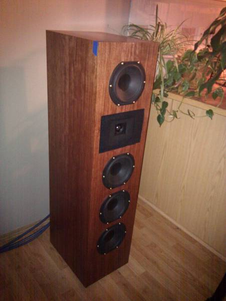

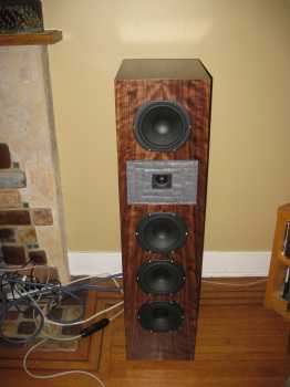

My brother built the cabinets and did the veneer in french walnut. There were 3 items we had to make adjustments for because we could not find the proper materials.
1. Was the port tube, which I mentioned in my previous post. I believe the measurements did fall within Joe's specifications on this thread or in the fact section on his website.
2. For dampening material I used Extra-loft polyfil stuffing that is used for making blankets. I purchased it at Michaels( a craft store) The material comes in thin sheets about 6mm thick. I cut out the pieces and and sewed Them together. I used 12 pieces to achieve the 75mm thickness! PITA.
3. Could not find the right thickness of Felt, so again I sewed a bunch of thin pieces together. I used 10 pieces for each tweeter.
I am very happy with them. I still can not believe how Dynamic they are!!

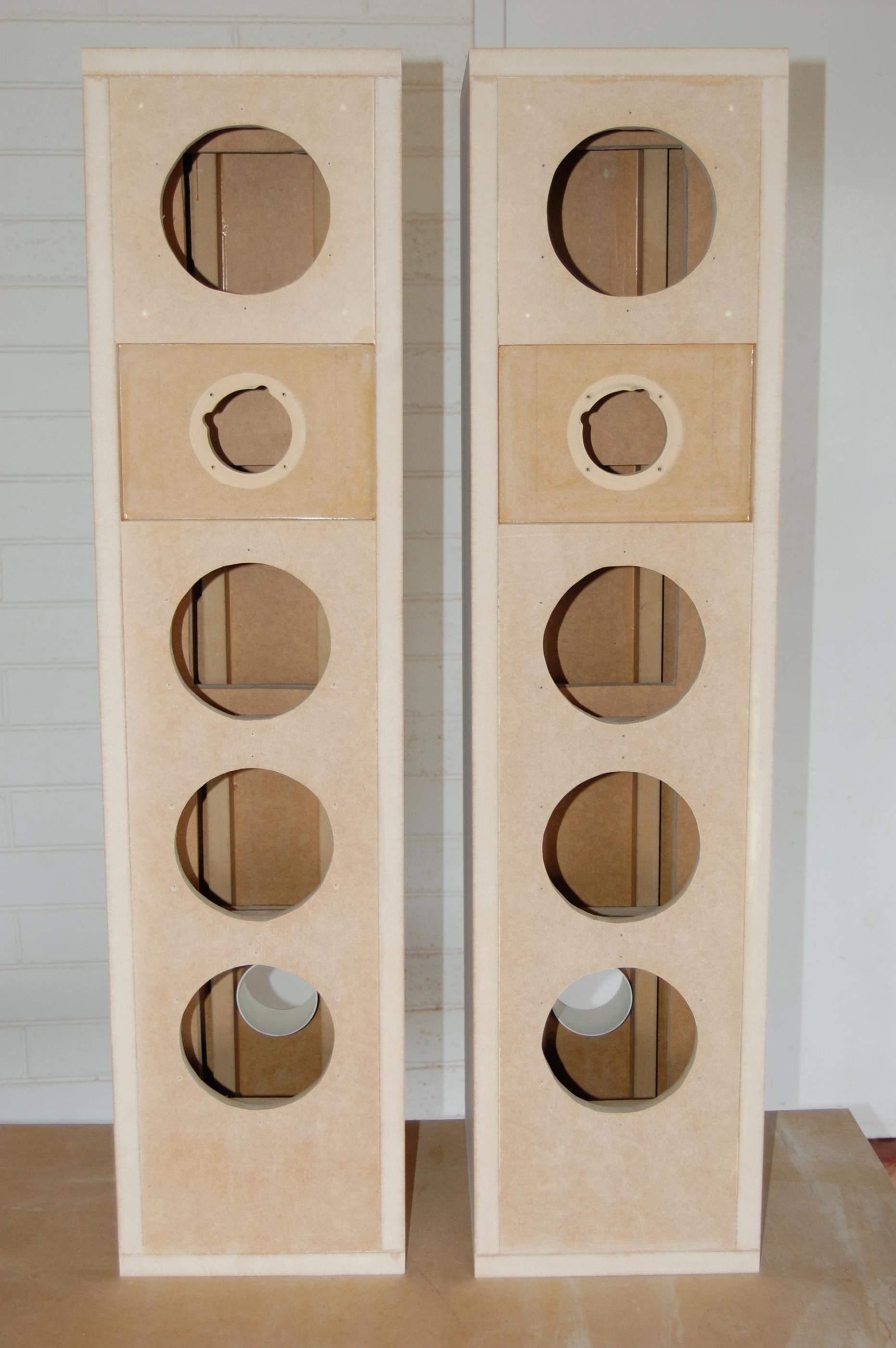

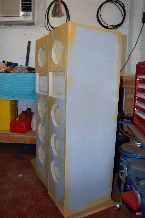

Yep no worries i have the cabinets primed in 2pak and rubbed down with 800 paper.
To get a decent painted finish on MDF requires a fair bit of work though.
Once Joe has finished, and i can get my hands on a new waveguide i,ll be looking at finishing the the paint on the cabinets along with the mark 5 crossovers.
Also still undecided on the damping material to use from whats available over in WA, postage costs are over $100 for a Bag.
What would i of done different ? After reading the 66 pages of this thread yet again wish i had sourced the HDF for the front panels i think this would be make a noticeable improvement.
Cheers spoonted
