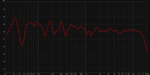

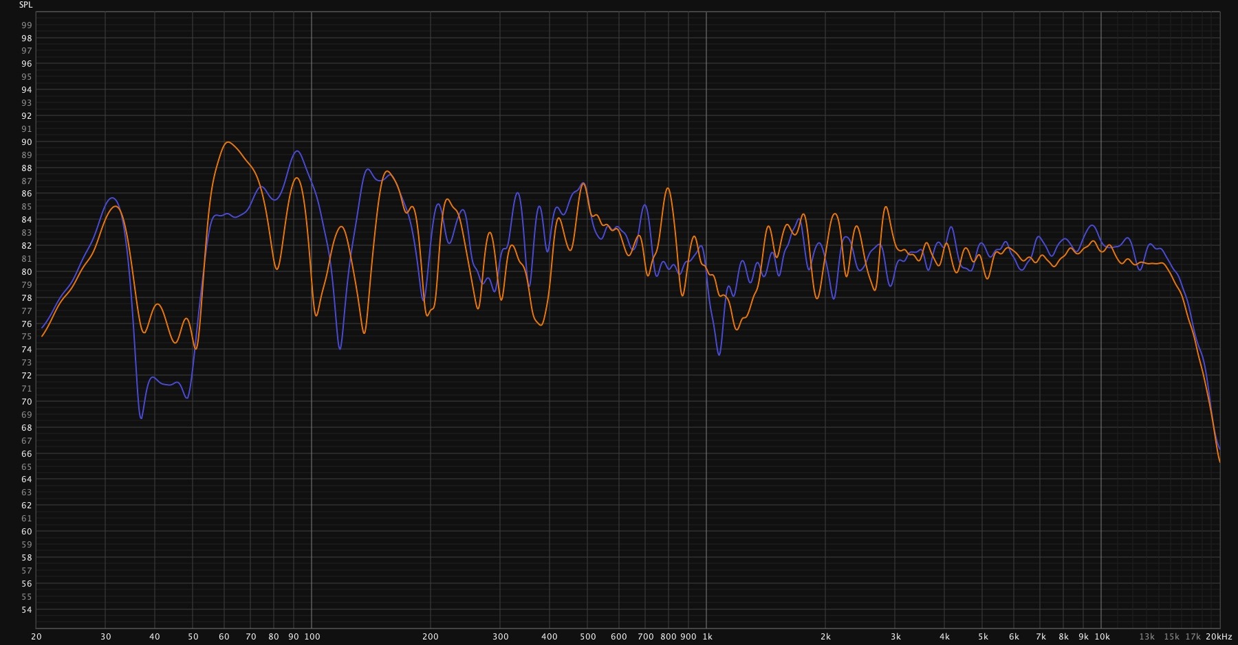

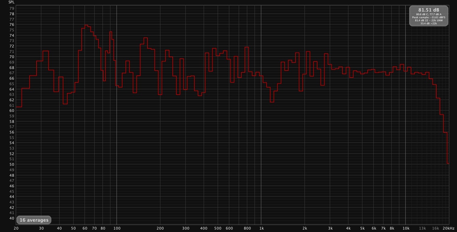

I don't think I will get much more from this set of speakers. Although I admit that the effect surprised me so much. Of course, in a positive sense. Sound very nice.

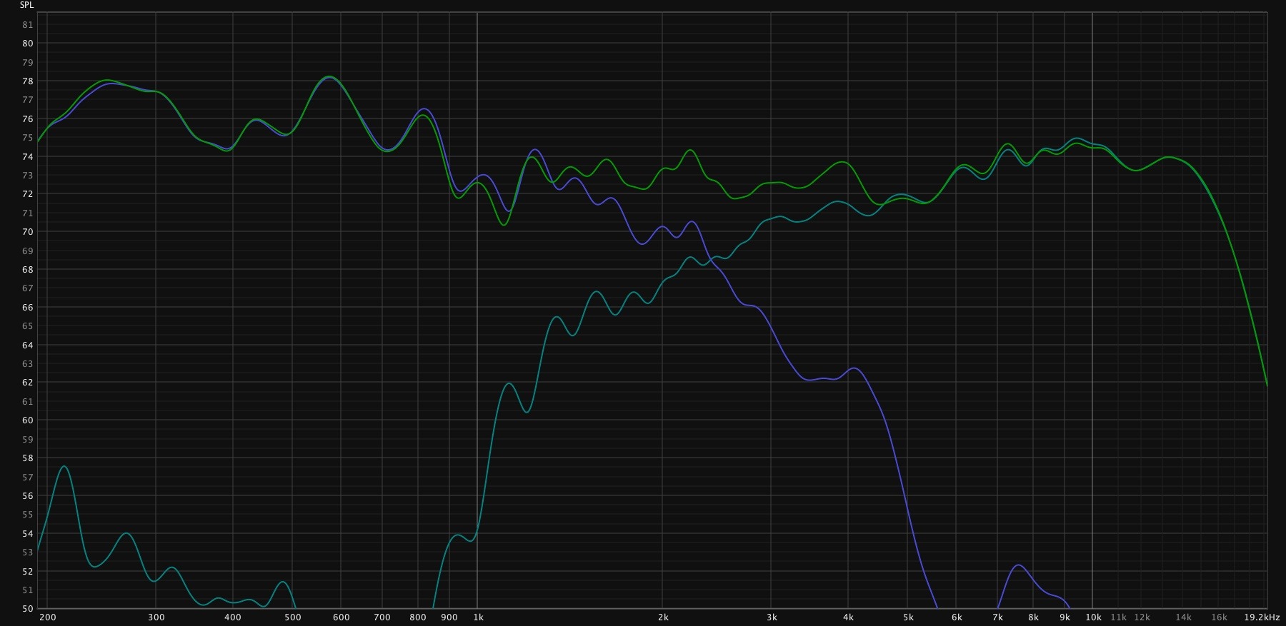

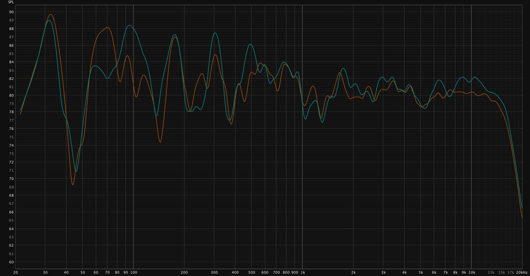

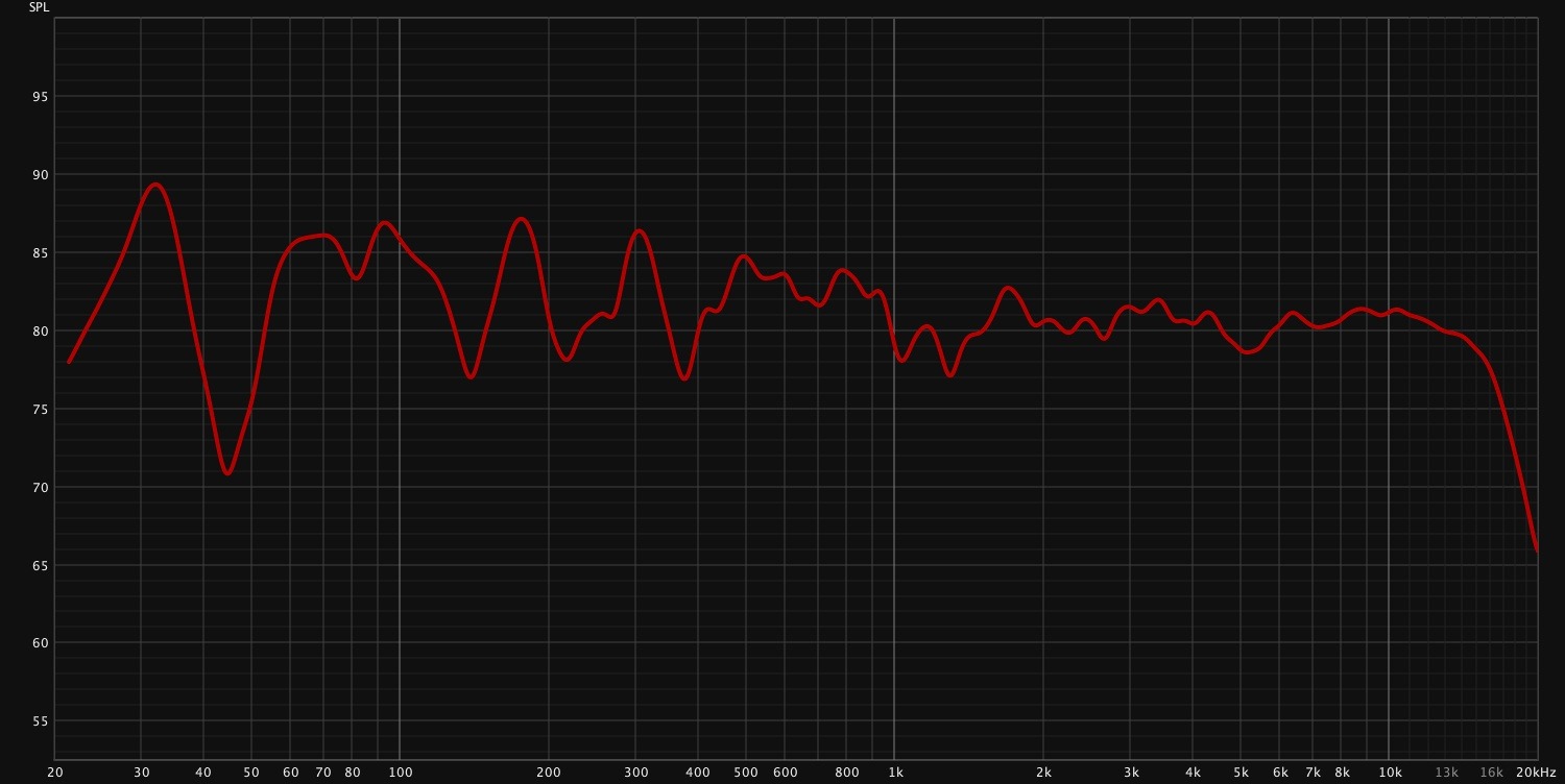

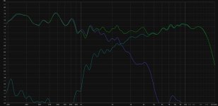

The final changes I made after free space measurements are very subtle. I decided to respond to the diaphragm resonance at around 4kHz by inserting a notch filter. I also changed the damping of the tweeter.
I still haven't connected the impedance correctors to the circuit.

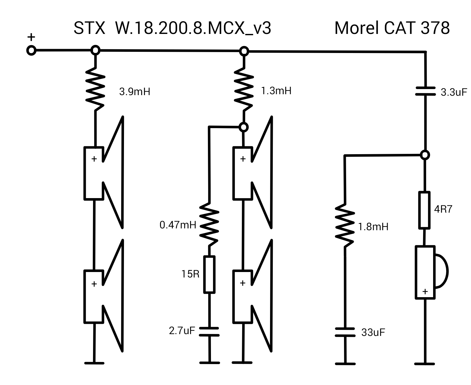

Crossover layout:

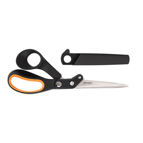

Use a really good heavy duty scissors, I use these:
https://www.bunnings.com.au/fiskars-203-2mm-8-amplify-scissors_p6010587
These are good to have in your tool box for future work too.
How you keep the cuts straight? I have developed my own technique that would require a video and a lot of hassle and it mind not even suit you? But you can find a way, the key is good scissors to start with.

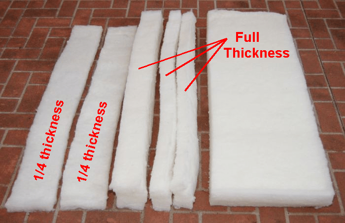

The inside lining in front of the Main Brace, a sheet 160mm wide is cut. Then it is cut into two layers, that is halfway thickness. These are the both also cut into half thickness and that way you end up with the required 4 layers/pieces, about an inch thick. Clean them up with the scissors.
I have my way of doing it, but try to work it out yourself.
The five pieces on the left does one box - some needs the length cut as per below:
2 x 1200mm High, 160mm Wide and quarter thickness). Used as Front Damping
1 x 850mm High, 110mm Wide and full thickness. Used as Centre Rear Damping
2 x 1100mm High, 50mm Wide and full thickness. Used as Corner Rear Damping
Double for second box.
Hope that helps.
