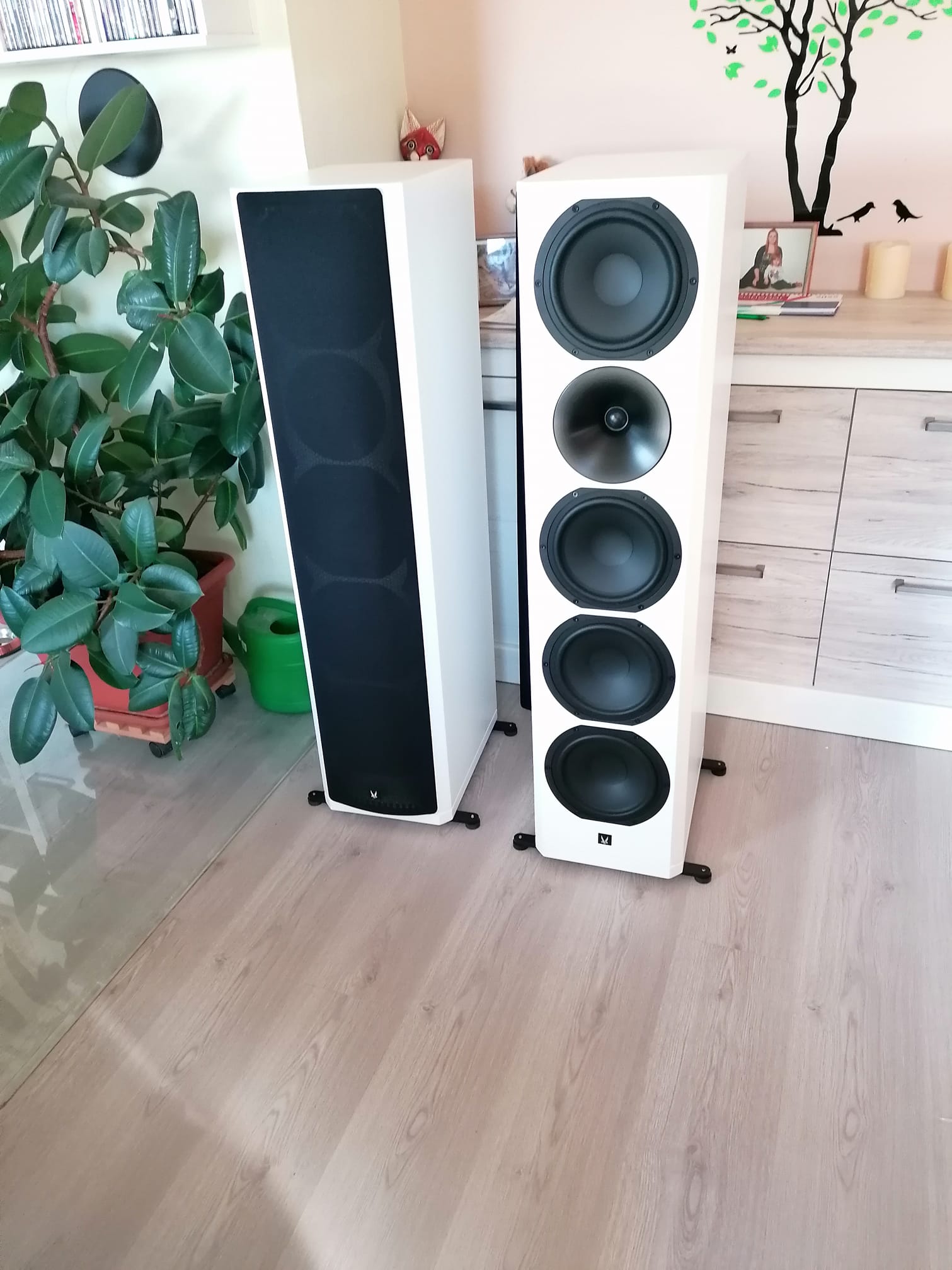

looks like Elsinore siblings from gen V with peerless woofer. but when i look at it's price $1.5k/pair and shocked. reallly? do they make profit with that price? i think even if diy effort to
get that finishing will ended around it's price

I can't see how they make money. I spent too much on crossovers, but the Mk6 I just finished will put me close to $1700 USD

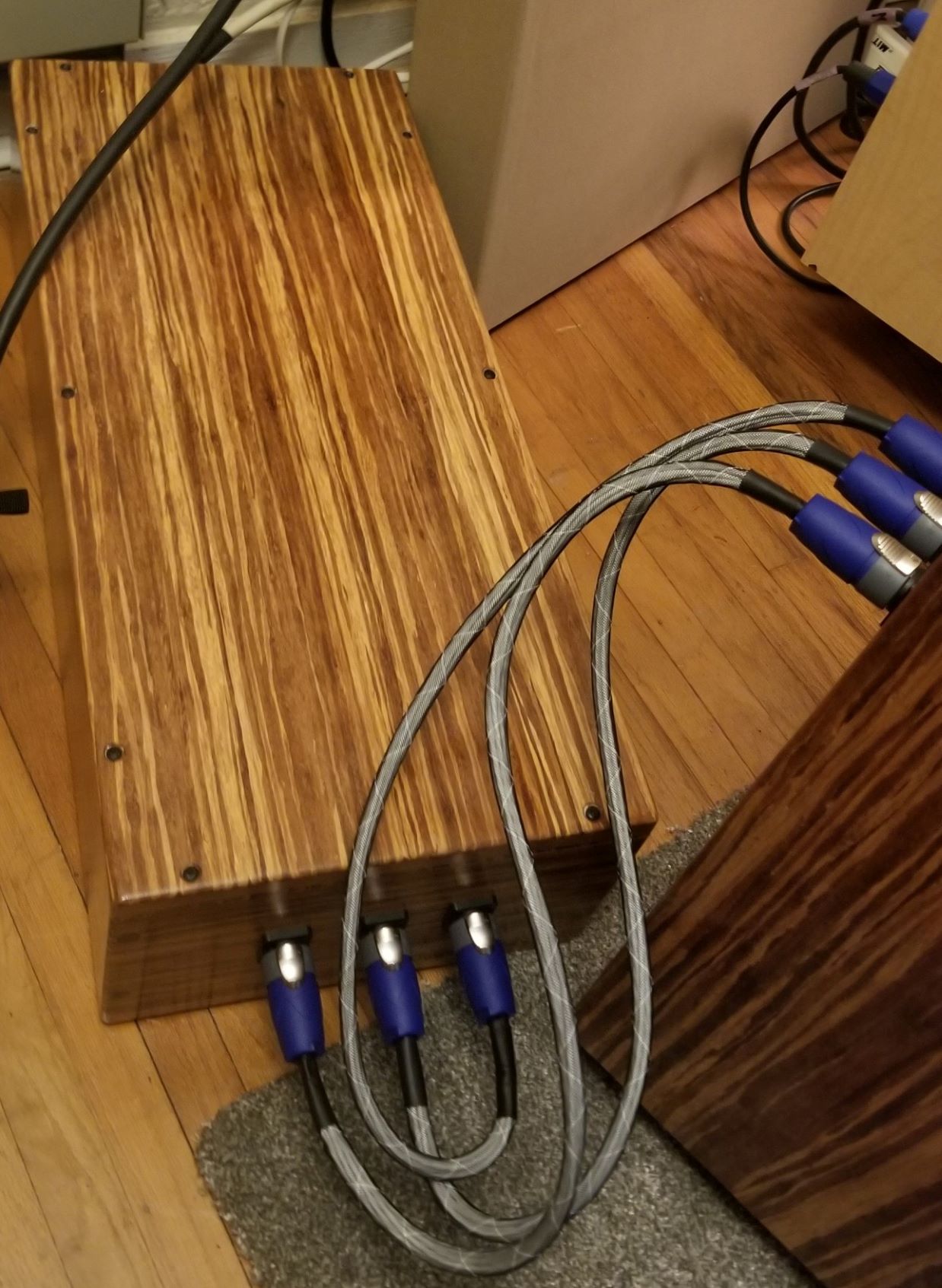

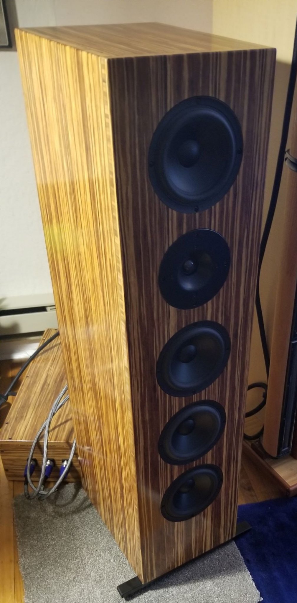

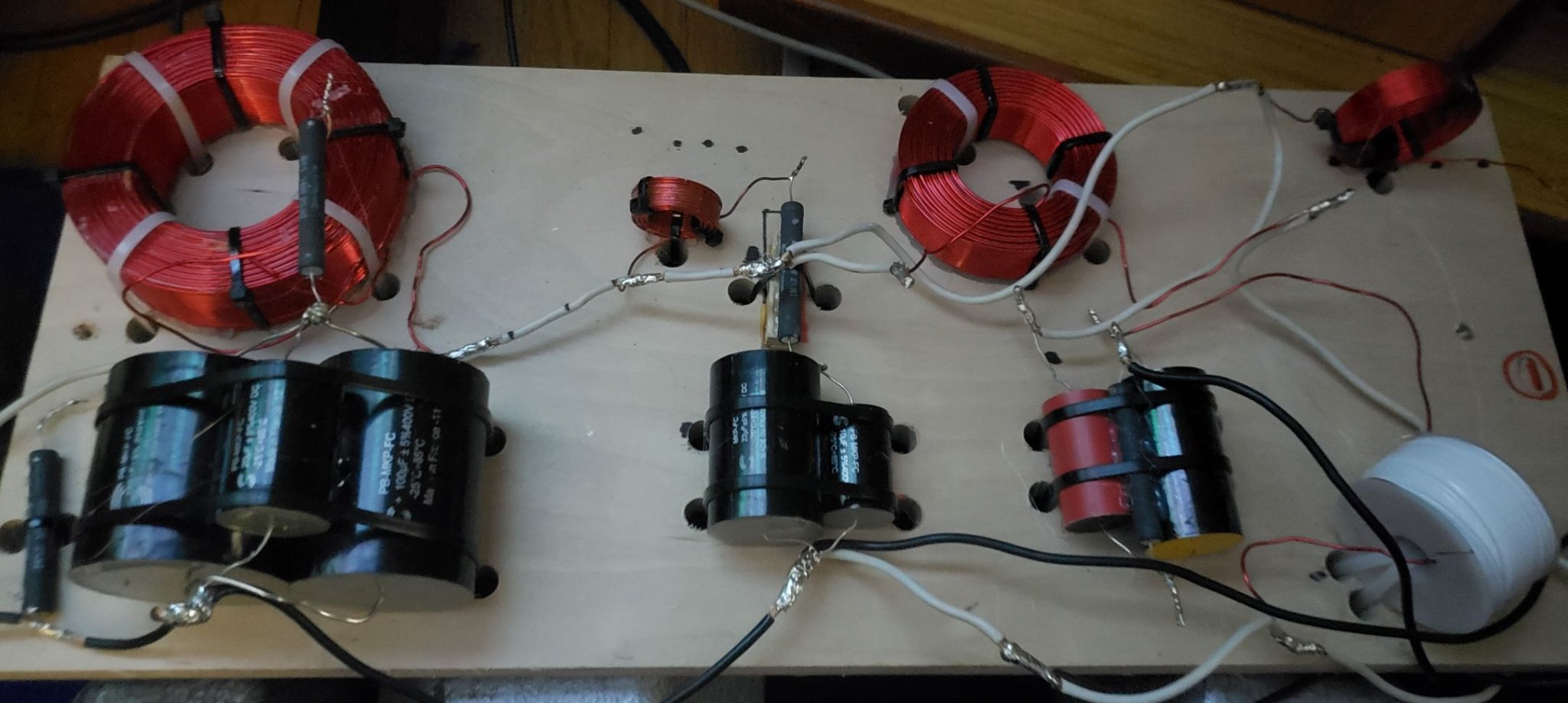

Solid Bamboo Ply? Looks great. I have solid bamboo ply waiting for me to decide on the MFC or Purifi.I just finished a pair of Mk.6 with the MFC woofers. I overdid it on the crossover components and spacing, zero doubt.
They sound great already, very well balanced. Detailed, but not harsh. Good at low volume.
After I clean up a bit I will really give them a go!
View attachment 1029602View attachment 1029604View attachment 1029603
Looks awesome. In a pair of speakers I built, I put the tweeter, mid and woofer on separate crossovers and mounted them in the cabinets. Worked out well. I would recommend two or three sets of binding posts as it was complex getting them in there all tied together. Could of used the binding posts as a junction I guess. Ugh, hindsight...I just finished a pair of Mk.6 with the MFC woofers.

Congratulations on completing the build - the bamboo ply cabinet looks very nice.
Please share more listening impressions when you have more hours on the drivers, and have spent some more time listening. 🙂

How did you finish them? I'm planning on a clear sealant of some type.Yes, solid bamboo ply! Was really nice to work with too. Even the smell when cutting was nice.

Very nice looking Elsinores! How are they sounding, and what did they replace?

Finished with a few coats of a honey maple stain, then about 8 coats of polyurethane.How did you finish them? I'm planning on a clear sealant of some type.
I then buffed them with a 2 stage automotive compound. I really should have spent more time sanding as there are still some defects I can see in the light. But overall, very happy.
