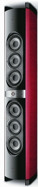

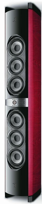

, how cool would the Elsi's look if they had another two drivers on top making them a WWWTWWW
, and what if the front baffle was curved so they were all time aligned properly as well
(Yes, I often come up with brain explosions when I've had a few medicinal beverages).
