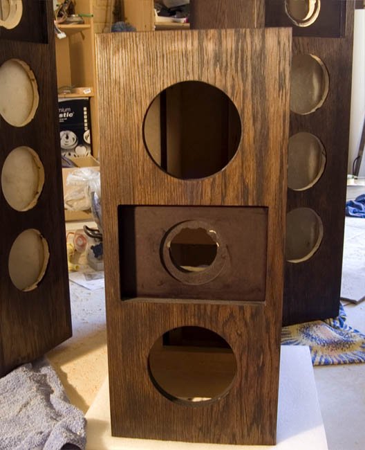

Right im 90% there (or maybe not :/ )
Got my Elsinores including center (hamlet?) all built, and am just putting the final coats on. Finished using American Oak veneer and have just completed a two part stain (spirit based black stain followed by Black Japan stain).
So far so good, just have to apply a french polish followed by satin polyurathane topcoat and then install drivers!! yay.
Since im so close i though now might be a good time to get an order in for the components required for the crossover and since ive got a centre im hoping to get an idea as to what values are going to change.
Do the values on page four still stand?
Change L2 from 1mH to 1.8mH or 2mH (main diffraction correction)
Change R3 from 3R to 6R to 8R (this changes Tweeter attenuation to -6dB)
For C14 use 2.7 to 3uF (the 8R2 larger value changes rollover point - this is the correction) Leave the optional values in the Conjugate Filter as before.
The one value that needs to be tweaked by ear is R3. Try standard values 6R8 and 8R2 and some value in the middle of that.

as promised heres a pic of the baby speaker (though it still weighs a far bit). Is pretty hard to get photos to show all the detail, so this ones a little over exposed, and in reality they appear much darker (purposely designed this way as its going to be placed in a ht room with a projector).
