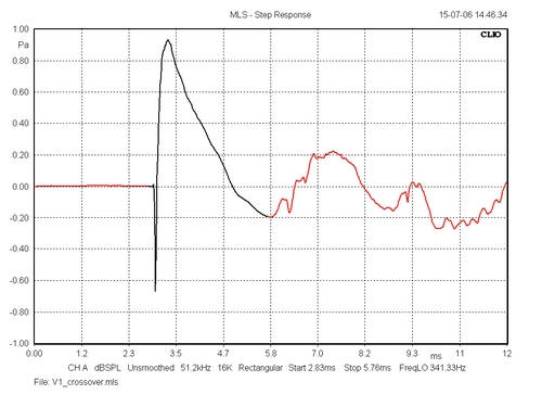

I am also sending an email to Troels. I want to comment on his latest (I think it is) project, the www.troelsgravesen.dk/SBA-761.htm. He calls it 1st order, it is electrically but it is not Butterworth, look at the tweeter phase and it has reverse phase and it shows he is doing it the same I am.
The step response would look similar to this (ignore the trailing red):
But the one thing that stands out is a single series inductor to the driver that handles the midrange, without any parallel with the driver networks, no Zobels. Bravo! In fact, the bass driver qualifies as the same treatment.
This is already the sort of thing we are doing in the Elsinores. Re the current EQ, this is the cherry on the top. This further suppresses what Lars Risbo has publically called "impedance modulations" and so do series inductors to drivers that now Troels is doing as well. It is very clear that he is happy about the sound that he is getting.

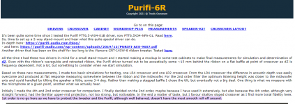

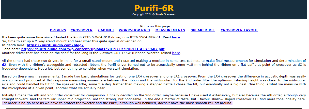

Troels does explicitly rule out 1st order filters in his Purifi 6R write up: “1st order is no-go here as we have to protect the tweeter and the Purifi, although well behaved, doesn't have the most smooth roll-off around. “
The two projects you mention, they are 2020 and not 2021, so they must be earlier. Never mind, no matter.
I am trying to find the page where Troels says that. Do you have the link? Is it this one:
Purifi-6R
Not there. Not here either:
Purifi_PTT6.5WO4
If it is, he has edited it because it does not say that anymore. :scratch:

Thanks, got it. Note the reference to "protect the tweeter" and that tweeter I agree with what he says. That ribbon tweeter has a lot of distortion at the limits of its passband - the lower end. This is why I have for the most part avoided them (I am not saying this is a bad tweeter). I have no problem with the roll-off of the Purifi driver. In fact, it is above average here, but in Troels mind, it is still not good as the SB MW16 driver. But then he said the same thing about the original NRX driver, which I think is worse than the Purifi in this respect.

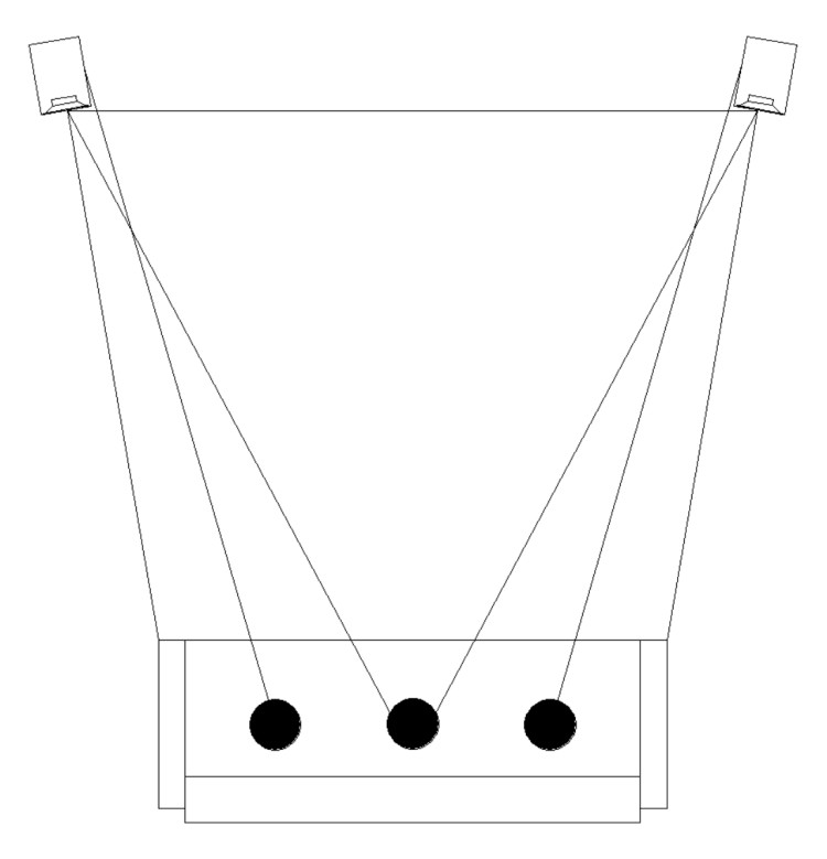

I have a test that I would like other testers to use. I call it then 3-Man Couch Test. It works especially well when the speaker is designed to be at its best at 15 degrees off-axis, which is how the Elsinore is done. It passes the test of three people seating gets the same frequency response within about 0.5dB - to pass the test it should not be more than 1dB.
attachment.php
Sitting on the couch and at ear height, there must be pretty much zero tonal change in either three seats. Note that none of the three listeners are hearing the speakers dead on axis. As one moves closer to one speaker, you get closer to 15 degrees, but never on axis. Whilst you are doing that, you are getting further away from the other speaker and further off axis. So as one gets brighter, the other gets less bright and the tonal balance in your head hardly changes. The measured deviation should be no more than 1dB. Use 1/6th Octave Pink Noise that is no-coincidental.
I can achieve this also with the NRX driver (the one Troels questioned) and I will do it with the Purifi drivers too.

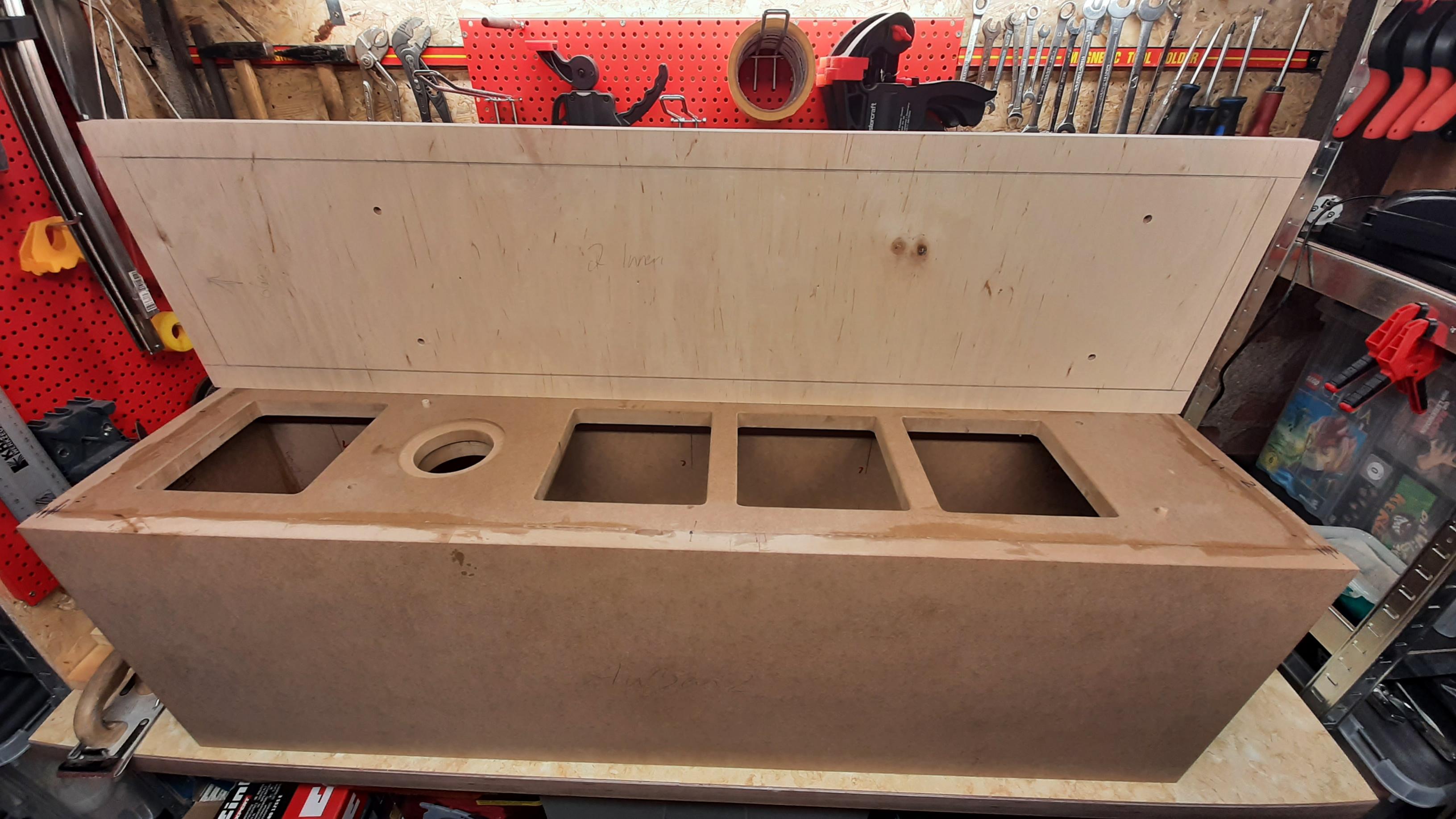

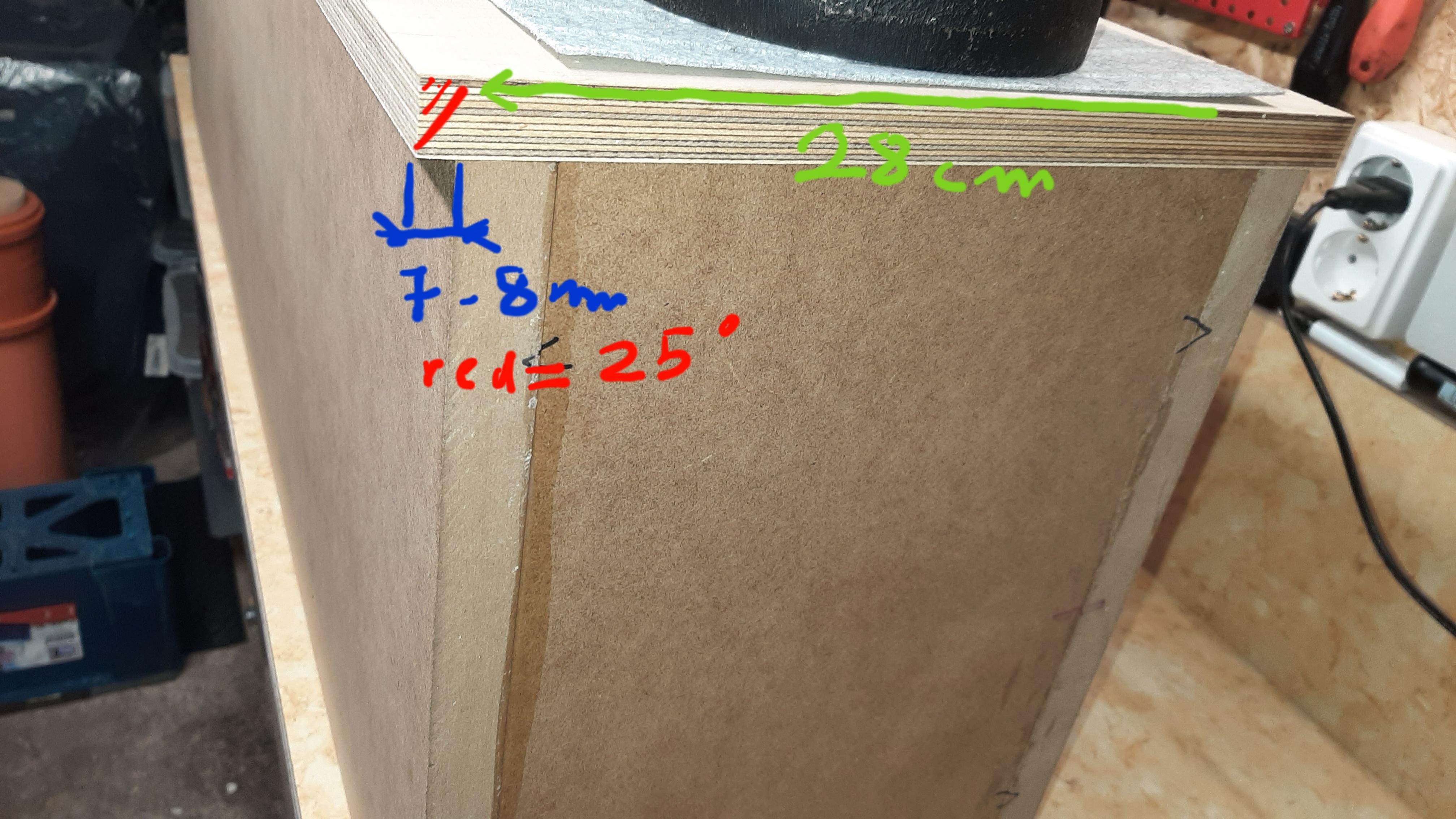

Sorry I didn't reply right away, so many distractions. I have no problem with the width of the Elsinores be 28cm and then going back 45° backwards rather that a 90° normal right angle. Does this answer your question?
hello joe, no problem, thanks for the feedback. Actually my question is answered. Could you still check the photo of my building again and confirm it briefly. I would only choose 25 ° for the router. best regards Steff
