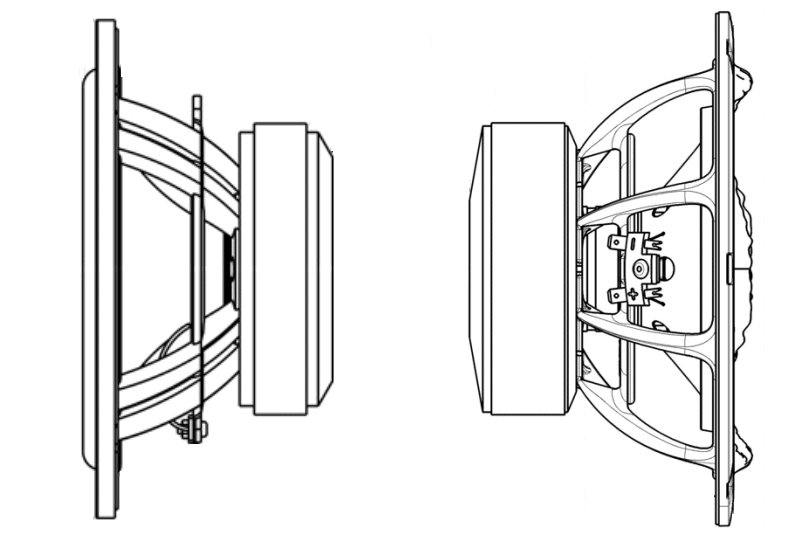

Ok then...now we know. Another question. I notice the Purifi has a tapered mounting flange and several designs I've seen show them surface mounted. Do you anticipate the drivers being flush mounted?
That is actually a good question and one that I have looked at. Look at the attachment (which I should be able to link into the text here), the drawing I have made, both drivers are very close to same scale:
attachment.php
As you can see that the centre of the voice, find the centre of the from plate where the gap is, and we can see that it is a bit deeper on the Purifi than on the SB17 driver. If you flush mount them, they are almost the same. So your answer is yes, there should not be a problem with that. It does simplify making the box front panel not have to to the rebating. It might also make it easier to convert a current EL-6 to Purifi, if some want to do that. You can make a simple (even slightly rough) filler that makes it flat and is hidden by the flange of the driver. It should not be beyond too many of the guys here.
What if we choose to rebate the Purifi drivers? The difference is still small enough not to make any real difference. So it is an individual choice.

OK, I have put you there. The Hamlet will be considered when we get the EL-6 "ULD" up and running. See the post above, how current EL-6 "MFC" and "NRX" boxes should be able to be converted to ULD without too much trouble. The length of the port might change, more likely shorter but maybe not, and some not too radical changes to the crossover.

Thanks for the information. Much less daunting for rookies to surface mount vs. rebating them. [Getting] better with my router.
I have not yet come across anything on Purifi's website, but it seems people have just seen pictures?
There is a guy called Carsten and he used to be with Peerless and the Peerless drivers we used earlier, they could also be mounted both ways. So maybe that is his influence talking? There is part of the venting behind the dustcap where Purifi does not use the vented pole piece like SB, where you can see a hole behind the magnet structure, the Purifi drivers use a different method and is the same as used by Peerless - and here Carsten's influence in the design is noted by Lars Risbo in a YouTube video. Sorry if this does not interest you, but it's more for nerds like me. 😀
