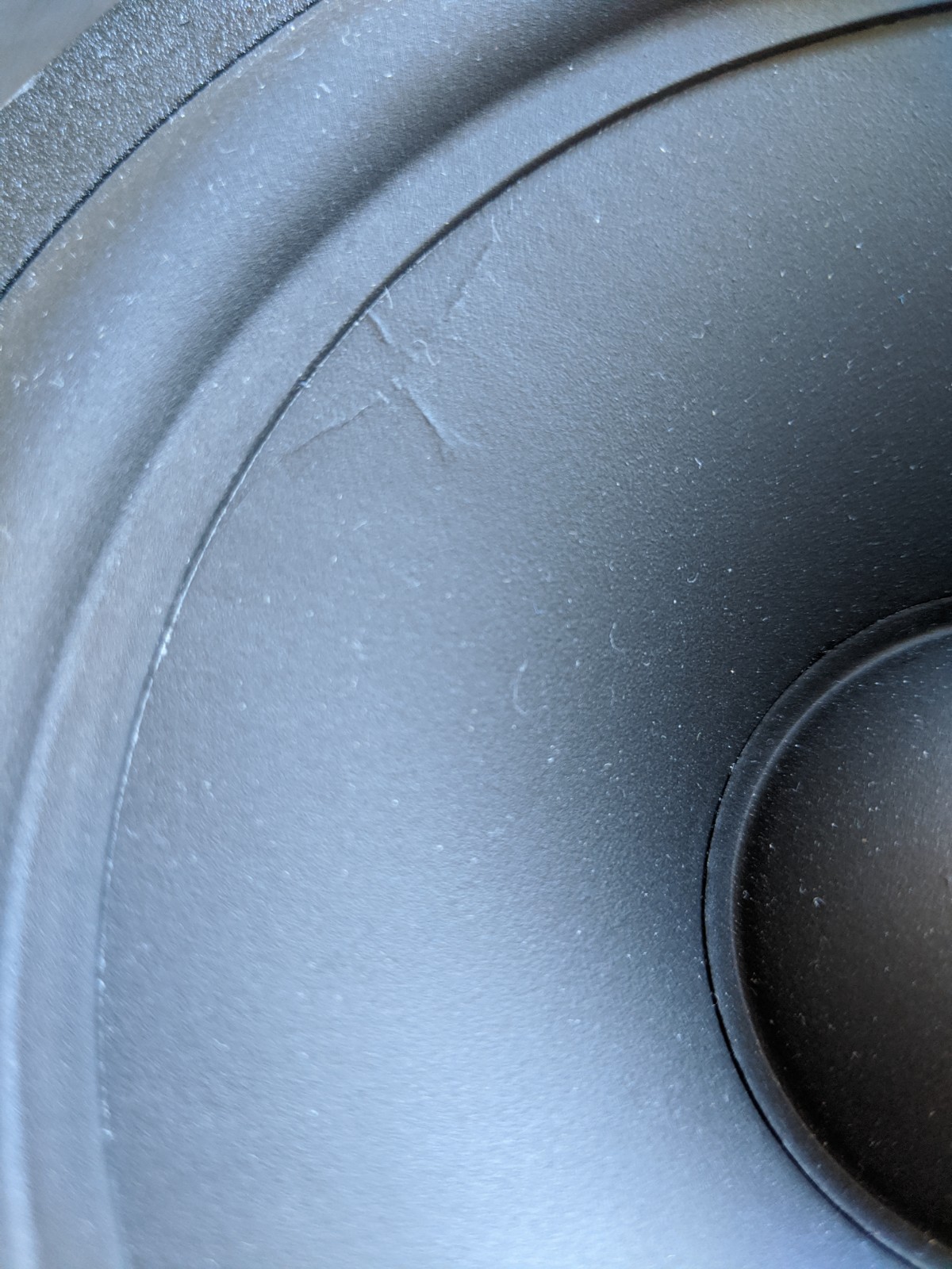

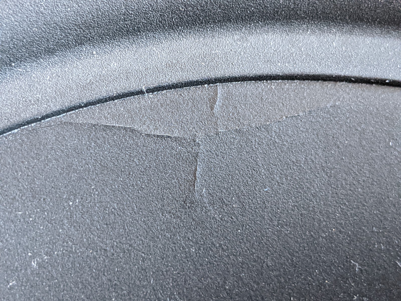

That crease is in an unfortunate location, i expect that it will affect the suspension.
dave
Thanks for your help Dave. I'll try to find a replacement then.
Hey 32yo, more pics?
Looks like a coating issue not a crease from that pic.
I thought about that too, but I think the picture just makes it look like that. I don't think it's a coating issue, especially because the crease is visible at the back too. I've attached some more pictures.

32y0,
That "crease" looks like a fracture in the paper - possibly happened at the time of manufacturing when handling the cone? Does the area look/feel slightly weaker vs rest of the cone?
My guess is a little bit of binding material applied around that area should be able to make the driver usable.

I have been slowly gathering all the parts for my build. Looking at the woofers today I discovered one of them has an imperfection to it. It might be a bit hard to see on the picture, but it looks a bit like a paper fold in real life. What do you guys think, is it still usable or should I try find a replacement?
Probably happened during handling when packing it? Best to get a replacement.
But, if you are stuck with using that driver, make it the one at the bottom of the array, nearest the floor. The bottom two drivers works mostly under 400-500Hz and hence within their piston range, which is to say that the cone moves as a whole together without flexing, which it does above the 'knee' related to its diameter.

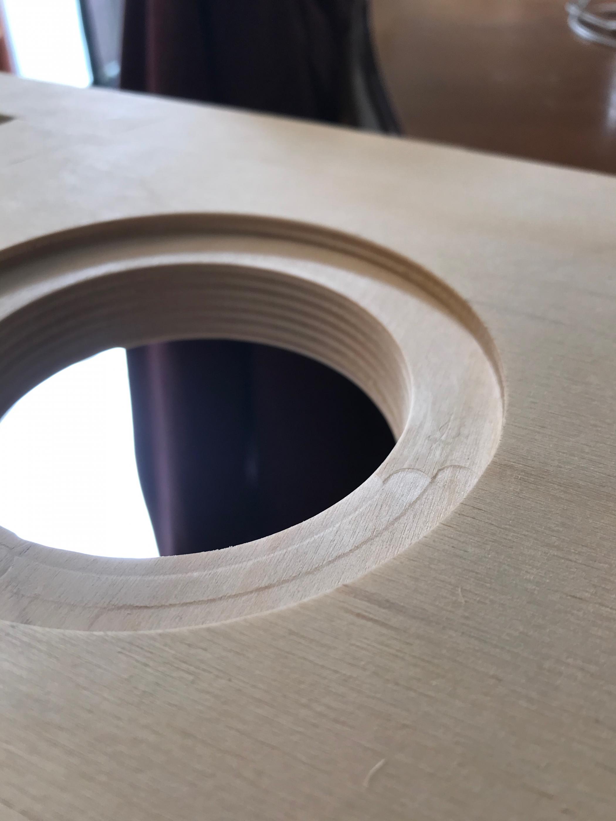

Have had some nice weather and making good progress on the construction. Spent the day cutting the speaker cutouts. :)

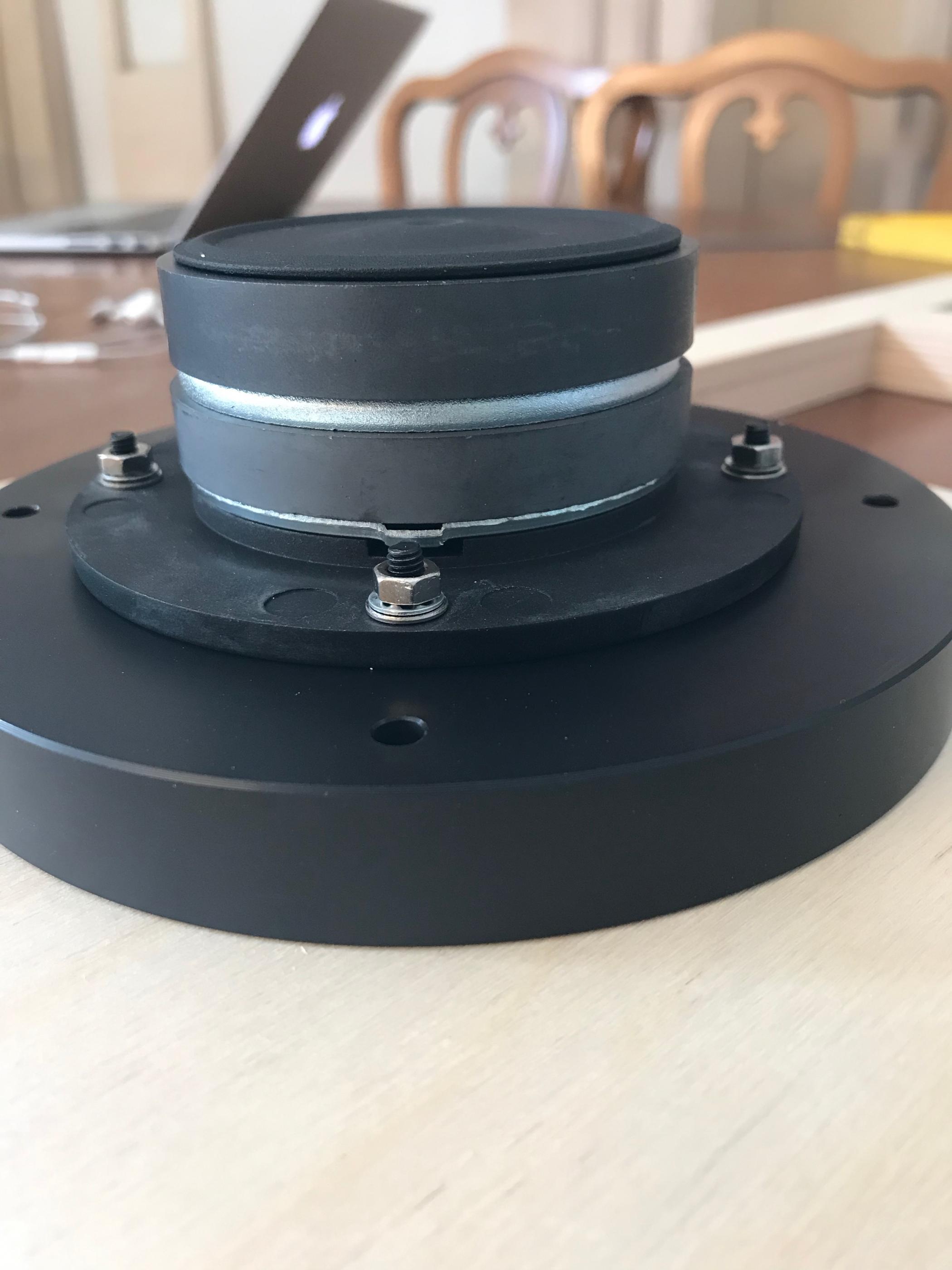

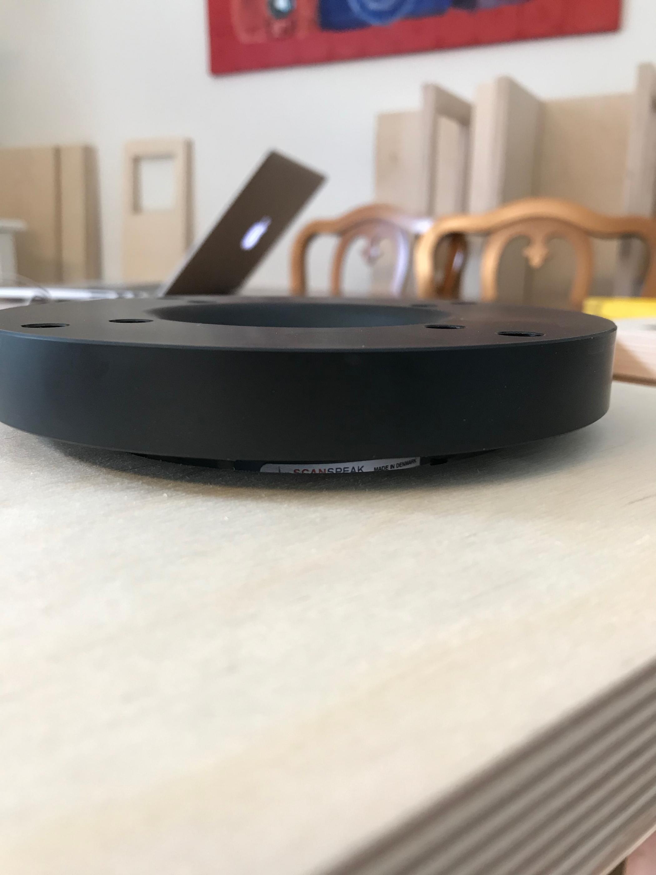

Noticed something strange with the tweeter sizing. I did the recommended 5mm flush mounting on the sub-front panel but it seems the screws provided with the waveguide may be too long. Should I just get a drill bit larger than the nuts on the screws and create some holes where the screws are? Did anyone else have this issue? Pics below.
