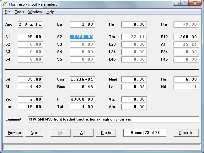

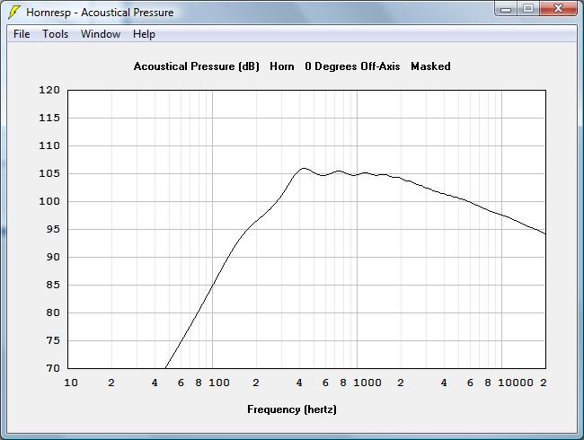

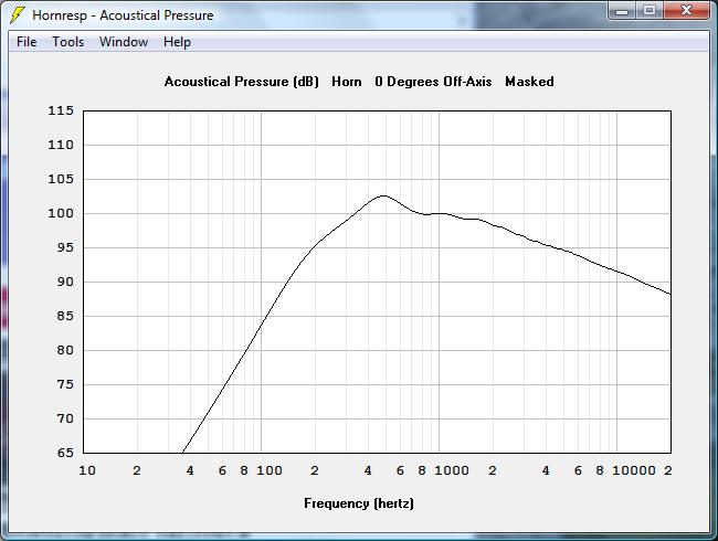

For mids, the Faital 3FE22 is excellent as is ScanSpeak 10F/8424. I have even had good success with a TC9FD. Because the horn loading is so good, you only have like 40micro meters of cone movement for about 100dB output. The distortion associated with such small movements is very low. The gain is typically 10dB so an 85dB driver becomes 95dB. The 95dB 5MR450NDY becomes a 105dB driver. You have to really be careful to wear hearing protection when testing these horns under any appreciable voltages. They sound so clean and distortion free that your hearing is not able to perceive “loudness” as that is tied to perception of distortion. So after a few sweeps at 2.83v, my ears were ringing.
