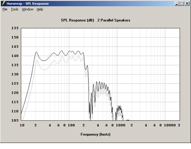

Quick update:
After looking at ported, front loaded horn, and tapped horn, the tapped horn is looking the best for efficiency and output. The first graph is 1vs2, the second graph is 2vs4 half space, and the third graph is the excursion plot at 976w.
More info forthcoming.
Here are the hornresp inputs:
ID=23.40
Ang=2.0 x Pi
Eg=2.00
Rg=0.00
Fta=1.49
S1=400.00
S2=450.97
Con=25.00
F12=0.00
S2=450.97
S3=1722.07
Con=440.00
F23=0.00
S3=1722.07
S4=2000.00
Con=70.00
F34=0.00
S4=0.00
S5=0.00
L45=0.00
F45=0.00
Sd=1195.00
Bl=24.00
Cms=1.26E-04
Rms=6.91
Mmd=262.88
Le=3.50
Re=3.02
TH=1
Vrc=0.00
Lrc=0.00
Ap1=0.00
Lpt=0.00
Vtc=0.00
Atc=0.00
Com=TC Pro 5100 Neo Tapped
Any thoughts?

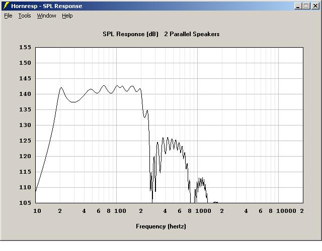

I'm not sure what the ID= means; everything else makes sense in context. Try the attached import and response curves to get you started. This isn't a "final design" as I haven't meticulously checked it over (plus I'm still a bit of an amateur at modeling tapped horns), but I believe it'll get you close. On the plot, the gray is single cab, the black is dual cab.
It does the requisite 140db at 20hz with two of those cabinets. Each cab is 1800 watts in. Note that it'd require EQing up the 30hz band, and the only way I can see to get 140db consistently without EQing anything up is to roll 3 cabinets, or, to hit the entire thing with a tuned circuit to electrically counteract the dip. But you mentioned you wanted to stay with a single 20a circuit - 3600w of output power can be had (barely) with 20a at 120v in, assuming 50% or less duty cycle in the program material - your dubstep doesn't consist of square waves, does it? 😛
It consists of Square Saw Sine, with a smattering of drums.
I could build an EQ for it, but I want the cab to be as flat as possible innately.
Sometimes I roll to a house with a bin on my roof last minute. One cab hitting 130s in a house would be perfect.
Sometimes I get the penske rental and can take everything.
I can carefully run 3.5 FTX 2001s off of a 20A circuit all night, 90% of the venues I go to I can rail on them split on 2 20a circuits.
No EQ - no problem. But you do understand that these things will require a variable high-pass filter, right? The only way I see you using these is with a DCX2496 with the highpass set to 17hz with a very steep slope. The only thing analog that'd cut it is a 24db/octave Linkwitz-Reily device which is continuously tunable in 1hz or half-hz steps. Does such a thing exist, anyone?
These puppies just beg for a Lab Gruppen, or something else that's 1-ohm stable. Your Ashlys aren't rated for 2 ohms, which tells me they'd have a hard time slewing that much current. You'd get the rated output at half the voltage and it'd sound nasty because the damping factor simply isn't there. I'll tell you what else you could roll that's economical and should be stable with that rig (although they don't tell you so in the spec sheet) - the Crown K2. Those amps are DC-coupled, so they've got usable response well below what you'd ever dump into the speakers (unless you roll the DCX2496). You'll find that amp selection for this application is tough, because many of them can't do power below 20hz (and you want the amp to be as wideband as possible since it's an analog device), but I think the K2 probably fits the bill while running bridged and input-limited upstream (again, another argument for the DCX2496).
