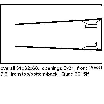

I am certainly not one to argue with the direction you want to go. However, I'll put out one thing I've found about 'uber-drivers.' They typically don't live up to their uber-rep, especially end of the night, when voice coil heating, and other factors are figured in. I have typically found that several cheaper drivers does better than one big expensive one. That is why my hornresp sim was for a quad of 3015lf's, not your chosen 5100neo. My sim was only 200watts into each driver, only 50% of the coils PE. If you'd like a good example of compression, look no further than lelands own T48's.. ProSpeakers Forum - Fitzmaurice Titan 48 - Wayne Parham, October 21, 2007 at 14:31:26
Just so you'd have an idea of what I proposed, here is a cartoon of it. I don't know if this fits your idea of correct size or not, but it would be easy to put wheels on it, and make it a one man job to move. Personally I would cut it in half and put strap handles on each side, so I could carry, not wheel.
anyway, good luck, and I look forward to seeing your hornresp sim so I know better what you are contemplating.

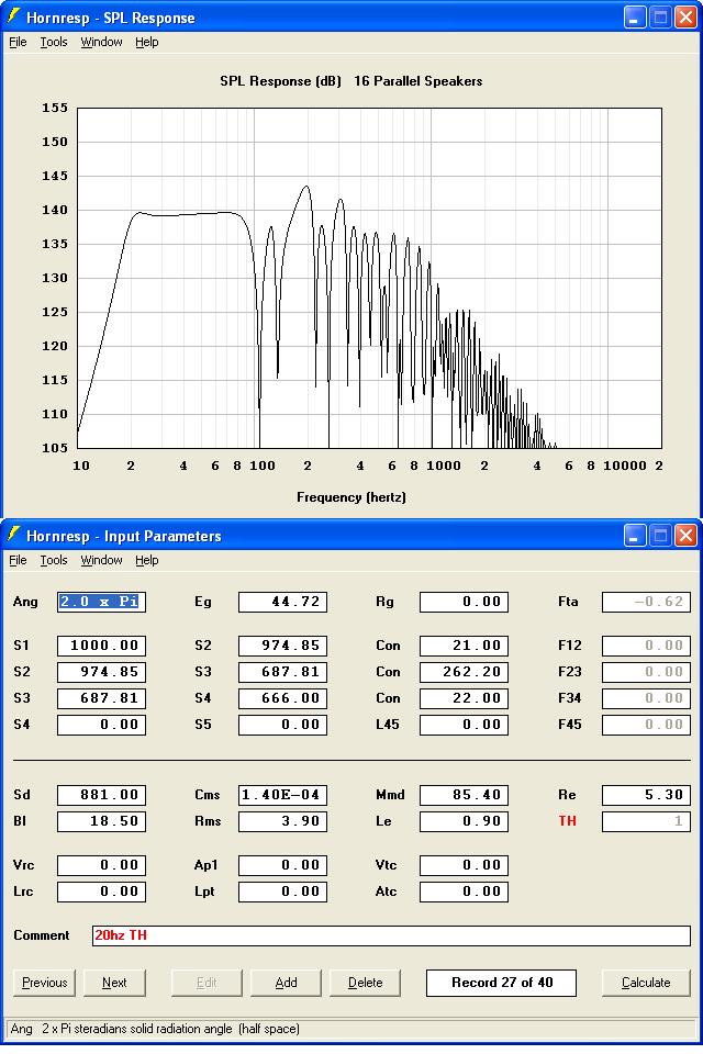

yea... once you get an idea...
I congratulate you on your drive, and persistence...
You break that quad 3015lf big box down into small 250 liter boxes -- you get a modular system that scales from house parties, to getting the cops called in from another city. The spl chart is 250watts per driver * 16. (still half price of 4 neo5100's)
sorry, I'm like you... I get an idea, and stick with it. Right now that prevailing thought for me is multiple small boxes. (I'm getting old, I think...)
Have fun, and post your results.
That sim you have there is for 16 drivers right? So 4 of the quad 15" boxes?
Awful damn flat.
And dividing the big horn into 4 smaller horns is a good idea for scalability.

jbell, you have realy confused me!
Your cartoon appears to show the horn throat becoming narrower towards the rear of the box. At the rear of the box it suddenly jumps to its widest. The horn path then becomes narrower as it approaches the mouth.
I am a complete TH newbie - I thought the horn starts smallest in teh mouth and becomes larger and larger in cross-sectional area until it reaches the mouth.
So I am really confused!
One path splits into 2 at the rear of the 'cartoon', and cross sectional area stays the same, and continues the negative flare from 4000cm2 to 2000cm2.
There is no exact rule on expansion flares for a TH, or many of it's variants.
An expanding flare gives more overall spl, and more higher freq output.
A reducing flare sacrifices spl and higher freq output, in favor of going lower.
You can have expanding and/or contracting flares, or even 'stepped sections' in a TH.
Wi wanted flat to 20hz, no matter what, and my hornresp sim gives that.
In order to get that, much spl potential above 20hz is sacrificed.

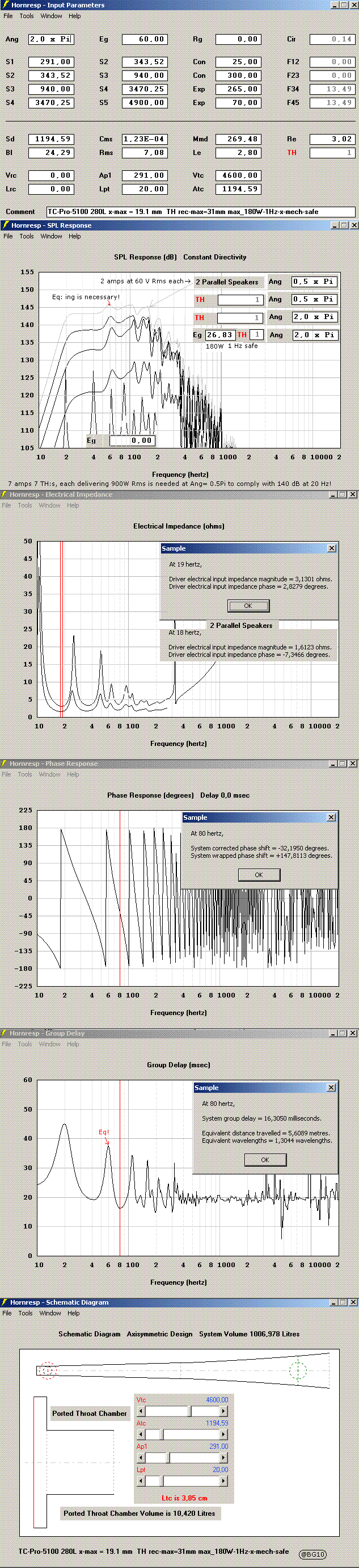

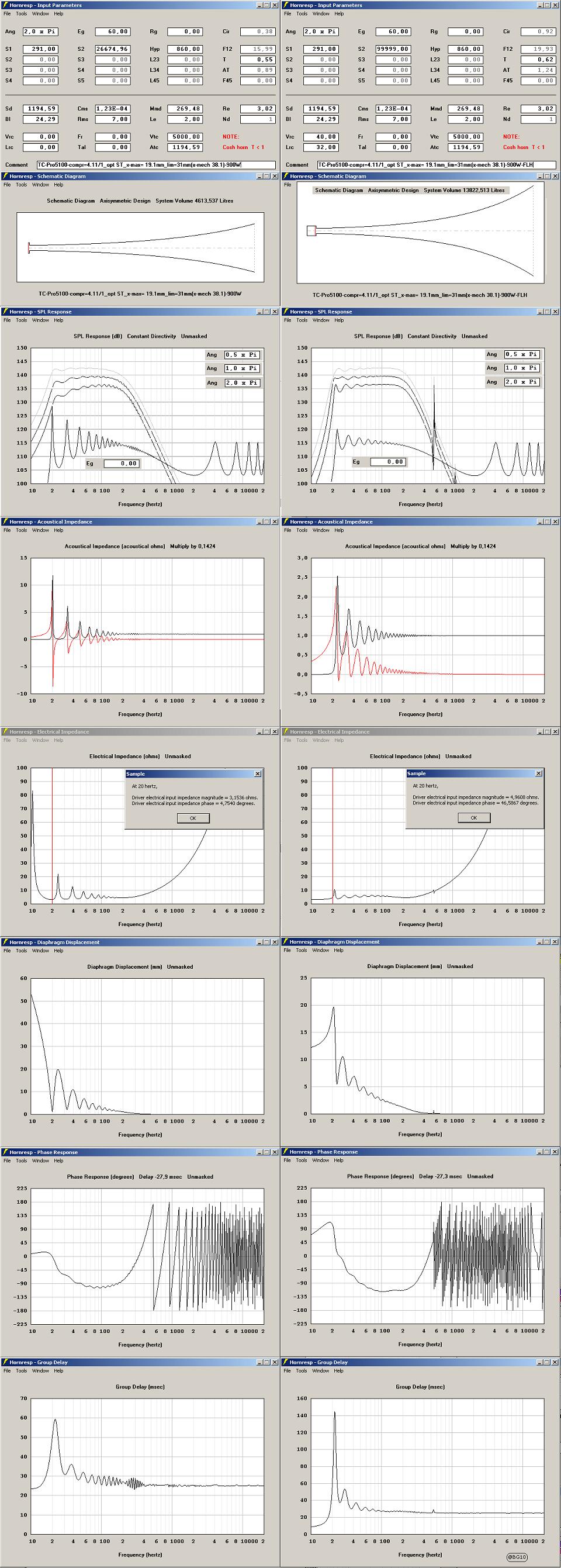

FYI and 2 cents of thoughts: While we all are waiting for a HR input screen data or similar trustworthy information of the suggested design:
Look at my simulations that I believe should work in order trying to comply with the requirement of 20 Hz horn loading..
b
