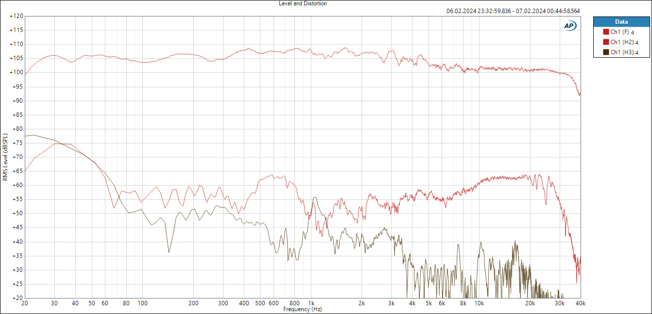

A 26mm dome cranking out 100 + dB (even in a WG) almost certainly won't be as clean sounding (apples to apples) as a larger mid dome or especially a smaller cone
All these points are easy to measure - with THD. And you can add some other measurement signals but unlinearities are not hard to capture.
I'm not going the "good enough" route in a design - the crossover point is not allowed to bring extra THD! Have a look, that's from the 2x12"/3"/1" at 108dBSpl. The Hypex module is already in protection mode for the tweeter above a few kHz (strict settings for this project) but at the crossover frequency there is not the slightest sign of additional distortions. I mean T25 tweeters burn down before they reach 1% THD in the 2-5kHz area ... these are WAY more clean as older designs. The 3" shows more THD in that area ...
But they won't do 105dBSpl at the listening position - that for sure. A 1" is not capable of that, esp. when crossed at 2kHz. Maybe at >3,5kHz cause music content goes down at higher frequencies but for these levels I would stay away from 1" at all. T34 or compression driver.
And 105dBSpl ... that's BRUTAL. I mixed my live shows with lower SPL. That's movie peak level - but with way higher compressed material and long duration.
People - get your (good) phone SPL app and have a measurement how loud you hear when cranking up. Then you have a design goal.

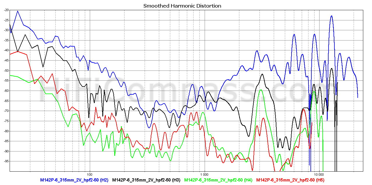

Getting back to the domes, how high can you cross Bliesma m142P?

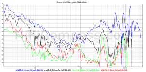

I can buy these domes trough friend with a good discount (OEM), but to quote hificompass: "Based on these measurements, I would recommend using the M142P-6 as the midrange of the highest quality loudspeakers in the 200Hz to 2kHz frequency range. "
There is break-up at 3-4k, so is this dome "passable" at all with dome tweeter when wanting to use 3k crosspoint?
Or maybe wavequide and big tweeter like T34-S or T35C002 at 2k?

@matsurus I have little experience with the M142P, only a few test sweeps and an uncalibrated HD measurement, which isn't that relevant due to lack of comparative reference. I can however say the engineering that went into this driver was of highest caliber. Its rare to see an odd combination of paper membrane with a motor of this magnitude.
Anyways, based on the brief experience, you would want to cross under 1.4k very steep. Its not a driver I'd deem suitable for common design, but more of a highly specialized application. A very good 16cm cone driver would be more suitable for this purpose IMO. The limitations of this compared to the big M142P would be thermal power handling, but a decent large VC equipped 6" driver would be more than adequate, plus it would be able to cross higher ie. SB 6MW150D. I've used these in several applications with excellent success. I've specifically chosen the T35C002 for use in the TW034 WG crossed about 2k 3rd order for studio monitor applications (this is where a lower than 3k cross would be appropriate). The other option is the newer Satori TW29TXNWG or Seas T29X001 in a WG would be a good fit. I suspect there are close similarities to the equally sized textreme dome models due to only one major supplier of the raw diaphragms, which get trimmed to fit specific drivers.

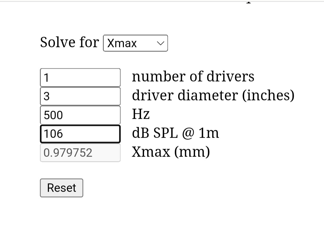

@Bill Brown When you consider the transition point of omni to directional for our hearing is about 300 hz, that's where the critical midrange starts. The upper limit on the sensitive range is 5k, where the Pina stops adding resonant gain. Above 5k we hear Iittle harmonic content, which is limited to just another octave above that when the audible band stops. So yes, 300 - 5k is about the touchy range that needs to be homogenous.
The starting range practical for good dynamic range and power handling on a 75mm mid dome is about 500 hz 2nd order. You'd then run it out to its upper limit which allows for a smooth transition to a smaller HF dome. I'd choose 3.5k due to the off axis dip being in the most advantageous place, which allows for a natural sounding transition to the tweeter. You can choose a lower point for this, but I'd stick to 3.5k. Its also a natural pivot point for crossover EQing and implementing an adjustable HF pad. There are big advantages to using one of these in reflective rooms and treble heavy source material. A shelf EQ pivoting around this for the HF allows for versatile speaker placement options. Thats honestly not that important for most people though, only if you need more flexibility without using a line level EQ.
For my design, I'm doing a HP to the M74A at 500 hz for the pair and shading one if these to flatten power response in the far field. One M74A would be enough if you don't need far field compensation for lower mids with a smaller baffle size.
The 3.5k turnover is also practical for the CTC spacing I chose. The flange from the T34B will be tucked under some of the flange of the M74As to line up acoustic centers properly. The mids have a set back VC, so that staggered placement scheme allows for a slightly tighter mid to HF spacing.
The 500 hz crossover was also chosen due to the woofer FR and off axis characteristics. The woofers have a fairly large dust cap which blends well with the mid domes in the off axis area. The Eminence Cannabass 10s play clean past 900 hz, so they're very suitable for crossing with the M74As at about 500 hz while still having enough overlapping response to blend using relatively shallow unsymmetrical filters. I don't want to go lower with the crossover because of power handling and excursion limitations. I prefer to have a good amount of headroom margine here. For typical music, the half power point for spectral power distribution is roughly 400 hz (unless its bass heavy dance music, rap, metal, etc).

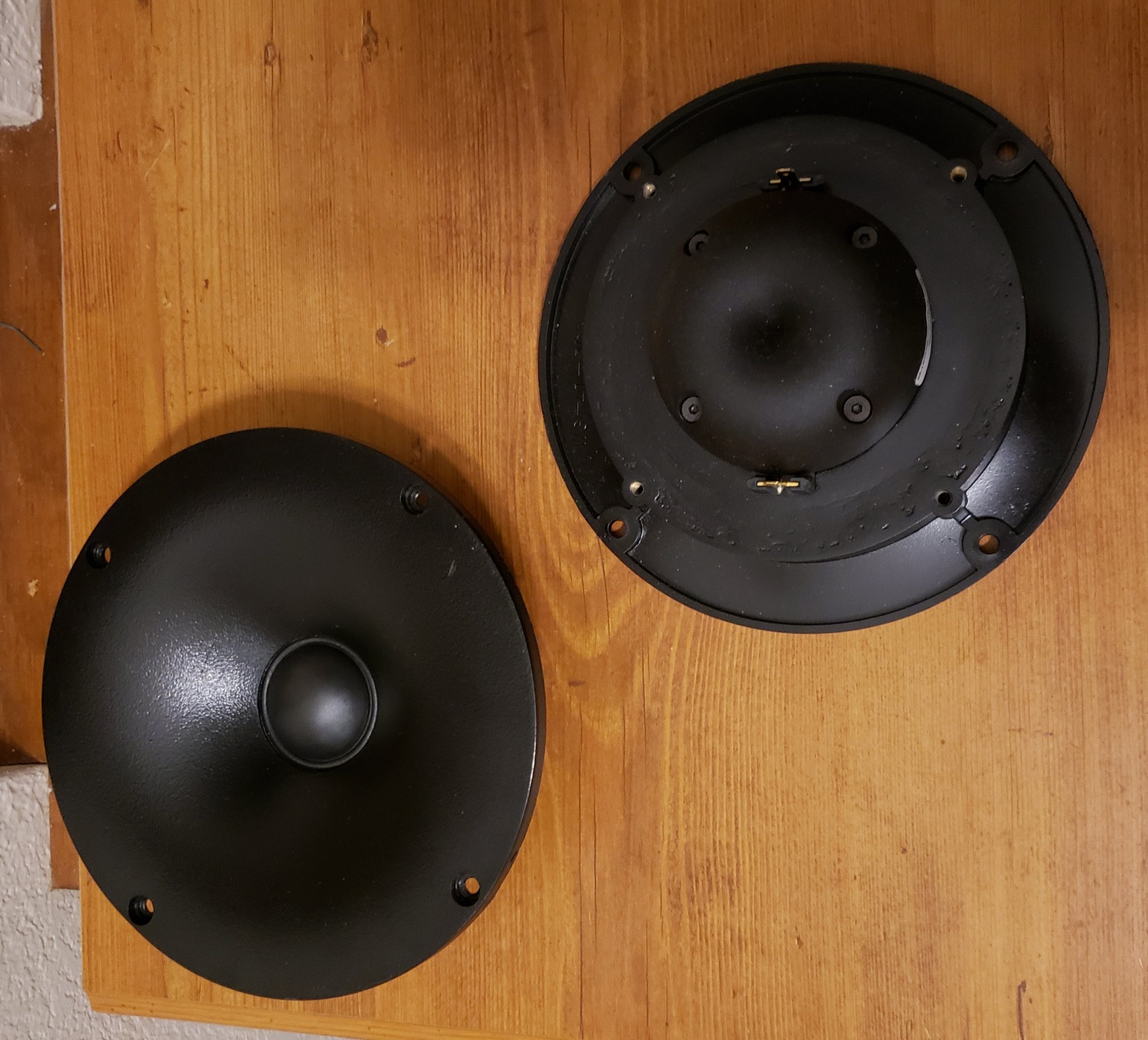

So to all Bliesma M74A/B/S owners, you may want to check your mids for a potentially loose front mounting ring. This also holds the front mesh grille in place.
I've discovered that all 4 of my M74As had loose front flange rings. This is due to the powder coating inside the screw holes having built up in the threads and causing the 4 allen screws under the mounting flange gasket to bottom out too soon. This will also affect the dome clamping the VC together and could potentially allow.the VC alignment to shift if not caught before using the driver.
The problem is powder coating buildup in the screw holes keeping the screws from fully clamping the ring which sandwiches the carrier plate with the dome asy.
The flange screws were all tight when I checked them, but they didn't clamp the two halves of the driver housing enough. I found this out by testing them on my Clio setup when I heard some buzzing during the test sweeps. Putting pressure on the front rings stopped the buzzing.
I suggest either running a bottoming tape (M3x0.5) through the threads but DO NOT use a standard thread cutting tap for this!!! It won't reach the entire thread depth and may make the problem worse. If you don't have a bottoming tap, you can use a small bore brush instead ie. for cleaning a smaller caliber (.22) firearm. Alternately, you can also use shorter stainless M3/0.5 screws ie. 4 - 5mm length, just as long as they don't protrude out past the flange surface.
The potential buzzing issue won't show up if you've already mounted the driver, because the mounting screws will have clamped the whole driver together when they've been fully tightened.
This is honestly a minor issue but I'm kind of perplexed Bliesma would let something like this slip past QC. I'm not certain the VC could shift due to this, but I wouldn't want to chance it, so its better to be sure.
This unfortunately isn't the first time I had issues with Bliesma. One of my T34Bs arrived with the back chamber flopping around loose in the box. That was sort of a fiasco, but I managed to fix it myself with the proper adhesive and clamping method. Stan offered to repair them free of charge if I sent them to Germany, but I decided to fix them myself due to shipping costs and potential downtime. It was honestly fault of the place that sold them to me, how they packaged and shipped them. Bliesma tests these drivers for the purpose of matching them up in pairs, so they would have caught it before the drivers were sent out.
It just goes to show you its important to check everything even if you're dealing with a higher end product. Nothing is immune from having problems. Its just annoying when it happens.
