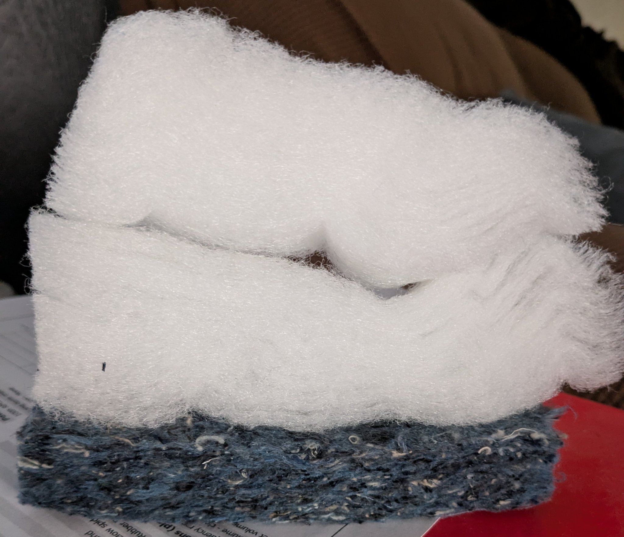

Regarding the D7608s, some of you are already finding out the complex dependency of rear chamber volume and lower mid performance. This is where the issues reside, as there is a strong correlation between chamber volume and lower mid HD/FR.
When comparing the wonky factory FR curve and corrected FR with any type of chamber between 350 - 750 ml, its apparent the D7608 was never intended to be used without some type of rear chamber. Adding to that is the felt on the motor structure, where things get even more weird. There is definitely some performance to be gained by optimizing this air flow restriction and the net chamber volume. The question is, how much snd what type of felt is needed for a given net chamber volume. The relationship I discovered is the felr should only be modified if the target lower mid HP is below 500 hz. Above this, the felt is pretty close to optimal for larger chamber volume. I'm honestly not sure what material they used for the rear felt, but it does appear to be some type of mix between synthetic and natural fibers.
So I have a .56 L rear chamber with the pictured damping material . The material at the back of the chamber is denim damping , then in front of that two layers of Dacron batting. This pretty much fills the chamber without packing the dacron batting down. Should this get me in the ballpark using a 700Hz 12db highpass ? I left the felt on the back of the motor as is.

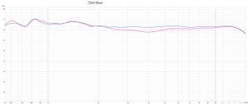

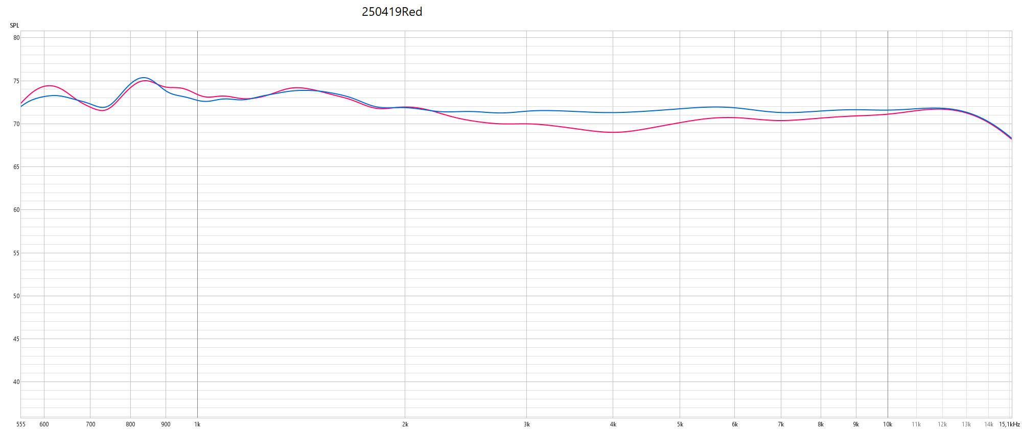

My preferred HF HP is actually 3.2 - 3.5k and having the horizontal off axis response dip slightly at that frequency. This allows fine tuning the speaker by angling it in or out towards the sweet spot. It reduces the 3.5k range off axis (preferably by a few dB), which sounds far better to the ears, especially at higher volume levels (aka Fletcher Munson or BBC dip).
Testing your recomedations a little on my latest diy (my 9 driver linesource)
Is it someting like this (RED curve) you mean ?
Reactions: matsurus
Found in the web, allegedly from an older version of the Harbeth website:
According to Harbeth's founder, who worked at the BBC during the time that this psychoacoustic effect was being explored, the primary benefit this little dip gave was in masking of defects in the early plastic cone drive units available in the 1960's. A spin-off benefit was that it appeared to move the sound stage backwards away from the studio manager who was sitting rather closer to the speakers in the cramped control room than he would ideally wish for. (See also Designer's Notebook Chapter 7). The depth of this depression was set by 'over-equalisation' in the crossover by about 3dB or so, which is an extreme amount for general home listening. We have never applied this selective dip but have taken care to carefully contour the response right across the frequency spectrum for a correctly balanced sound. Although as numbers, 1kHz and 4kHz sound almost adjacent in an audio spectrum of 20Hz to 20kHz, the way we perceive energy changes at 1kHz or 4kHz has a very different psychoacoustic effect: lifting the 1kHz region adds presence (this is used to good effect in the LS3/5a) to the sound, but the 4kHz region adds 'bite' - a cutting incisiveness which if over-done is very unpleasant and irritating. You can explore this effect for yourselves by routing your audio signal through a graphic equaliser and applying a mild cut in the approx. 1kHz to 4kHz region and a gradual return to flat either side of that.
Reference for the soundstage effect: https://de-m-wikipedia-org.translat...l=auto&_x_tr_tl=de&_x_tr_hl=de&_x_tr_pto=wapp
The "BBC-Dip" comprises a FR range of 1-4kHz and might be used for design compromises or even goals that sound "good".
So I have a .56 L rear chamber with the pictured damping material . The material at the back of the chamber is denim damping , then in front of that two layers of Dacron batting. This pretty much fills the chamber without packing the dacron batting down. Should this get me in the ballpark using a 700Hz 12db highpass ? I left the felt on the back of the motor as is. View attachment 1450537
You'll want to only use the denim material. Dacron is actually lousy at dampening lower mid frequencies and reduces volume in larger volumes. Its advisable to orient the material with fibers running from front to back and fill loosely. That should get you close.
