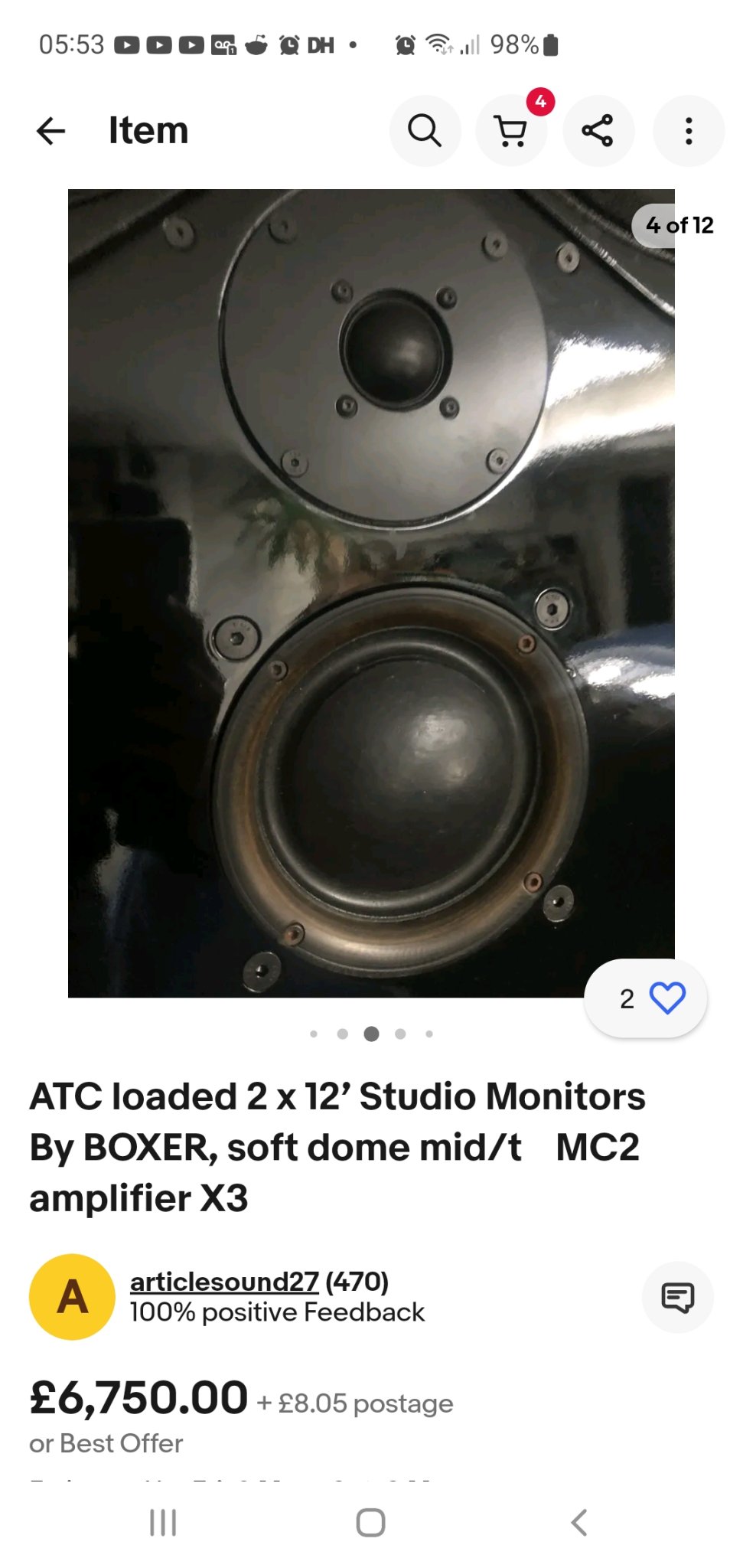

is this the 4inch atc dome mentioned earlier in the thread ? sorry I can't remember the posters name .this is taken from the listing of a boxer studio monitor stated as using atc drivers in the advert .
