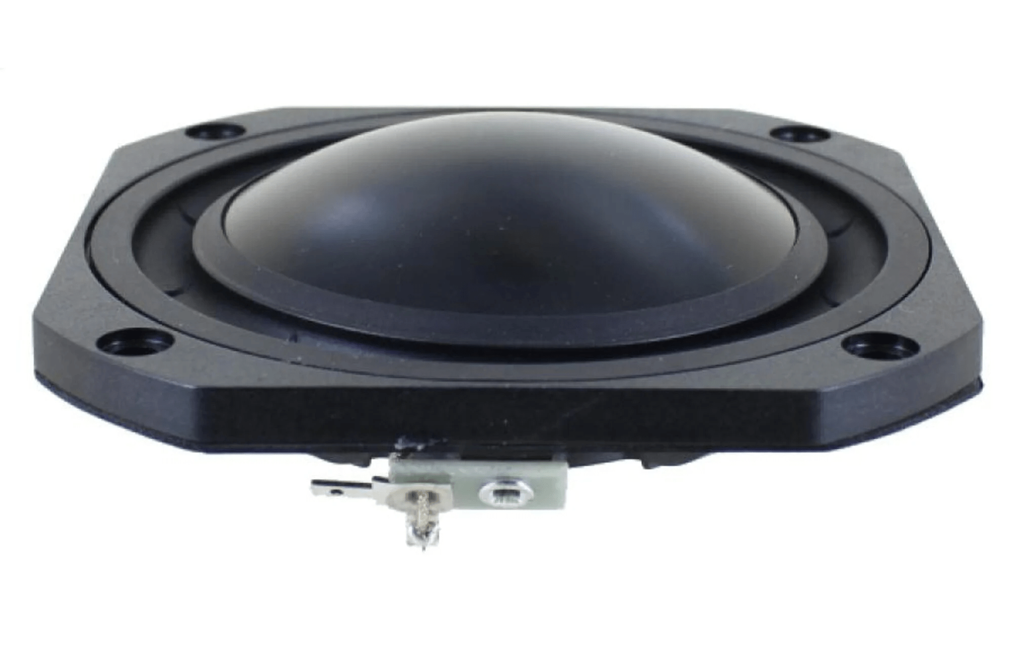

Sorry for the delay 🙂 - yes I think the quality is good, have bought 4 so far and no problems. And yes it seems to be a clone of the more expensive Dynaudio. I have read some comments on various forums that while Dynaudio is good, they are overpriced. I think these should be crossed to a sub at a steeper slope than the 12 dB I used though, as the xmax is a bit limited.I was also interested in this driver . hoe did you find the quality seems to be a massive bargain if the quality control is good . this is essentially a clone if the dynaudio 15w75 correct ?

DMN-A still on sale at PE, Soundimports and Solen but Audiophonics say discontinued and it disappeared from Swans website.

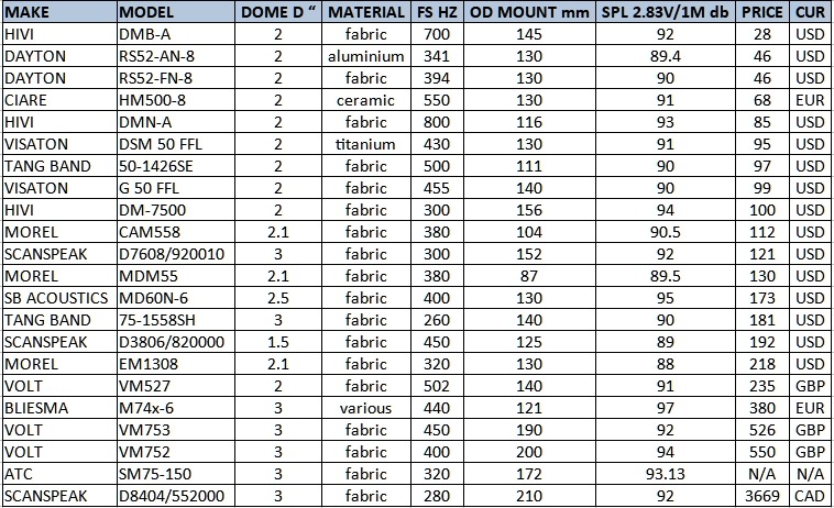

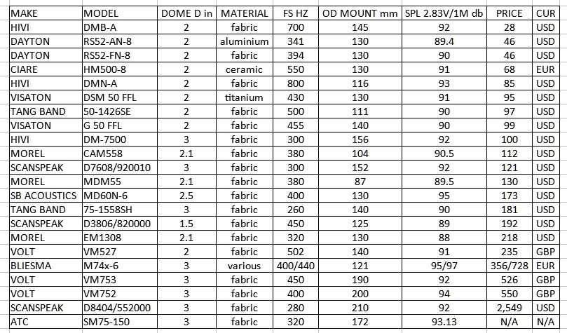

And shoot, I added the ridiculously priced Ellipticor, which has yet to be mentioned in the thread.

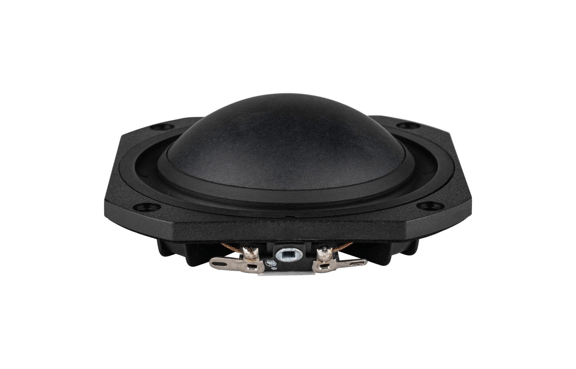

The biggest tweeter (above 800Hz) in history for close nearfield listening!(?)

If only the voice coil carrier would be updated with Kapton/Kapton MTB or , maybe better , Titanium foil!

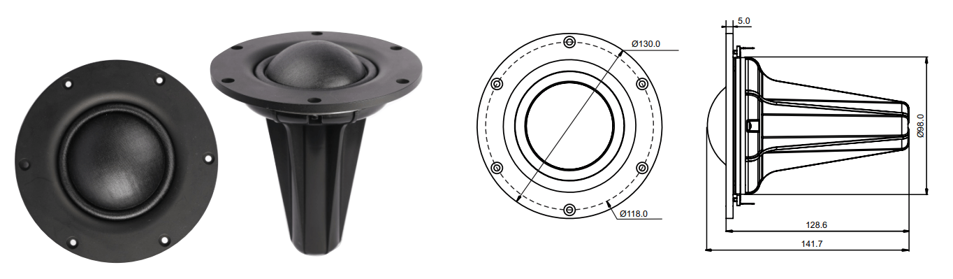

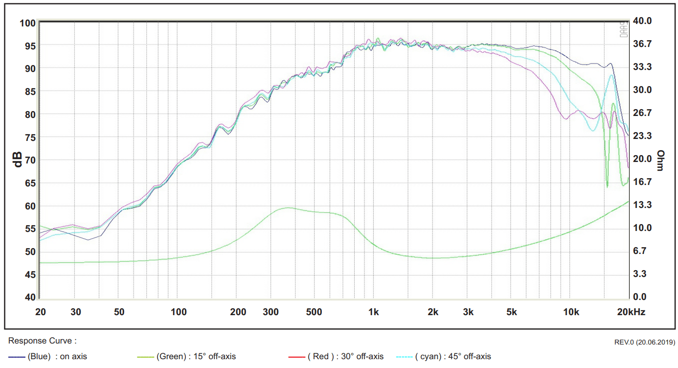

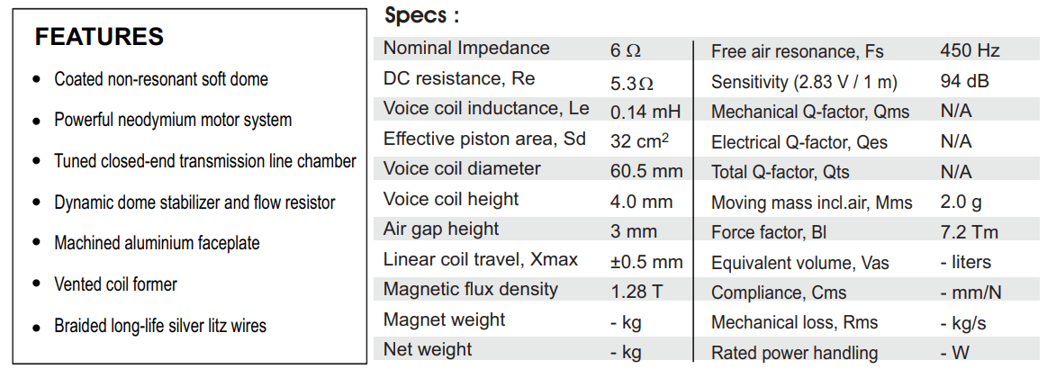

Still for my 4-way project, I also see the 2.5" dome midrange SBAcoustics Satori MD60N-6 :
https://www.toutlehautparleur.com/media/catalog/product/datasheet/sb_acoustics/SATORI_MD60N-6.pdf
It offers an interesting 95dB/w/m efficiency, with a FS=450Hz.
But I read (below) that it has a tuned closed-end transmission line chamber : do you understand like me that this speaker doesn't need any additional box or separation from the main volume of the enclosure ? 🤔
Any of you has an experience with this speaker ?

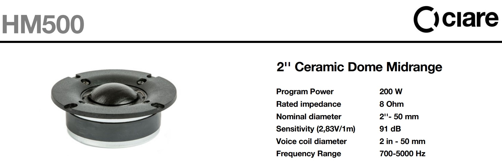

Btw - the info about the Ciare HM500 is not correct , it has a NOMEX carrier for the v.c. and a long wide winding of the coil! There is also a shielded HM600 version seems to be for automotive usage ... the only thing I miss is a 30mm pole vent like they have done in the olden times 🙂

In your chart you wrote CERAMIC for the Ciare dome midrange ... must be a glitch in your matrix 🙂
Better look at the dome what do you see? Ciare has NEVER EVER offered a ceramic dome! (even not a fake one)
