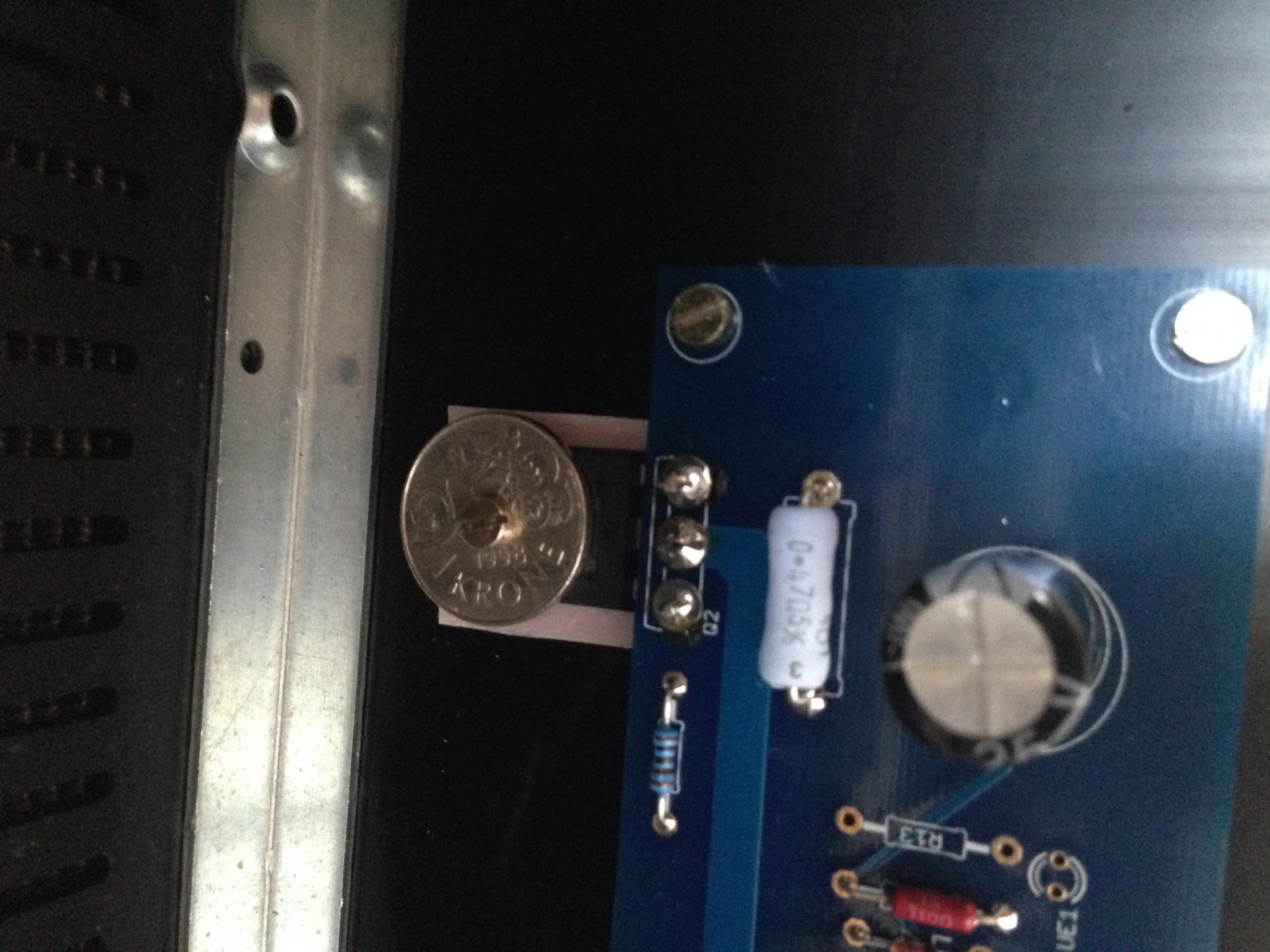

Anyway, I finished my F6 today. Compared to some of the other builds I've seen here it is not spectacular in any way, but I was quite happy to discover that one Norwegian Krone, the smallest coin in the Norwegian currency, works perfect at a washer to hold the FETs down. They are produced with a hole in the middle.
I've hooked it up to my rather large diy Voxativ transmission lines and they love each other! We had a few friends over already, Diana Krall dropped by to sing Besame Mucho, Lisa Ekdahl sung about a nature boy. Alfred Janson then came along with his accordeon and told us not to forget him (Ne me quitte pas). Eva Cassidy did an acoustic cover of wayfaring stranger, and there goose bumps all over the place! An amazing amplifier.
I took me quite a while to finish this project, and I own thanks to many people in this great forum. Hannes, Semisouthfan, Spencer. Super big thanks to 6L6 for the build guide, it was very useful. And of course Nelson Pass for sharing his knowledge 🙂
