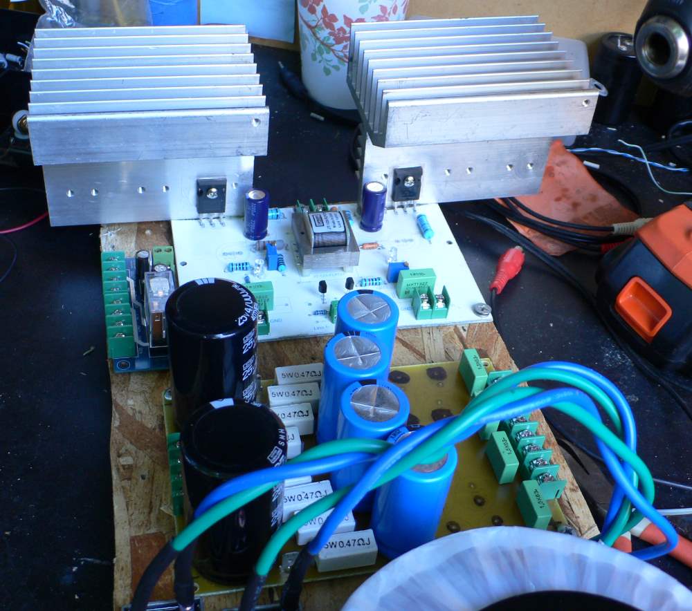

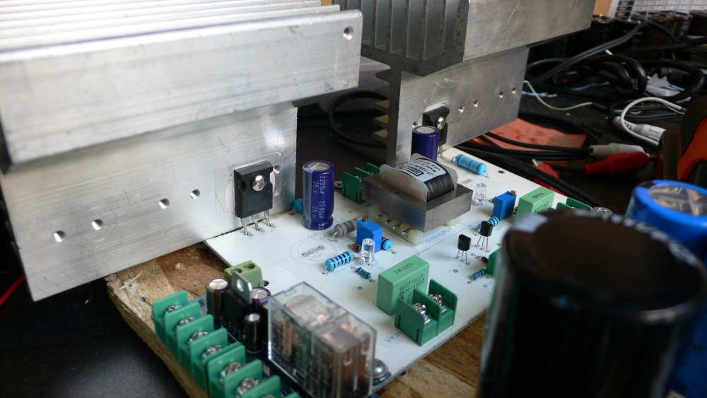

Do you guys think these heat-sinks will suffice?
I still haven't powered it up yet as I am waiting for a part but its pretty much completely assembled (just 1-ch; I need to verify that it even works before I populate another board.. 🙂)
I previously posted the eagle files for the main board however I somehow forgot to include the power supply cap bank. I doubt it will be of much use though, since it was specifically designed for the caps that I purchased but here it is anyways (along with an updated main board; there were some minor problems with part layout in the original.) Also, FYI I used 150mm x 100mm boards for both.

Good advice. Turn the heat sinks vertically and if necessary raise the board with standoffs. There are some spacers to be bought at Lowes that will work nicely.
Ya I'm definitely going to use spacers when I install it in an enclosure. I just have it randomly laid out on a piece of ply wood at the moment while I adjust the bias and generally make sure the board works. Of course I will continue to adjust it after it is installed but I need to wait until tomorrow before I try turning on. Waiting on one last part.. Hopefully. That piece of wood is actually kind of darkened from being cooked by other stuff so I may want to consider spacers even for the prototype 😀
When you guys say vertically do you mean with the fins running perpendicular to the board, or what? I may just end up using a fan if they're too hot. I have plenty of ambient noise anyways.. I think I might even have tinnitus.
Vertical fins mean they go up and down, so the convection currents flow upward unobstructed.
The bottom end of the fins should not be blocked either. With a fan you can have other orientations.
The best fan use is impingement cooling, blowing directly into the long edges of the fins.
